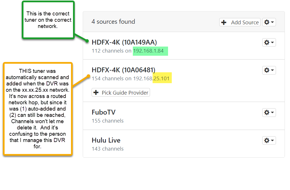

Here's an instance in which a tuner should NOT be auto-discovered again, but I can't remove it.
I understand what you're saying, and I've read it here several times.
  • This is a tuner that it should NOT re-add because it's not in the same network.
  • I can't just IGNORE the tuner because the person that I'm teaching to edit channels lists gets confused be see TWO tuners where there should be only ONE.
  • And, UNPLUGGING the tuner doesn't work because it's still in use on another network where it IS the correct tuner.

No, doesn't have an interface on that network. That network is still reachable, but that doesn't matter either. Since it was auto-added, not manually added via an IP address, there is no mechanism to remove it short of wiping it clean and starting over.
I have forced the old network to be unreachable, for what it's worth, and the above still applies.

As I said way up there earlier today, when it found the (later offensive) HDHomeRun, it WAS on the same network with that tuner. I believe it was autodiscovered. Then it was moved to another subnet with another HDHomeRun which it also discovered and added. But since it still had a record of the first one and could reach it over a routed network I couldn't find a way to get it to forget it.

curl -XDELETE http://ip-of-dvr:8189/devices?ip=192.168.25.101
If it wasn't manually added, remove it with
curl -XDELETE http://ip-of-dvr:8189/devices/<device_id>
In your case curl -XDELETE http://ip-of-dvr:8189/devices/10A06481
Then restart Channels DVR
