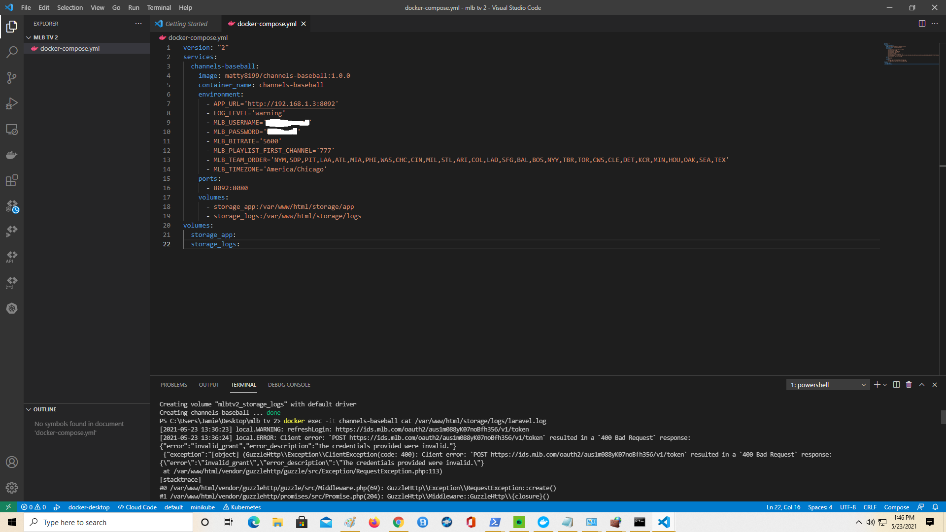

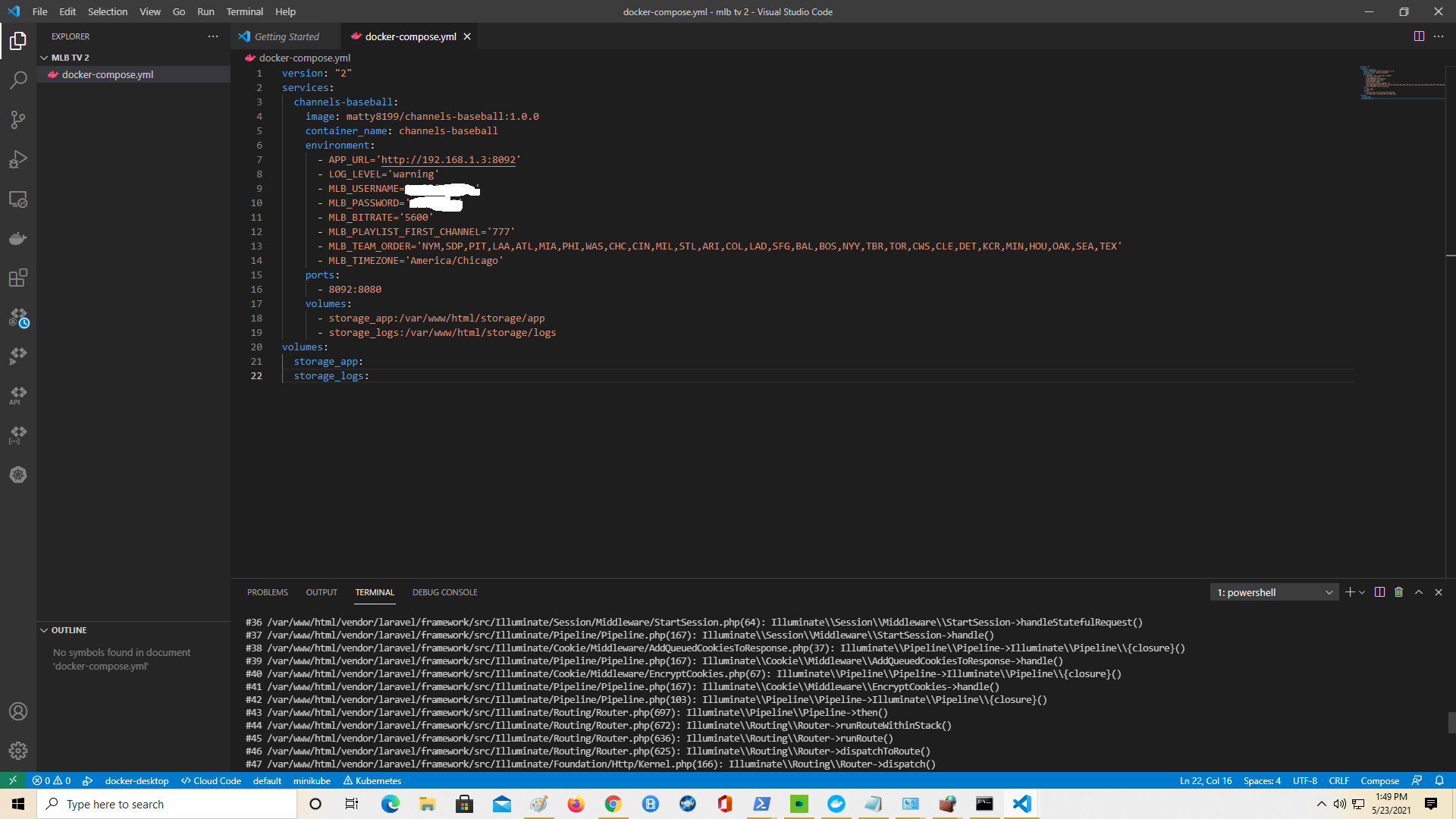

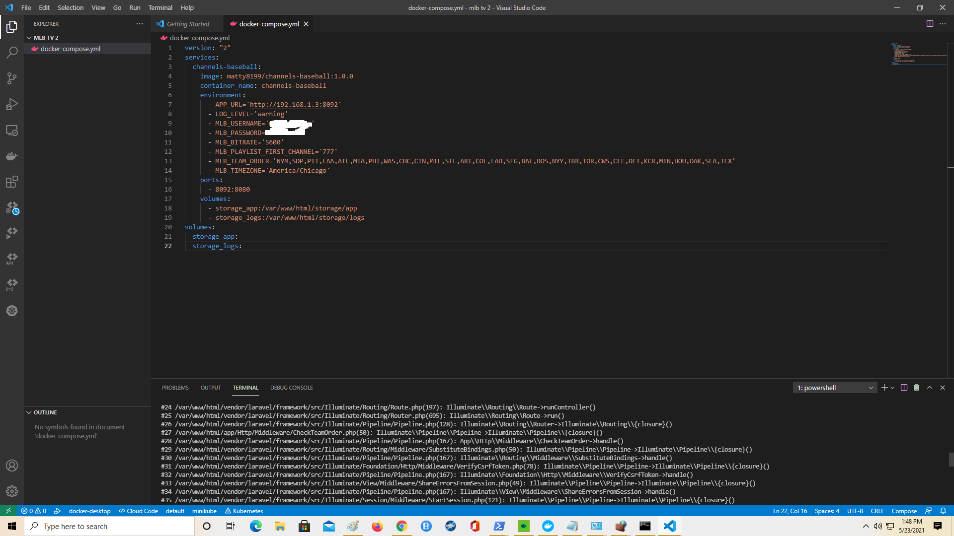

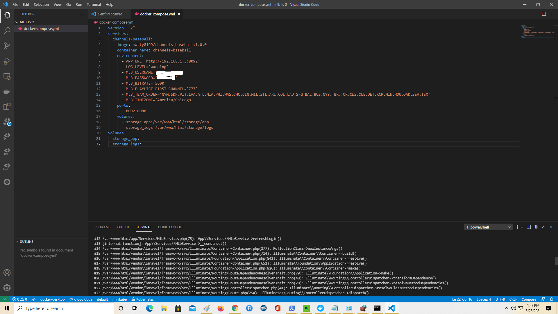

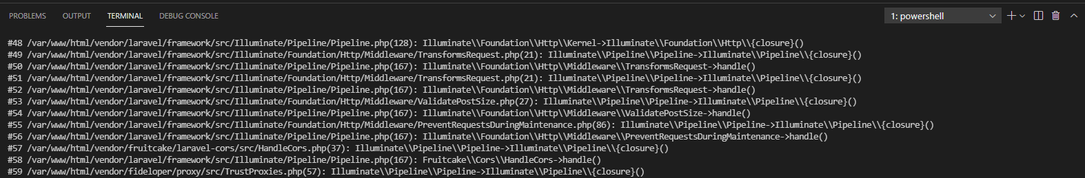

So question for you. I couldn't do what tgcon was suggesting with Windows Powershell but I did figure out how to open inbound and outbound port for 8092. I'm seeing more "activity" in the log section of Docker Desktop but no populated channel info...

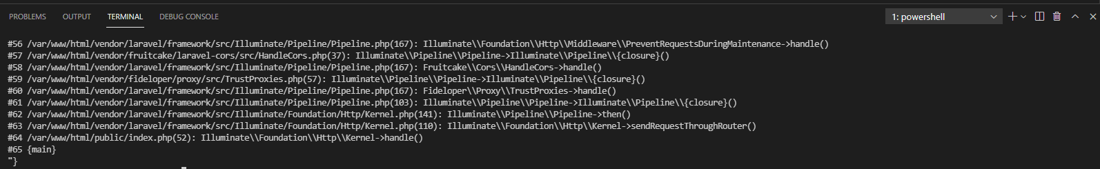

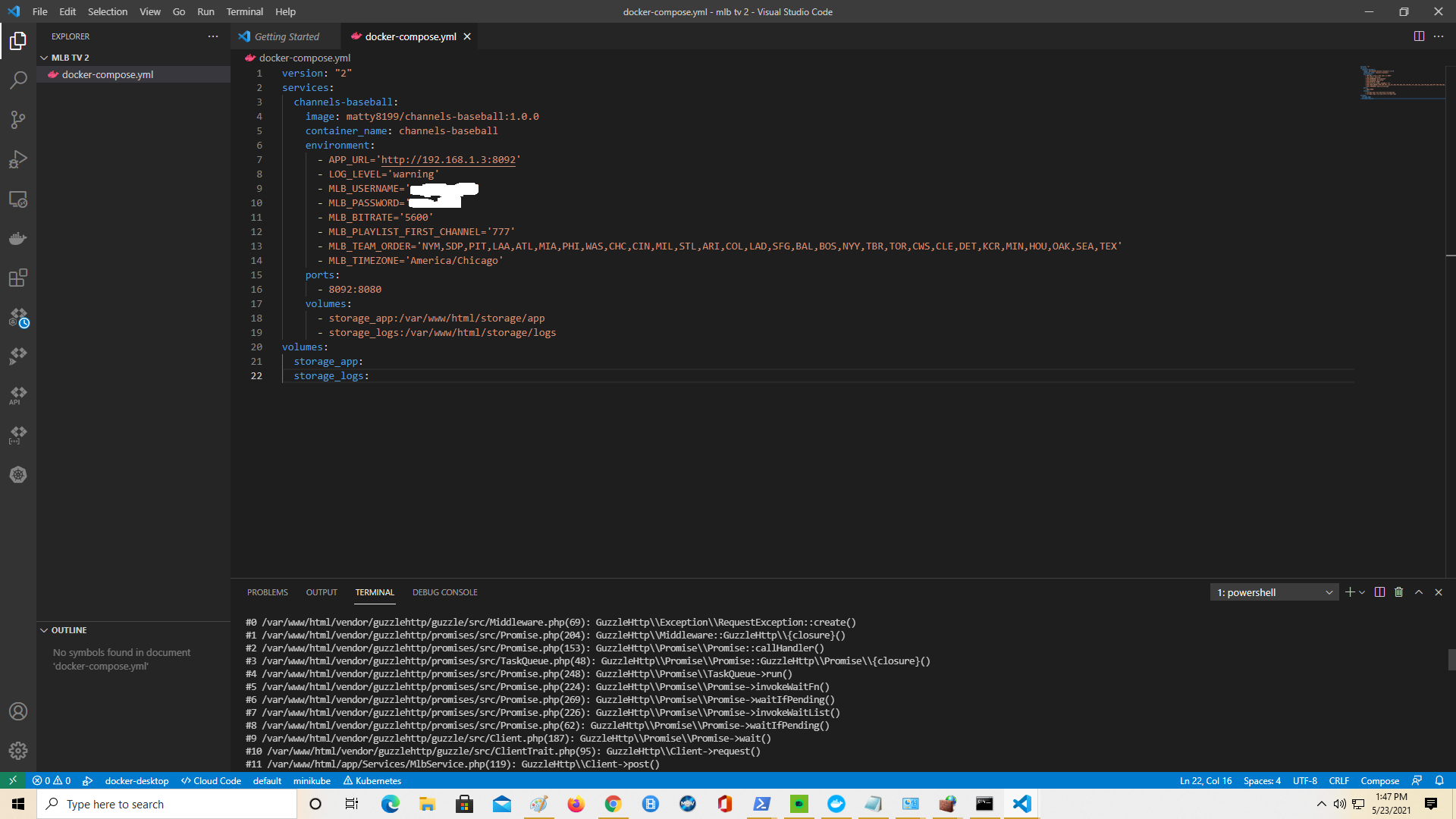

Here are new log files from this command: docker exec -it channels-baseball cat /var/www/html/storage/logs/laravel.log
your mlb credentials are invalid. it says it right in that first error msg.

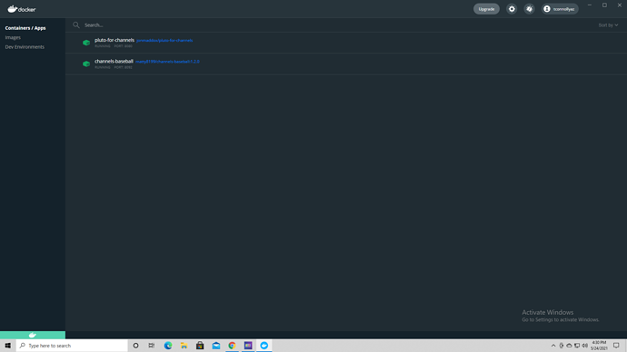

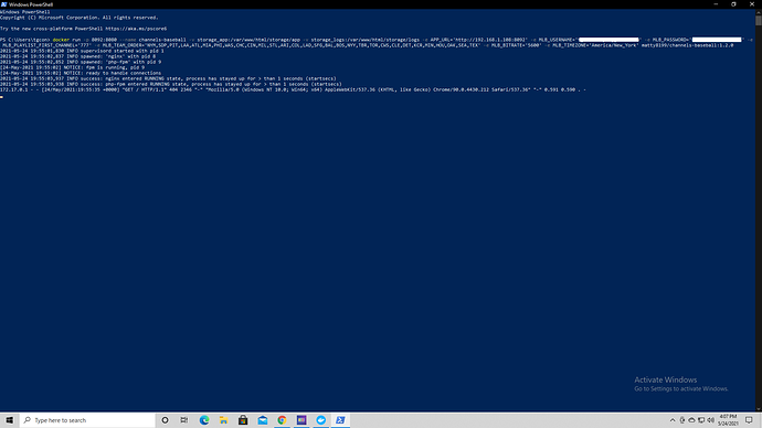

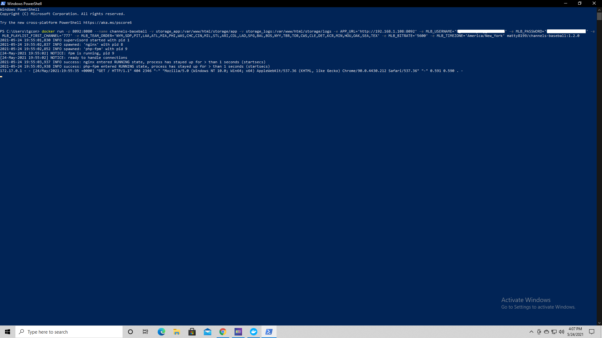

I've been following this thread and having issues as well. Windows install using Docker Desktop. The container is loaded and running but the m3u and epg files are not being created. Pluto is working fine on port 8080. I tried running MLB on port 8080 with the same result, the m3u and epg files were not created. Attached is a screenshot of the docker run command. At the end it shows the 404/file not found response when I used Docker to open the container in a browser. Any help is appreciated.
attempting to go to the root is going to show you the not found error because that page doesn't exist. there is nothing living at the root.
/epg and /m3u are the only two links that mean anything (there are other routes that the m3u will link to, but for the most part those are the only two you need to worry about). what does the log say if you try to navigate to /epg or /m3u?

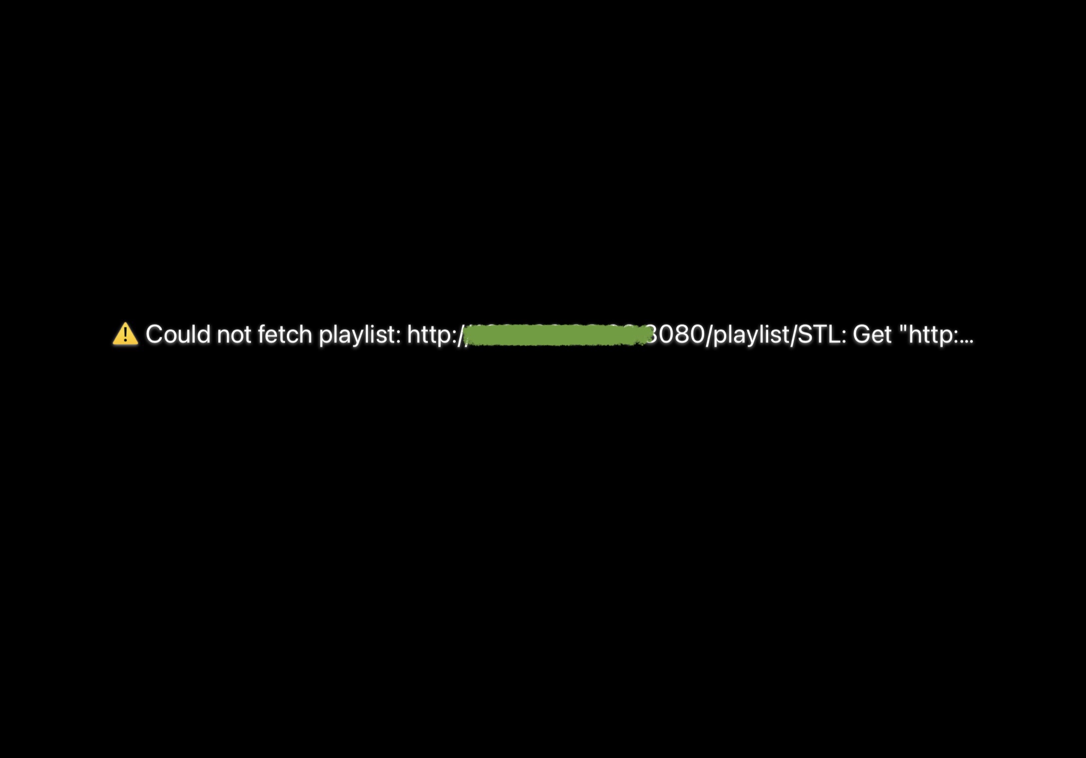

Running into some streaming issues on my dedicated 10th gen i3 mini box. I can get streams up and running per instructions, but I’m getting the following message popping up after about 7-10 minutes of a stream.
When I restart docker, things are fine and I can stream again.
Any thoughts as to why?
Any errors in the docker log? When this error appears are you still access the DVR web UI? If so, any errors in the log there?
