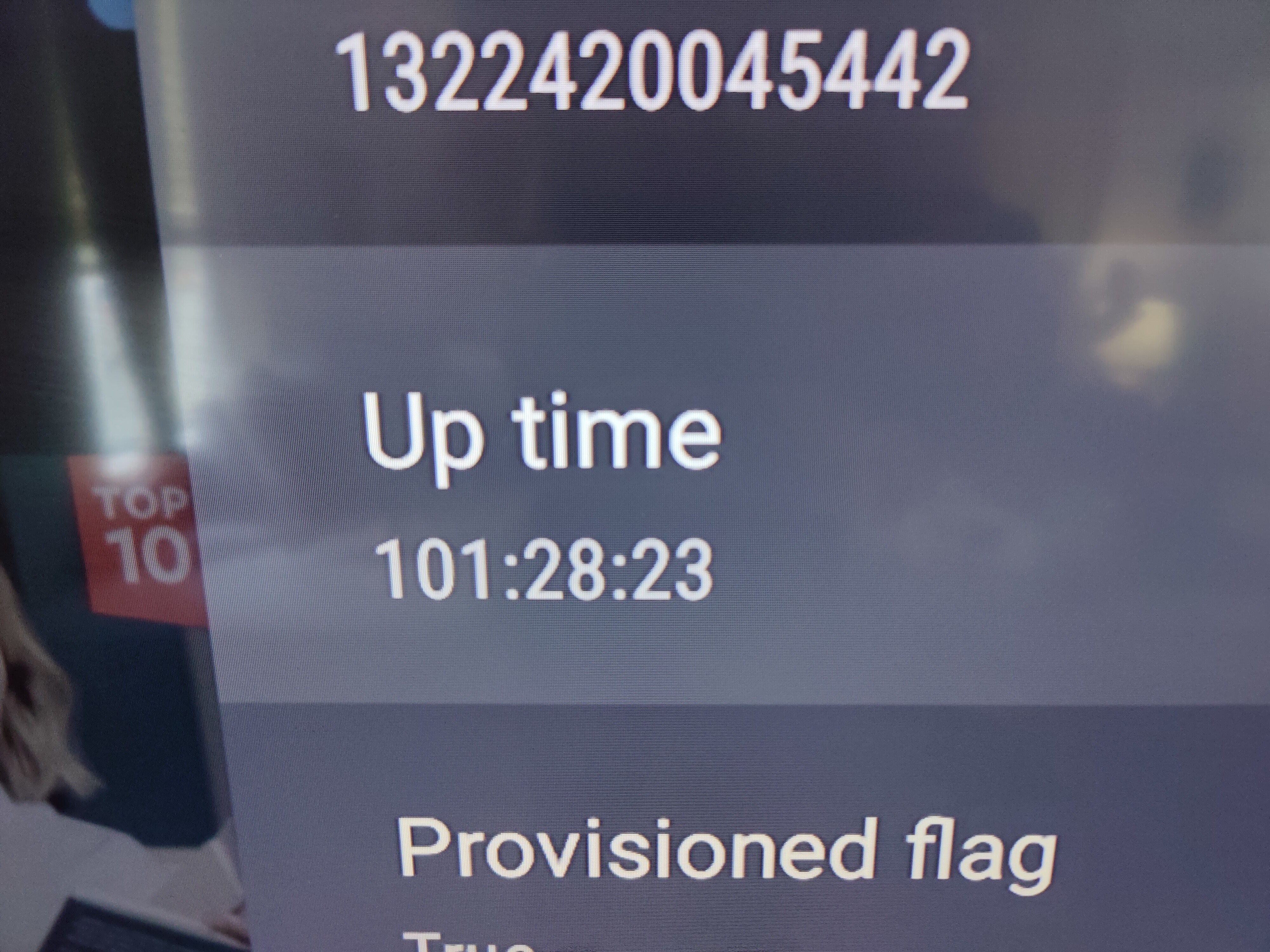

Strangely my test SHIELD has not crashed in over a week since I upgraded to hotfix3.
