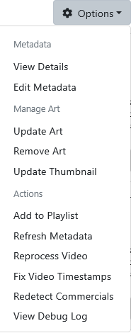

Reprocess video (rebuild the video index) doesn't help. Just tried it again to be sure.

Yah, since they started fingerprinting recordings they changed to API to
PUT /dvr/files/<file#>/fingerprint
Accessed by the Option Reprocess Video
Reprocess Video
It rebuilds the video index.
Incorrect. It does not rebuild it.
