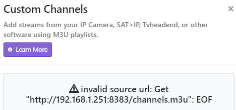

Unfortunately, the same error:
I think you meant that for him, not me.
And he should try http://192.168.1.251:8383/channels.m3u in a browser
When i try that (http://192.168.1.251:8383/channels.m3u) in a browser, I get nothing...
When I try that for one of my other working ones (stirr, samsung, pluto), I get:
Check the espn+ container log to see if it's running and any errors.
I am so embarrassed!! I checked the log and although I had logged into all of the sources already, it was requesting me to do it again. That is why it wasn't generating the m3u and xml. I deleted the docker image multiple times while I was trying to get it fixed and that likely meant I had to log in again. I can't thank you all enough for your help getting this working!
I think the NBC aspect of the container isn't working at the moment. The same FiOS credentials are working for ESPN and FOX.
Not sure this is your problem, but you need to fix your docker run command
-v config_dir:/app/config
to specify your config_dir
Thanks, that helps with organization and understanding of how docker works. However it does not fix the NBC issue. If it helps these are the errors I get when opening an NBC event stream in streamlink vs a FOX event with the same Verizon credentials.
I also was having issues with NBC sports this morning
same here, i get timeout awaiting response headers, then i get a 404 Not Found after the second try

2023-01-14 17:16:41 _options: {
2023-01-14 17:16:41 maxRedirects: 21,
2023-01-14 17:16:41 maxBodyLength: 10485760,
2023-01-14 17:16:41 protocol: 'https:',
2023-01-14 17:16:41 path: '/preplay/channel/1d20178a2987439a87ab078bf0aecc15.json?repl=aboi&cdn=ak&repl.cbcc=US&repl.cbdma=501&repl.cbzip=07424&expand=delay&ts=&rays=dfecb&ad=fw_prod&ad.flags=:slcb+sltp+qtcb+emcr+fbad+dtrd+vicb&ad.csid=fsapp%2Fandroidtv%2Flive%2Ffox&ad.prof=516429%3Auplynk_foxsports_androidtv_live&ad.kvsep=%7C&ad.kv=fnl-affiliate%7CWNYW%7Cfs-affiliate%7CWNYW%7C_fw_ae%7C725bd42fc9c9394e790b9a73610da431%7C_fw_us_privacy%7C%7C_fw_did_idfa%7C%7C_fw_did_google_advertising_id%7C%7C_fw_did_android_id%7C%7C_fw_did%7C%7C_fw_nielsen_app_id%7C%7C_fw_vcid2%7C%7Ckuid%7C%7C_fw_seg%7C%7C_fw_is_lat%7C0&is_lat=0&thumbsray=0&ad.metr=1031&ad.flex=1&ad.breakend=drop&v=2&ad.cping=1&ad.pingf=4&%7C_fw_is_lat%7C0&is_lat=0&thumbsray=0&tc=1&exp=1673734586&rn=477497&ct=c&cid=1d20178a2987439a87ab078bf0aecc15&hlsver=6&m4fenctype=cenc&sig=b35f8e30fd4345a0cb1975ad1f0dbecfa4dd3a44833752147281f516e514d804',
2023-01-14 17:16:41 method: 'GET',
2023-01-14 17:16:41 headers: [Object],
2023-01-14 17:16:41 agent: undefined,
2023-01-14 17:16:41 agents: [Object],
2023-01-14 17:16:41 auth: null,
2023-01-14 17:16:41 hostname: 'content-fox.uplynk.com',
2023-01-14 17:16:41 port: null,
2023-01-14 17:16:41 nativeProtocols: [Object],
2023-01-14 17:16:41 pathname: '/preplay/channel/1d20178a2987439a87ab078bf0aecc15.json',
2023-01-14 17:16:41 search: '?repl=aboi&cdn=ak&repl.cbcc=US&repl.cbdma=501&repl.cbzip=07424&expand=delay&ts=&rays=dfecb&ad=fw_prod&ad.flags=:slcb+sltp+qtcb+emcr+fbad+dtrd+vicb&ad.csid=fsapp%2Fandroidtv%2Flive%2Ffox&ad.prof=516429%3Auplynk_foxsports_androidtv_live&ad.kvsep=%7C&ad.kv=fnl-affiliate%7CWNYW%7Cfs-affiliate%7CWNYW%7C_fw_ae%7C725bd42fc9c9394e790b9a73610da431%7C_fw_us_privacy%7C%7C_fw_did_idfa%7C%7C_fw_did_google_advertising_id%7C%7C_fw_did_android_id%7C%7C_fw_did%7C%7C_fw_nielsen_app_id%7C%7C_fw_vcid2%7C%7Ckuid%7C%7C_fw_seg%7C%7C_fw_is_lat%7C0&is_lat=0&thumbsray=0&ad.metr=1031&ad.flex=1&ad.breakend=drop&v=2&ad.cping=1&ad.pingf=4&%7C_fw_is_lat%7C0&is_lat=0&thumbsray=0&tc=1&exp=1673734586&rn=477497&ct=c&cid=1d20178a2987439a87ab078bf0aecc15&hlsver=6&m4fenctype=cenc&sig=b35f8e30fd4345a0cb1975ad1f0dbecfa4dd3a44833752147281f516e514d804',
2023-01-14 17:16:41 slashes: true,
2023-01-14 17:16:41 host: 'content-fox.uplynk.com',
2023-01-14 17:16:41 hash: null,
2023-01-14 17:16:41 query: 'repl=aboi&cdn=ak&repl.cbcc=US&repl.cbdma=501&repl.cbzip=07424&expand=delay&ts=&rays=dfecb&ad=fw_prod&ad.flags=:slcb+sltp+qtcb+emcr+fbad+dtrd+vicb&ad.csid=fsapp%2Fandroidtv%2Flive%2Ffox&ad.prof=516429%3Auplynk_foxsports_androidtv_live&ad.kvsep=%7C&ad.kv=fnl-affiliate%7CWNYW%7Cfs-affiliate%7CWNYW%7C_fw_ae%7C725bd42fc9c9394e790b9a73610da431%7C_fw_us_privacy%7C%7C_fw_did_idfa%7C%7C_fw_did_google_advertising_id%7C%7C_fw_did_android_id%7C%7C_fw_did%7C%7C_fw_nielsen_app_id%7C%7C_fw_vcid2%7C%7Ckuid%7C%7C_fw_seg%7C%7C_fw_is_lat%7C0&is_lat=0&thumbsray=0&ad.metr=1031&ad.flex=1&ad.breakend=drop&v=2&ad.cping=1&ad.pingf=4&%7C_fw_is_lat%7C0&is_lat=0&thumbsray=0&tc=1&exp=1673734586&rn=477497&ct=c&cid=1d20178a2987439a87ab078bf0aecc15&hlsver=6&m4fenctype=cenc&sig=b35f8e30fd4345a0cb1975ad1f0dbecfa4dd3a44833752147281f516e514d804',
2023-01-14 17:16:41 href: 'https://content-fox.uplynk.com/preplay/channel/1d20178a2987439a87ab078bf0aecc15.json?repl=aboi&cdn=ak&repl.cbcc=US&repl.cbdma=501&repl.cbzip=07424&expand=delay&ts=&rays=dfecb&ad=fw_prod&ad.flags=:slcb+sltp+qtcb+emcr+fbad+dtrd+vicb&ad.csid=fsapp%2Fandroidtv%2Flive%2Ffox&ad.prof=516429%3Auplynk_foxsports_androidtv_live&ad.kvsep=%7C&ad.kv=fnl-affiliate%7CWNYW%7Cfs-affiliate%7CWNYW%7C_fw_ae%7C725bd42fc9c9394e790b9a73610da431%7C_fw_us_privacy%7C%7C_fw_did_idfa%7C%7C_fw_did_google_advertising_id%7C%7C_fw_did_android_id%7C%7C_fw_did%7C%7C_fw_nielsen_app_id%7C%7C_fw_vcid2%7C%7Ckuid%7C%7C_fw_seg%7C%7C_fw_is_lat%7C0&is_lat=0&thumbsray=0&ad.metr=1031&ad.flex=1&ad.breakend=drop&v=2&ad.cping=1&ad.pingf=4&%7C_fw_is_lat%7C0&is_lat=0&thumbsray=0&tc=1&exp=1673734586&rn=477497&ct=c&cid=1d20178a2987439a87ab078bf0aecc15&hlsver=6&m4fenctype=cenc&sig=b35f8e30fd4345a0cb1975ad1f0dbecfa4dd3a44833752147281f516e514d804'
2023-01-14 17:16:41 },
2023-01-14 17:16:41 _ended: true,
2023-01-14 17:16:41 _ending: true,
2023-01-14 17:16:41 _redirectCount: 1,
2023-01-14 17:16:41 _redirects: [],
2023-01-14 17:16:41 _requestBodyLength: 0,
2023-01-14 17:16:41 _requestBodyBuffers: [],
2023-01-14 17:16:41 _onNativeResponse: [Function (anonymous)],
2023-01-14 17:16:41 _currentRequest: ClientRequest {
2023-01-14 17:16:41 _events: [Object: null prototype],
2023-01-14 17:16:41 _eventsCount: 7,
2023-01-14 17:16:41 _maxListeners: undefined,
2023-01-14 17:16:41 outputData: [],
2023-01-14 17:16:41 outputSize: 0,
2023-01-14 17:16:41 writable: true,
2023-01-14 17:16:41 destroyed: false,
2023-01-14 17:16:41 _last: true,
2023-01-14 17:16:41 chunkedEncoding: false,
2023-01-14 17:16:41 shouldKeepAlive: false,
2023-01-14 17:16:41 maxRequestsOnConnectionReached: false,
2023-01-14 17:16:41 _defaultKeepAlive: true,
2023-01-14 17:16:41 useChunkedEncodingByDefault: false,
2023-01-14 17:16:41 sendDate: false,
2023-01-14 17:16:41 _removedConnection: false,
2023-01-14 17:16:41 _removedContLen: false,
2023-01-14 17:16:41 _removedTE: false,
2023-01-14 17:16:41 _contentLength: 0,
2023-01-14 17:16:41 _hasBody: true,
2023-01-14 17:16:41 _trailer: '',
2023-01-14 17:16:41 finished: true,
2023-01-14 17:16:41 _headerSent: true,
2023-01-14 17:16:41 _closed: false,
2023-01-14 17:16:41 socket: [TLSSocket],
2023-01-14 17:16:41 _header: 'GET /preplay/channel/1d20178a2987439a87ab078bf0aecc15.json?repl=aboi&cdn=ak&repl.cbcc=US&repl.cbdma=501&repl.cbzip=07424&expand=delay&ts=&rays=dfecb&ad=fw_prod&ad.flags=:slcb+sltp+qtcb+emcr+fbad+dtrd+vicb&ad.csid=fsapp%2Fandroidtv%2Flive%2Ffox&ad.prof=516429%3Auplynk_foxsports_androidtv_live&ad.kvsep=%7C&ad.kv=fnl-affiliate%7CWNYW%7Cfs-affiliate%7CWNYW%7C_fw_ae%7C725bd42fc9c9394e790b9a73610da431%7C_fw_us_privacy%7C%7C_fw_did_idfa%7C%7C_fw_did_google_advertising_id%7C%7C_fw_did_android_id%7C%7C_fw_did%7C%7C_fw_nielsen_app_id%7C%7C_fw_vcid2%7C%7Ckuid%7C%7C_fw_seg%7C%7C_fw_is_lat%7C0&is_lat=0&thumbsray=0&ad.metr=1031&ad.flex=1&ad.breakend=drop&v=2&ad.cping=1&ad.pingf=4&%7C_fw_is_lat%7C0&is_lat=0&thumbsray=0&tc=1&exp=1673734586&rn=477497&ct=c&cid=1d20178a2987439a87ab078bf0aecc15&hlsver=6&m4fenctype=cenc&sig=b35f8e30fd4345a0cb1975ad1f0dbecfa4dd3a44833752147281f516e514d804 HTTP/1.1\r\n' +
2023-01-14 17:16:41 'Accept: application/json, text/plain, */*\r\n' +
2023-01-14 17:16:41 'User-Agent: foxsports-androidtv/3.42.1 (Linux;Android 9.0.0;SHIELD Android TV) ExoPlayerLib/2.12.1\r\n' +
2023-01-14 17:16:41 'x-api-key: wefzlsJHalzbAjkO37fnZ7aUkwiqT030\r\n' +
2023-01-14 17:16:41 'Host: content-fox.uplynk.com\r\n' +
2023-01-14 17:16:41 'Connection: close\r\n' +
2023-01-14 17:16:41 '\r\n',
2023-01-14 17:16:41 _keepAliveTimeout: 0,
2023-01-14 17:16:41 _onPendingData: [Function: nop],
2023-01-14 17:16:41 agent: [Agent],
2023-01-14 17:16:41 socketPath: undefined,
2023-01-14 17:16:41 maxHeaderSize: undefined,
2023-01-14 17:16:41 insecureHTTPParser: undefined,
2023-01-14 17:16:41 _ended: false,
2023-01-14 17:16:41 res: null,
2023-01-14 17:16:41 aborted: false,
2023-01-14 17:16:41 timeoutCb: null,
2023-01-14 17:16:41 upgradeOrConnect: false,
2023-01-14 17:16:41 parser: null,
2023-01-14 17:16:41 maxHeadersCount: null,
2023-01-14 17:16:41 reusedSocket: false,
2023-01-14 17:16:41 _redirectable: [Circular *1],
2023-01-14 17:16:41 [Symbol(kCapture)]: false,
2023-01-14 17:16:41 [Symbol(kNeedDrain)]: false,
2023-01-14 17:16:41 [Symbol(corked)]: 0,
2023-01-14 17:16:41 [Symbol(kOutHeaders)]: [Object: null prototype],
2023-01-14 17:16:41 [Symbol(kUniqueHeaders)]: null
2023-01-14 17:16:41 _currentUrl: 'https://content-fox.uplynk.com/preplay/channel/1d20178a2987439a87ab078bf0aecc15.json?repl=aboi&cdn=ak&repl.cbcc=US&repl.cbdma=501&repl.cbzip=07424&expand=delay&ts=&rays=dfecb&ad=fw_prod&ad.flags=:slcb+sltp+qtcb+emcr+fbad+dtrd+vicb&ad.csid=fsapp%2Fandroidtv%2Flive%2Ffox&ad.prof=516429%3Auplynk_foxsports_androidtv_live&ad.kvsep=%7C&ad.kv=fnl-affiliate%7CWNYW%7Cfs-affiliate%7CWNYW%7C_fw_ae%7C725bd42fc9c9394e790b9a73610da431%7C_fw_us_privacy%7C%7C_fw_did_idfa%7C%7C_fw_did_google_advertising_id%7C%7C_fw_did_android_id%7C%7C_fw_did%7C%7C_fw_nielsen_app_id%7C%7C_fw_vcid2%7C%7Ckuid%7C%7C_fw_seg%7C%7C_fw_is_lat%7C0&is_lat=0&thumbsray=0&ad.metr=1031&ad.flex=1&ad.breakend=drop&v=2&ad.cping=1&ad.pingf=4&%7C_fw_is_lat%7C0&is_lat=0&thumbsray=0&tc=1&exp=1673734586&rn=477497&ct=c&cid=1d20178a2987439a87ab078bf0aecc15&hlsver=6&m4fenctype=cenc&sig=b35f8e30fd4345a0cb1975ad1f0dbecfa4dd3a44833752147281f516e514d804',
2023-01-14 17:16:41 _isRedirect: true,
2023-01-14 17:16:41 Could not get stream information!
2023-01-14 17:16:41 Failed to parse the stream
2023-01-14 17:16:41 Could not get a playlist for channel #6539. Please make sure there is an event scheduled and you have access to it.
