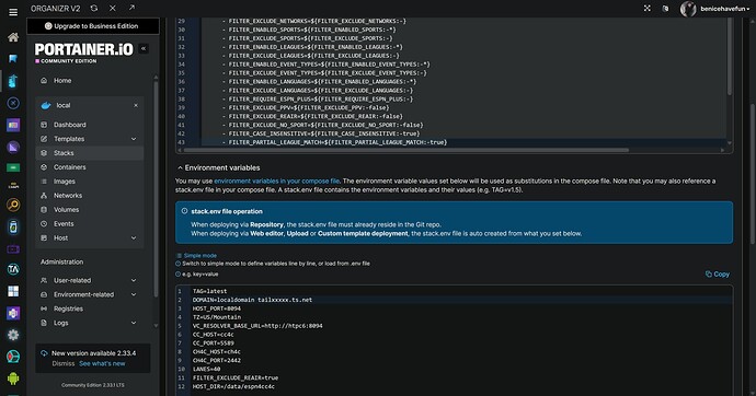

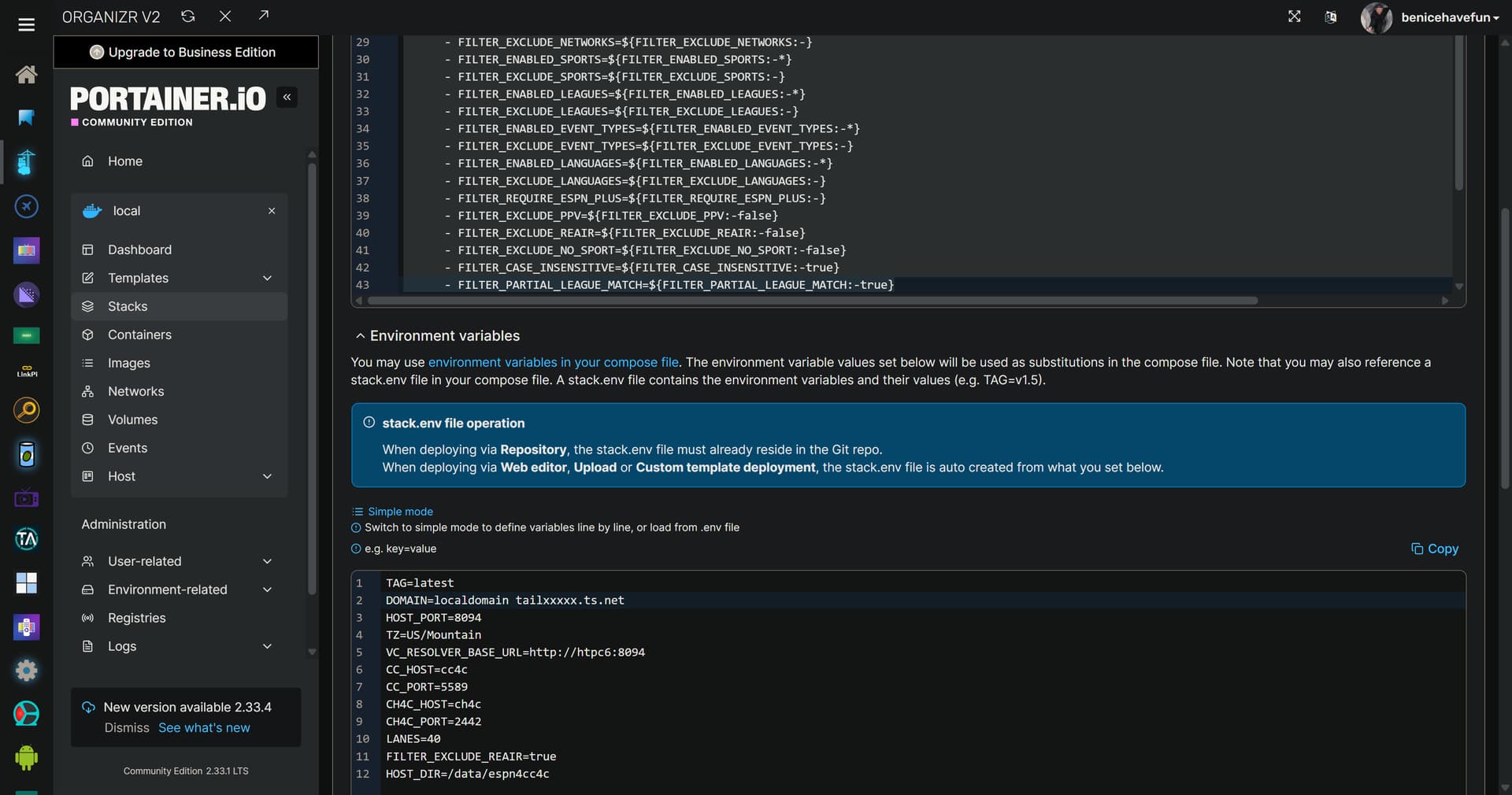

On Synology, I would think you'd either need to use Docker Volumes for each bind mount, or create the needed directories in advance under /volume1/docker.
You'd need:
/volume1/docker/espn4cc4c/data
/volume1/docker/espn4cc4c/out
/volume1/docker/espn4cc4c/logs
And then set:
HOST_DIR=/volume1/docker/espn4cc4c
Thanks, added the folders and changed the Host_Dir to the following:
volumes:
- ${HOST_DIR:-.}/volume1/espn4cc4c/data:/app/data
- ${HOST_DIR:-.}/volume1/espn4cc4c/out:/app/out
- ${HOST_DIR:-.}/volume1/espn4cc4c/logs:/app/logs
But got this error:
Failed to deploy a stack: compose up operation failed: Error response from daemon: Bind mount failed: '/data/compose/44/volume1/espn4cc4c/data' does not exist
Should I have done that through an environmental variable section (didn't see that in the directions on the Github page).
EDIT - Tried using the environmental variable section and that worked, thanks.
volumes: - ${HOST_DIR:-.}/volume1/espn4cc4c/data:/app/data - ${HOST_DIR:-.}/volume1/espn4cc4c/out:/app/out - ${HOST_DIR:-.}/volume1/espn4cc4c/logs:/app/logs
Put the above section back the way it was. You'll want to set your env vars in the section of the Portainer-Stacks Editor designed for this purpose:

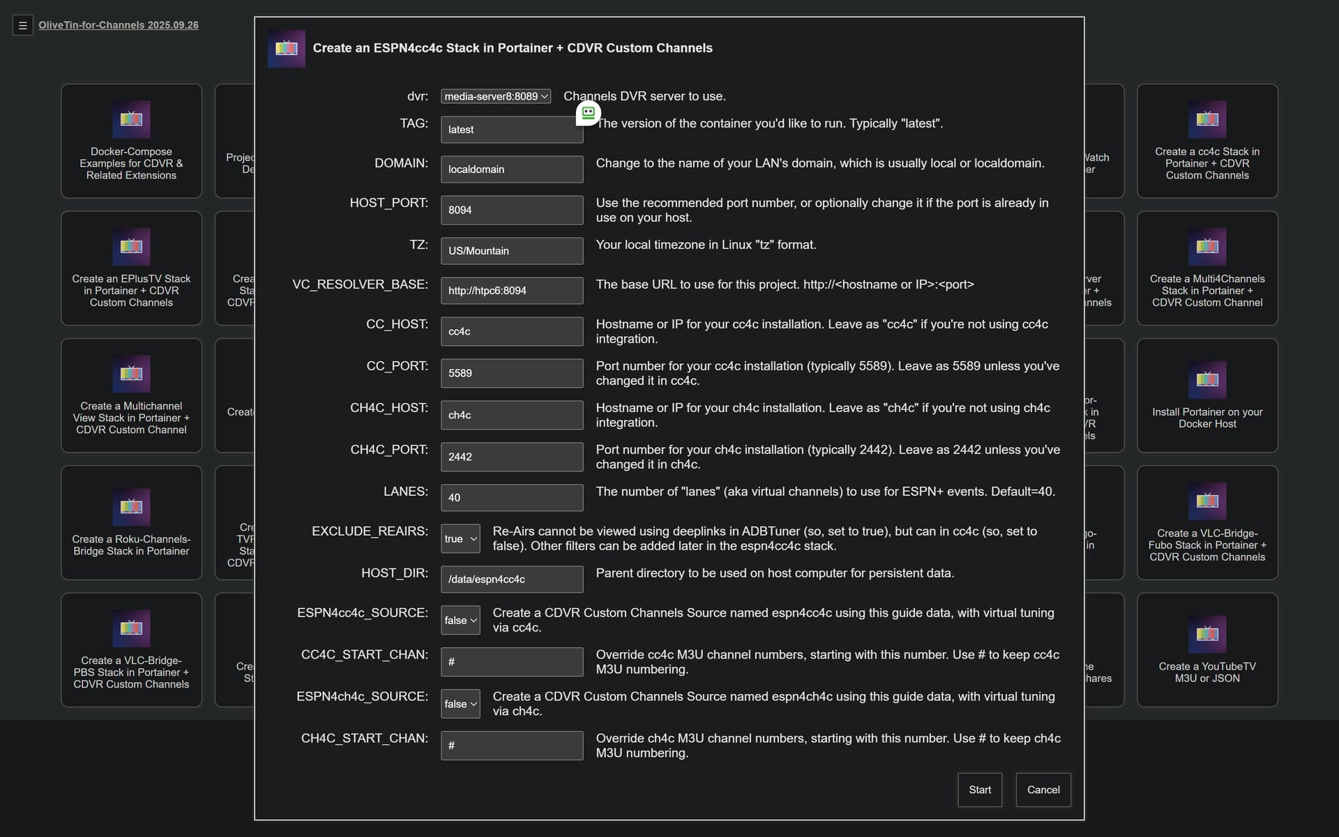

I'll ultimately be automating adding and deleting certain groups of channels into ADBTuner (now that there's an API), but it's not done yet. This will be available via OliveTin's Project One-Click.
New bnhf/olivetin:latest (aka bnhf/olivetin:2025.11.23) pushed today with support for both spinning-up an ESPN4cc4c stack, and also adding however many ADBTuner ESPN virtual channels (aka lanes) desired. Both cc4c and ch4c are supported, and can be run side-by-side.
The Action that creates x number of ESPN+ lanes in ADBTuner (which needs to match the number of lanes configured in the ESPN4cc4c stack), will also create an espn4adbt CDVR Custom Channels Source.
Plus, the Action will delete any pre-existing virtual channels with a provider name of ESPN, if desired. And finally, it'll add the required ADBTuner Custom Configuration if one doesn't exist with its UUID.
The ESPN4cc4c One-Click (this needs to be run first, even if you're only going to use it with ADBTuner):
The ESPN4adbt One-Click (be sure you're using ADBTuner 20251114-2 or newer):

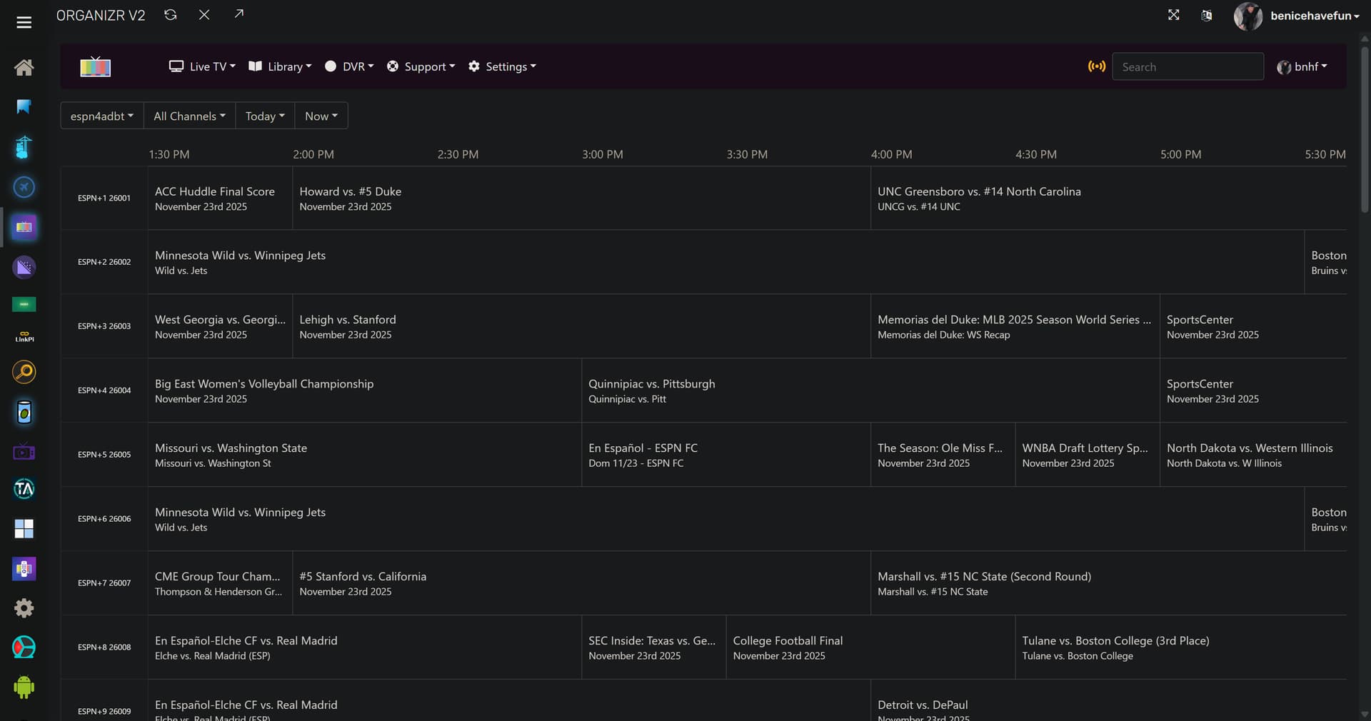

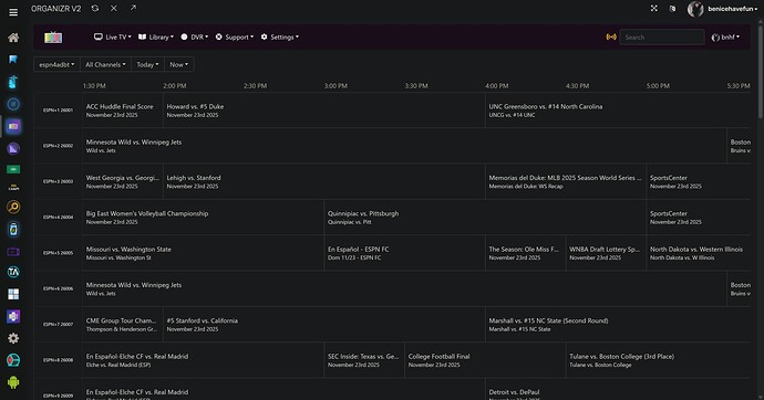

my issue now is the guide
I believe I have all guide-matching related issues sorted out in the latest Project One-Click for this hybrid project. Using the new ADBTuner API, the Action will automatically create as many virtual channels in ADBTuner as desired. It'll also delete any existing channels with a provider name of ESPN -- to clear the decks.
I have all three variations (using cc4c, ch4c or ADBTuner) running simultaneously, each using a custom channel number range:

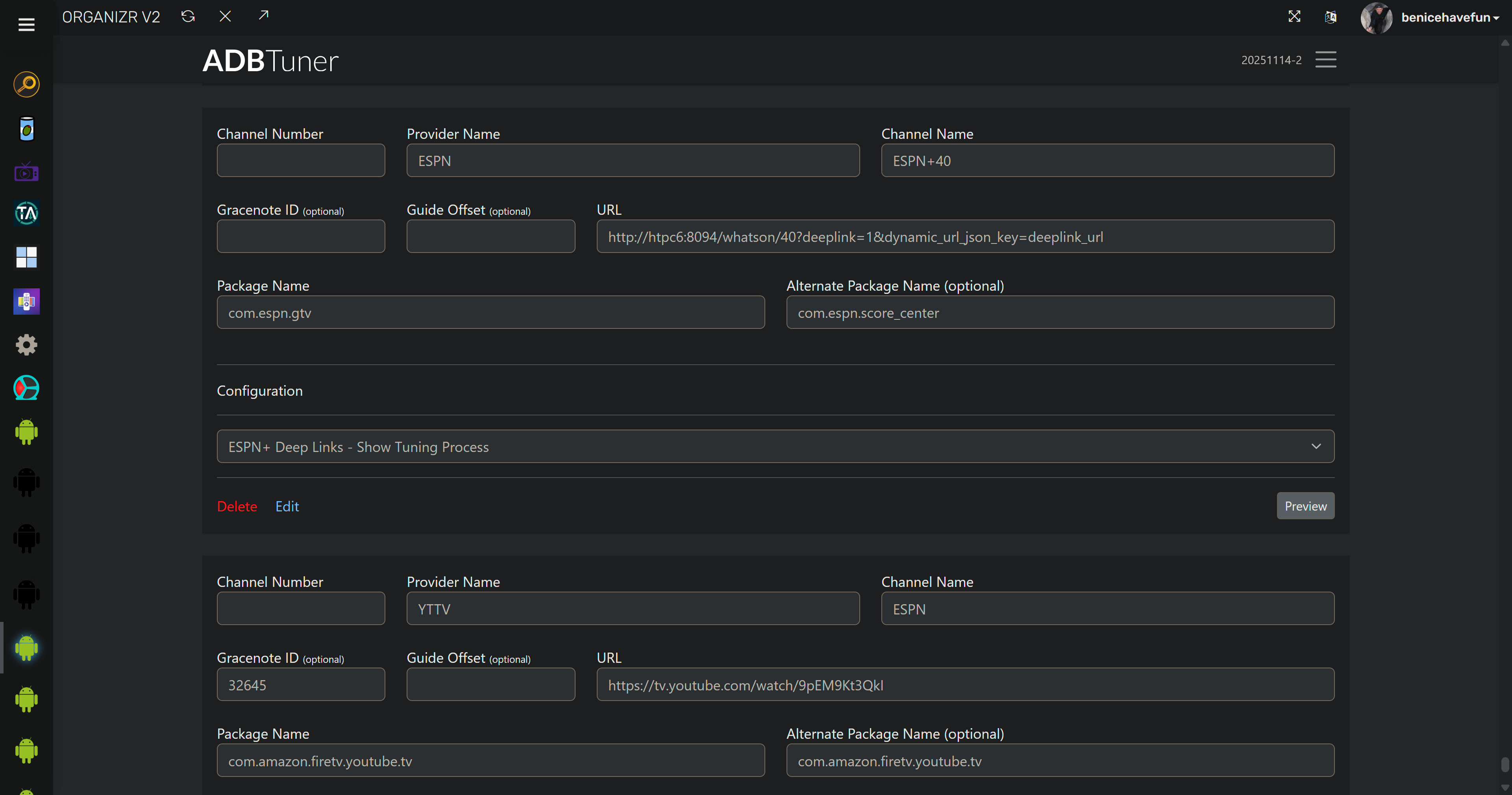

Automation comes to configuring ADBTuner for ESPN! New bnhf/olivetin:latest (aka bnhf/olivetin:2025.11.23) pushed with support for both the ESPN4cc4c project (ESPN guide data including ESPN+) and a Project One-Click Action to automatically create however many unique virtual channels you'd like for those events (40, 100, 250 or whatever). [screenshot-htpc6-2025_11_23-22_55_33] The One-Click will also add the ADBTuner Custom Configuration that goes with this (if its UUID is not already presen…

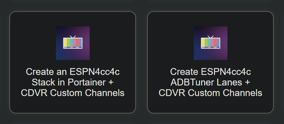

The One-Click Action is now building the channels for ADBTuner using your actual host:port or ip:port for ESPN4cc4c embedded in the custom channel's URL. I.E., host.docker.internal is no longer being used, since we don't need it to be one-size-fits-all -- and any number of channels is possible:
Did you run both Project One-Click Actions?
The second one fails because dvr:8094 isn't working, similar to earlier tries before that fix.

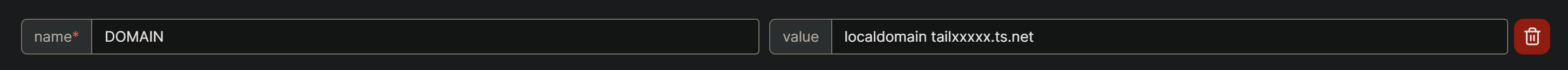

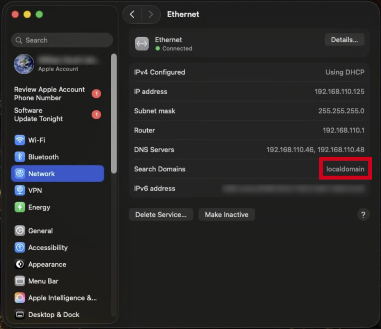

Are you expecting dvr to be resolved by your local DNS server, or are you using Tailscale's MagicDNS?
Pretty much either way, the search domains you specified in OliveTin need to be correct:
You can always use your Mac's IP if needed.
Note that localdomain is the correct search domain on my LAN, but yours could be local, lan or whatever your DNS server expects.

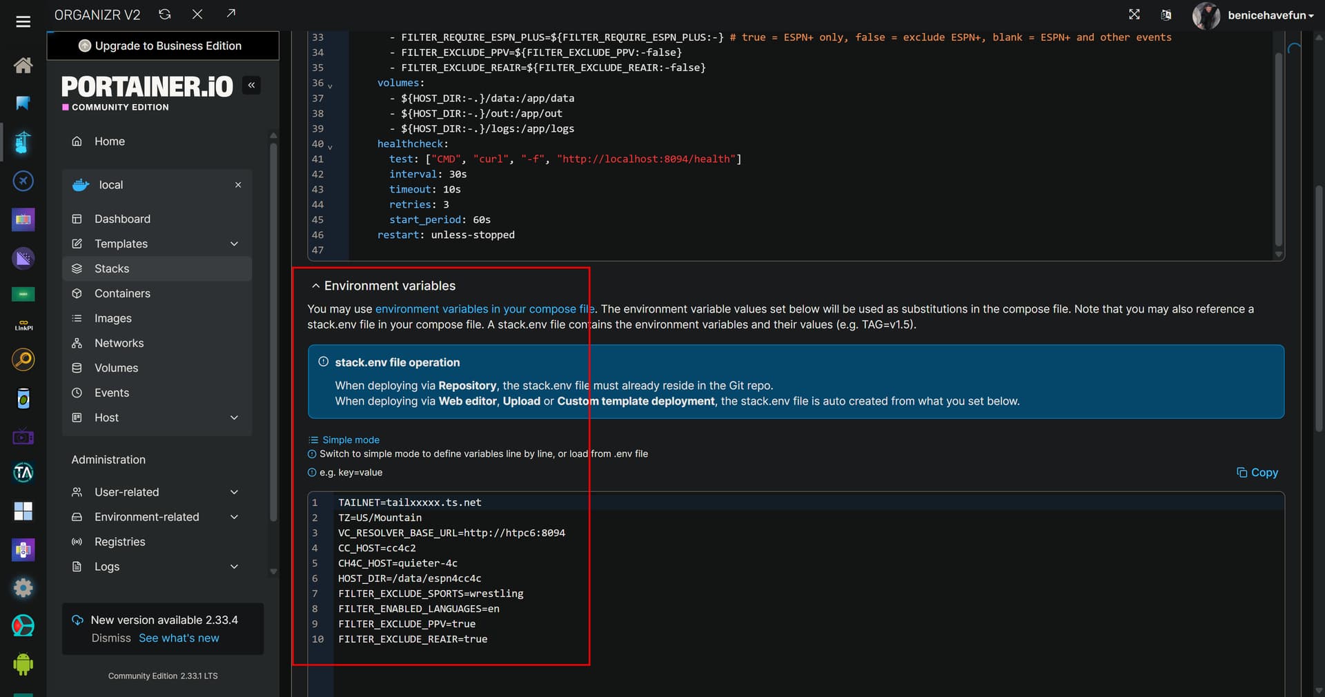

Could you add another copy block to /setupfilters that would be suitable for use in Portainer's Environment variables section of the Stacks-Editor?
Currently you're offering this:

That way, when the environment: section of the compose looks like this:
environment:
- TZ=${TZ:-America/New_York}

Those values, in that form, can just be pasted in as overrides here:
This way, one knows at a glance which values are not the defaults, and are specific to an individual installation.

localdomainis the correct search domain on my LAN, but yours could belocal,lanor whatever your DNS server expects.
What do you see here for your Search Domains value?:
local , which is what i also have in my env vars.
Are you expecting
dvrto be resolved by your local DNS server
It's def. resolving, else i wouldn't get that error message on browser when hitting it.
Exec into the olivetin container, and see what happens when you ping dvr...
Exec into the
olivetincontainer, and see what happens when you pingdvr...
Works fine (removed hostname)
