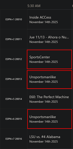

My current theory is that this has something to do with Re-Air events, but I won't be able to test that for some hours yet -- when the first live events start popping up.
@KineticMan
The above appears to be confirmed in the 5:30AM hour, as the events in red are labeled as Live in the app, and they are the only ones of the seven active that will actually tune. In the other cases, the events are labeled Re-Air, and will not tune using a deeplink.

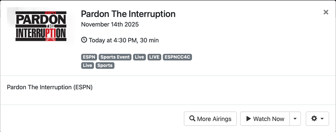

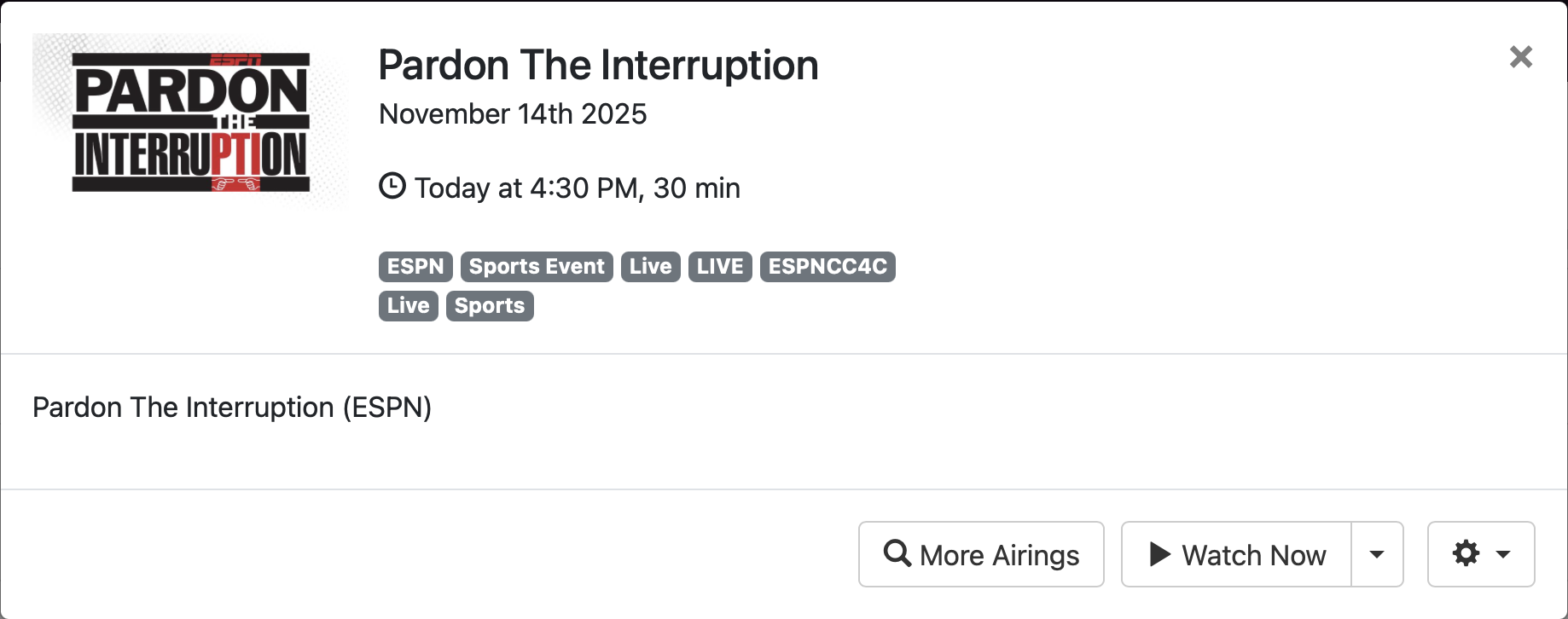

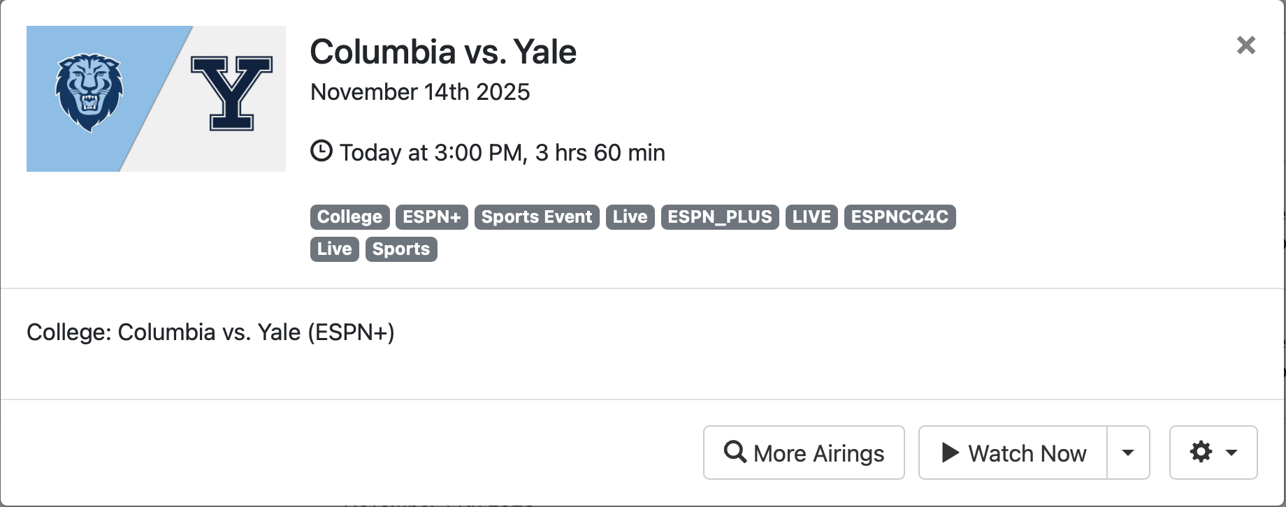

Looking at some of the events, the espn+ example has both ESPN+ and ESPN_PLUS tags. They all have three live tags: Live, LIVE, and live. The ESPN show Pardon the Interruption, should that be a "Sports Event" or is there a different tag for non-event shows?

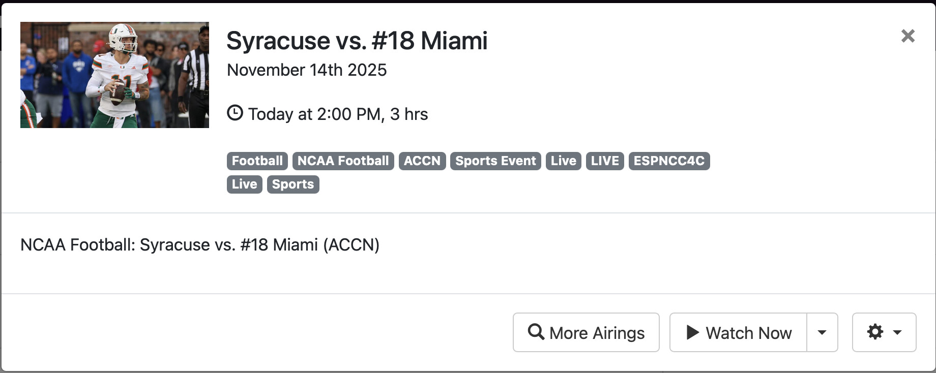

I haven't had any luck identifying a deeplink for Re-Air events, so it would be great if we could filter those out. However, those events appear to carry a Live tag. Is this something that could be addressed?
Bummer guys. I thought for sure one of those would work.
Yea I can improve on the tagging.
What would you define as “replay”? The APi scrape grabs a ton of info
