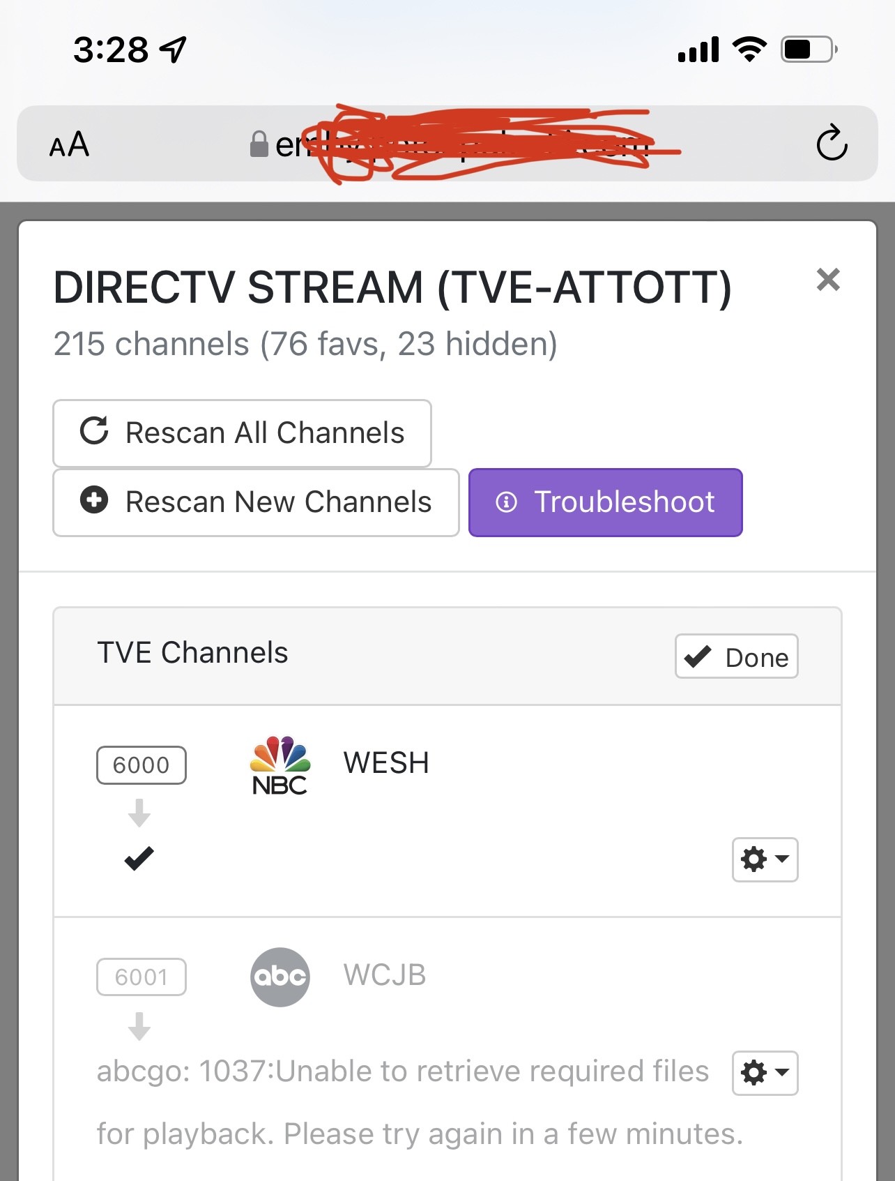

I'm seeing a previously discussed issue with my ABC feed. I can get it to play via the website and have tried some of the things I've foind here (incognito browser window, etc) Wenever I attempt to re-scan, it just keeps going back to this which is the same as it shows if I try to tune to it.
Is there anything else I can do? It DOES stream just fine from the abc website.
When I had trouble with CBS/ABC ... I accessed my server using HTTPS and then rescanned and it worked have you tried that.
Yes, both in a regular browser window and an incognito window (read that someplace here) - I can always get it to play in the abc website, but when I rescan, it just gives the same message from my screenshot. Added screenshot after I refreshed the channel again that way (secure lock shown in address bar to indicate https)

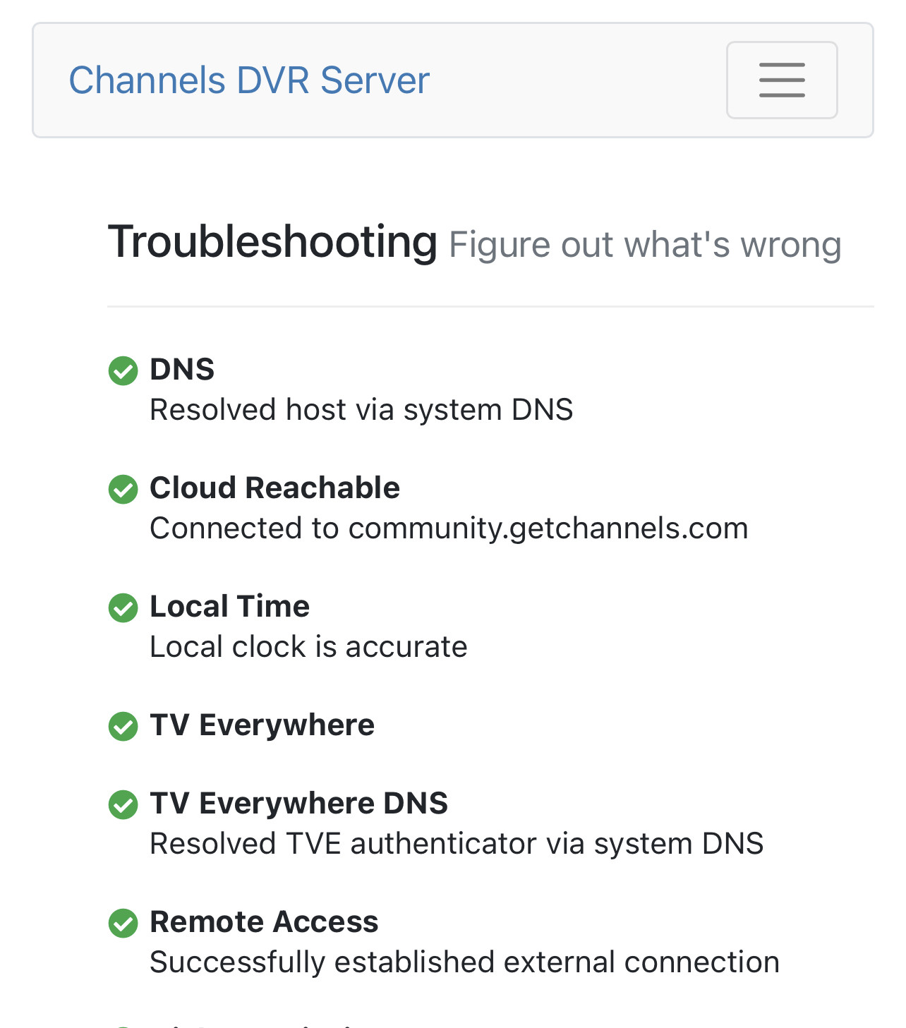

Can you go to your dvr main Web page then "Support" then "Troubleshooting" and make sure there is no TVE error.
