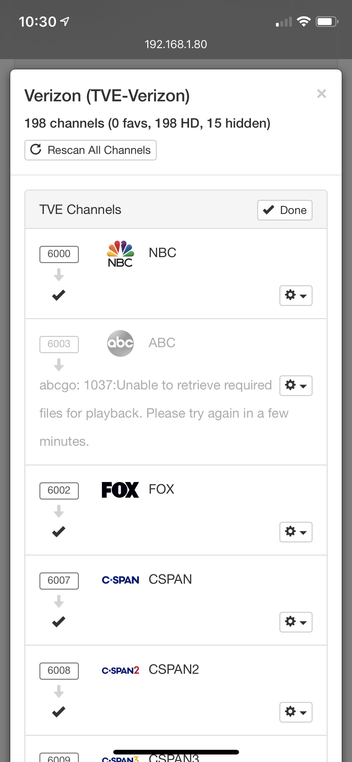

Mine shows the TVE ABC channel, but when selecting it in the guide I get an error "Tuner Not Responding".
I guess it's not working. I just saw it added to my TVE list and guide and thought it was active without testing.

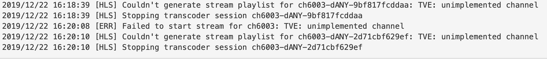

How do I get this to rescan. Fox is not showing up however when I go to the link I am able to watch with no issues. In addition ABC shows as an unimplemented channel...
My ABC (KSTP) stream was working a few weeks ago but I started getting errors so I rescanned and now I get the message below.
Don't know if this helps
I’ve tried that a few times over the recent weeks to see if it resolved actually.
