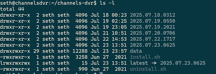

Seems to have lost WNYW local NYC Fox on TVE after update to 7/22/25 release..... Amy way to downgrade??

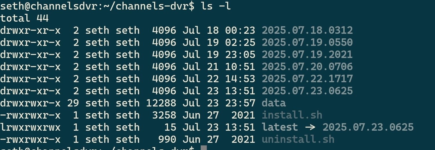

If you are on linux you can just change the symlink in the /channels-dvr directory to point to an earlier build. See my screenshot below, you just change the latest simlink dir to one of the date folders above. Then restart the server.
I dont use Windows so if that is your OS, i cant help you.

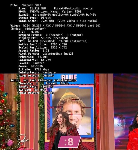

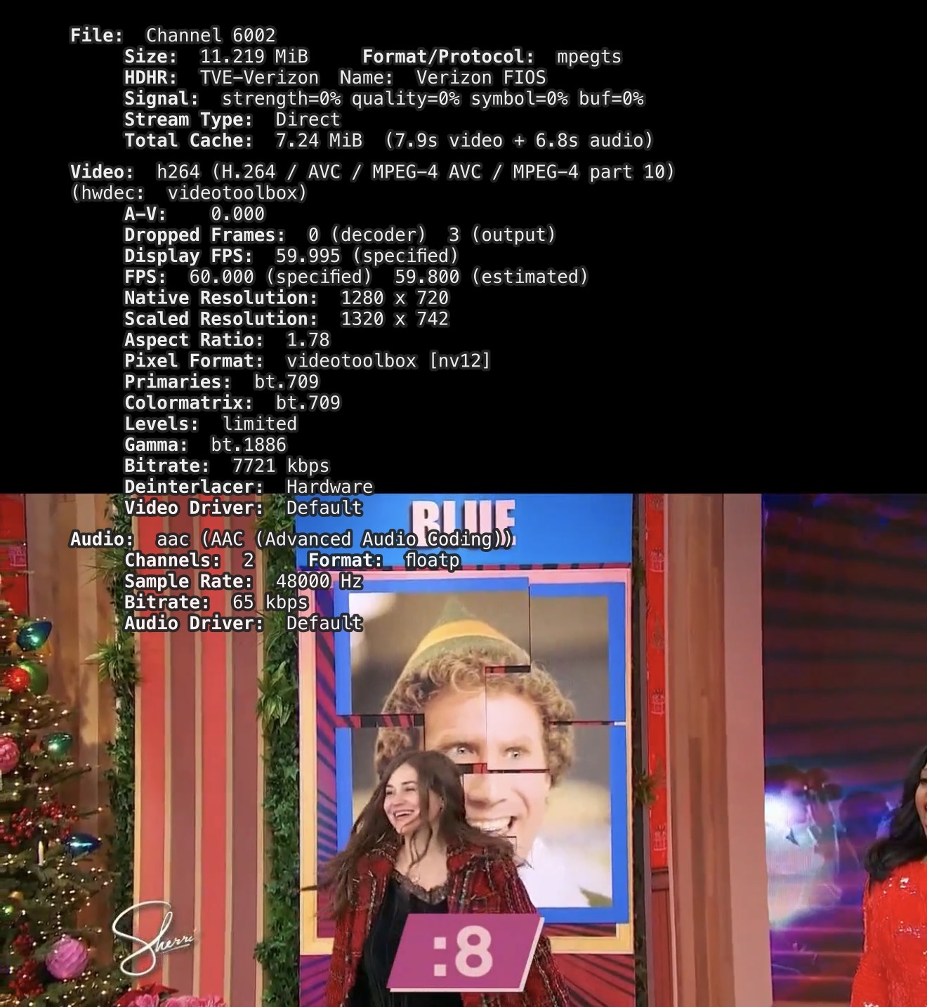

This is fox a few minutes ago.
2025/07/24 10:52:35.745958 [TVE] stream timestamps: fox: start_at=2025-07-24T10:51:35-04:00 end_at=2025-07-24T10:52:04-04:00 live_delay=27.271954s
2025/07/24 10:52:35.746397 [TNR] Opened connection to TVE-Verizon for ch6002 WNYW

If you go to C:\ProgramData\ChannelsDVR, you can just rename whatever version folder you want to latest. Of course, stop the server first, remove/rename the current latest folder, then do the rename for the the one you want, and finally restart the server. Otherwise, it's exactly the same process!

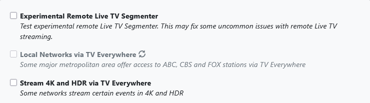

You scan for the local networks by toggling (uncheck, then check) this setting in your Channels DVR web admin UI
Settings > Advanced > Experimental > Local Networks via TV Everywhere
When you check the box again to scan, It will prompt you to connect securely (Try again over HTTPS here or here) so click one of the here links and then check the box again.

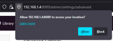

It will then ask to allow your browser to provide location information
Capture
and you will see a spinner as it scans
