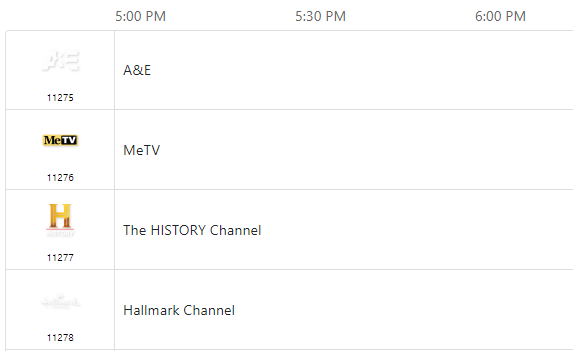

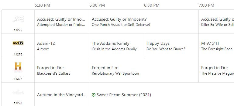

@matthuisman StartTV stationid should be changed to 122695.
Using the method I described here Picking the correct tvc-guide-stationid for a channel
and looking at 16 days of airings (386 airings), stationid's 74916, 109454 and 122772 are identical.
stationid 122695 has 11 of 386 airings different.
I recorded 3 of the differences and found stationid 122695 has the correct listings.
Here's 2 of them from last Sunday.and stationid 122695 on the right side was correct.
If anyone wants to verify, the next difference is airing tonight at 9pm PT.
The listing on the left side is stationid 74916
The listing on the right side is stationid 122695
The one after that is tomorrow night at 9PM PT.
left side is stationid 74916, right side is stationid 122695
And here's all 11 differences in 16 days of listings, not much

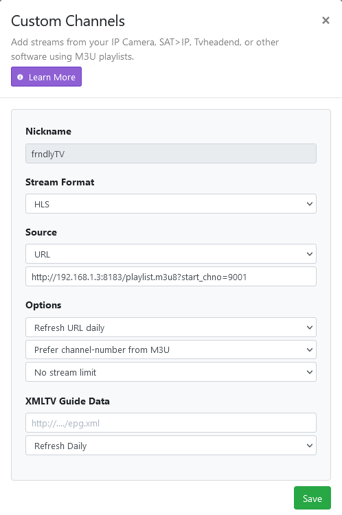

ok, my FrndlyTV seven day trial is quickly running out and still no joy...
First to the author of FrndlyTV for Channels.... Good work but Channels looks like they have no free tier. I do not want to be a cord cutter getting nickeled and dimed to death on small fees here and there that add up to the same cost as a basic cable subscription.
So I have tried a few other DVRs and I have very similar results with them . some like NextPVR will not take the epg.xml generated by this script at all. Others like TVMosacCE take it but seem to not recognize it. I am pretty sure something does not come out quite right from the script with the epg.xml file..
Also there are issues with some other DVRs not playing these links. I can see they point to my Raspberry Pi where I am running the script. and the script generates the following error when I try to access it from TVMosaic.
Someone will probably say it is a python problem or something but I can extract the link from the m3u8 file and open the link from a desktop computer with VLC or Celluloid without issue. I can see there is no error and the "frndlytv-for-channels" is happy with VLC or Celluloid, but not with some of the servers..

Here's my custom channel settings
Since the playlist already contains the gracenote station id's for guide mapping, no need to specify an XMLTV url in the settings. Channels DVR will update the guide data daily like it does for HDHR and TVE sources.
