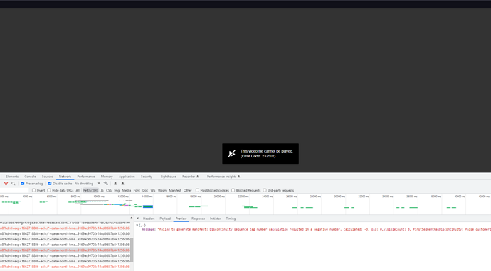

i can't play hallmark or hallmark drams via their website
Im not going to look into it until that is sorted
