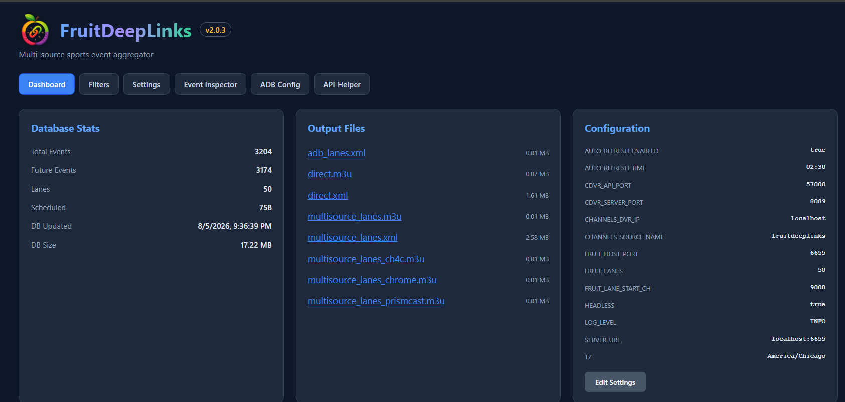

I can't even figure out how to configure this thing. It says "database not found" and the settings are all blank
Ok I guess it had to scrape first but how do I even log into this thing
Read the instructions on the GitHub page!!!

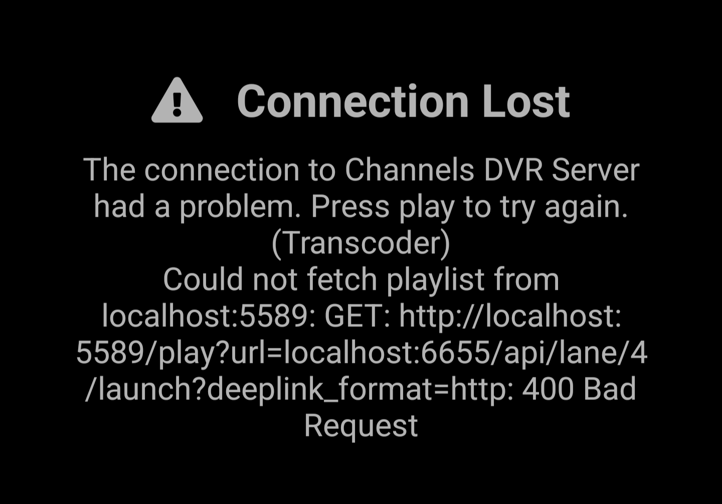

I'm seeing an issue with the Amazon results, lots of MLB games are showing up as 'Prime Exclusives' in the guide but these are MLB.TV games that I can't watch because I don't have a sub. The URL errors out to a 'subscribe to Prime' page even though the browser is already logged into Prime (I'm getting these through the Prism proxy).
But I wouldn't be able to watch them anyway because they're not Prime exclusives.
EDIT: might be because I can't get anything to work with Prism, I just tried watching the FedEx golf first round and get this in the Prism logs:
[2026/08/13 08:33:02.638 AM] [ERROR] [localhost-h9ky4y] Stream setup failed for http://localhost:6655/api/lane/1/launch?deeplink_format=http: Waiting for selector `video` failed.
I have the ESPN channels configured in Prism and they work fine so I'm not sure what I have to configure in Prism to get it to see the ESPN video in the redirected espn.com UUID URL. The redirected URL plays fine in a browser when I access the FDL link that Prism gets.
