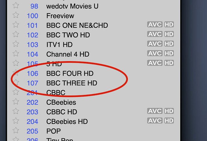

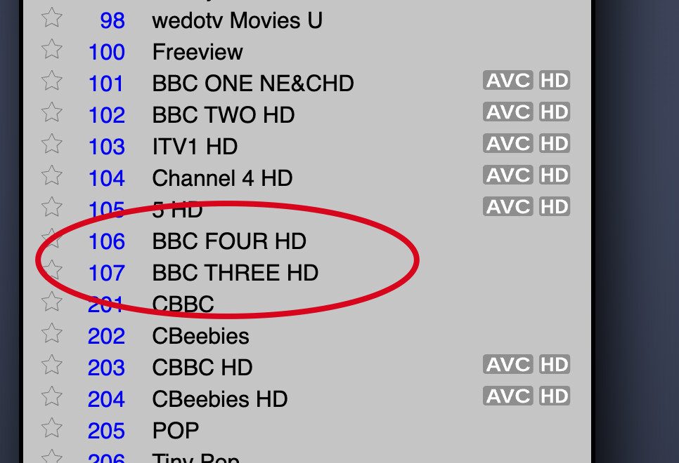

On my UK Freeview channels, HDHomeRun is missing the "AVC" and "HD" tags for a couple of HD channels.
The result is that the channels don't appear when filtering by HD channels.
The lineup mapping is correct in that it maps to the HD listing, but obviously this is not a factor for Channels.
Given that this is coming from the antenna/broadcast, I was hoping for a way to manually tag these channels as HD myself, but can't find a mechanism to do so.
Is there a way I can do a fixup?

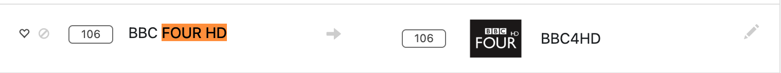

You can edit the lineup on your DVR web ui
@tmm1
This is what I see
So that looks correct in terms of mapping. But I'm not seeing any way to move that into the HD section?
At the moment, it's listed as an SD channel, and I suspect that is because the metadata from the broadcast does not flag it as HD (see original post).
I was hoping I could just add an override on the Channels side?
Since that is coming from your HDHR tuner, you may want to ask SiliconDust why it's not identifying the channels the way you expect it to.
Are they actually AVC HD broadcasts?
I'm not in the UK, but I remember some posts about broadcasts being HD part of the day and SD part of the day, and the results you see depended on when the channel scan was done.
@chDVRuser ah, that is interesting about mixed SD/HD channels
I'm not 100% - however, both of those channels have matching SD equivalents earlier in the lineup too. So I suspect it's the metadata not coming through.
It would be a nice feature to be able to edit this on the Channels side! though, I'm assuming there's no technical implication there, and rather it's just a tagging/grouping thing.
