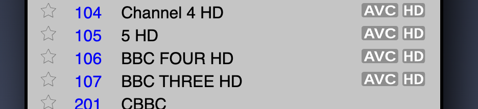

This is what I see
So that looks correct in terms of mapping. But I'm not seeing any way to move that into the HD section?
At the moment, it's listed as an SD channel, and I suspect that is because the metadata from the broadcast does not flag it as HD (see original post).
I was hoping I could just add an override on the Channels side?

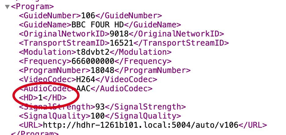

You can see what the HDHR tuner thinks the video codec and SD/HD status are for all channels by looking at the XML
http://hdhomerun.local/lineup.xml?show=all&tuning
or JSON
http://hdhomerun.local/lineup.json?show=all&tuning
output from your HDHR tuner.

Interestingly, the channel looks marked as HD in the metadata
