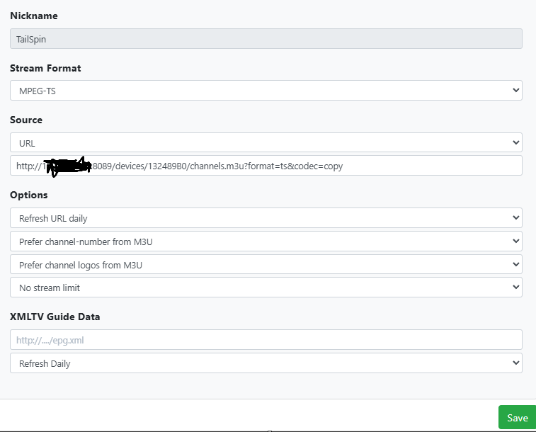

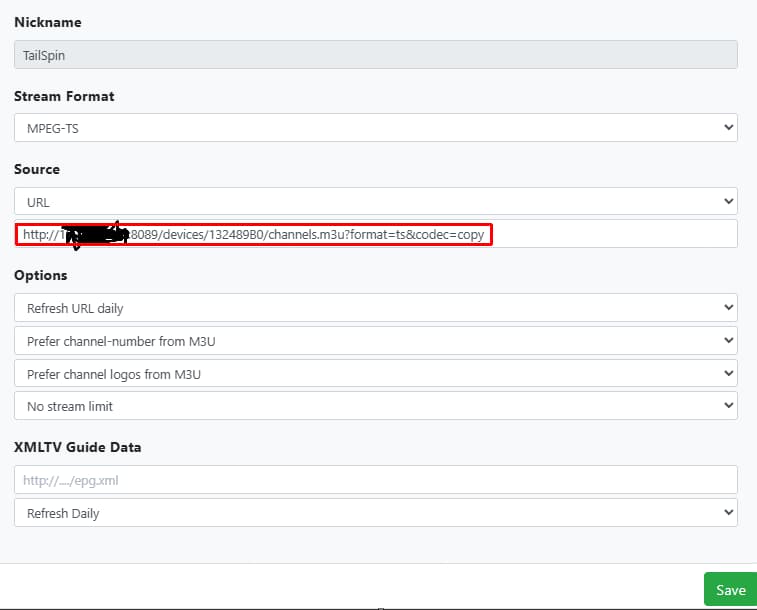

Do this
  • Create a new Custom Channel source with a different name
  • copy/paste the Source URL into it
  • Set the Option to Prefer channel logos from M3U
  • Leave the XMLTV Guide Data url blank
Then before saving it, post a screenshot of the new Custom source settings
If you would have followed the directions I posted earlier you would have been done long ago.
Renamed (originalstill there just in case)

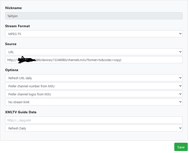

Remove the right paren ) from the end of the source URL and post the screenshot again

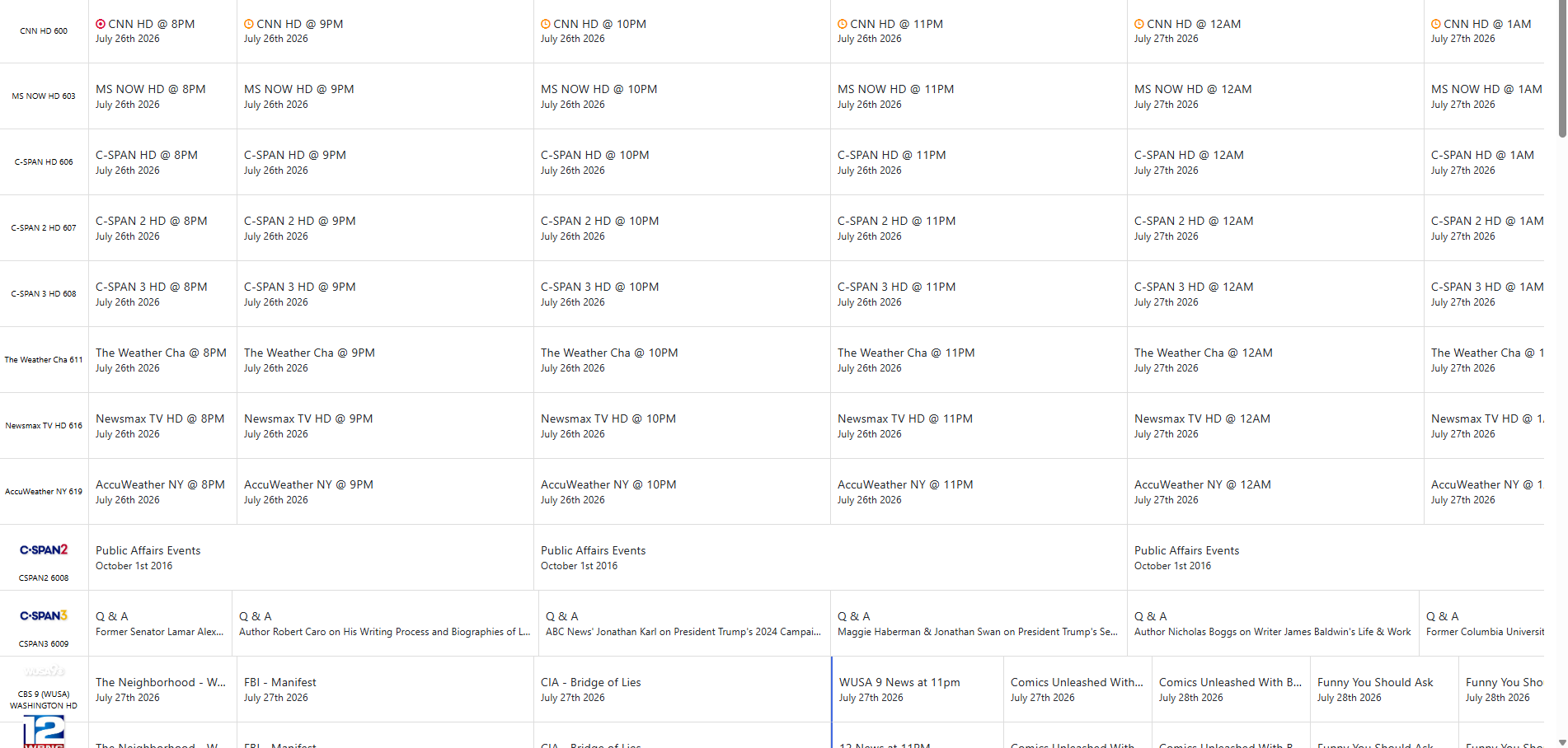

Other sources have logo and descriptive programming info except the HD Hr source
OK. Save it

After the guide data finishes loading, look at the DVR web UI guide.
Then Delete and Recreate the guide database to remove the old channels from the bad source and look at the DVR web UI guide again.

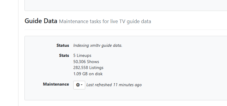

Okay it's indexing (Says 5 lineups) but I have 6 sources now (down from the 7) since i deleted original as you advised
it does not seem to be picking up hd homerun channels
No dice it only sees 5 lineups when indexing not the 6 that exist but NOT HD Homerun

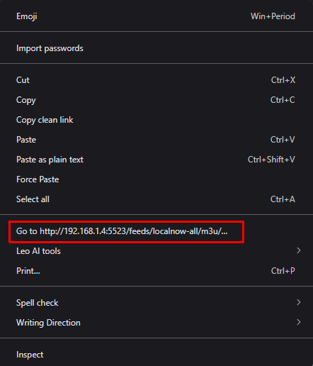

I do have Tailscalce on both server. Highlighting that url and rick clicking does not give me the option to save
Thank you too for going the extra mile here
Do you get an option to go to it?
Then it should let you save it as a file.
After i highlight it there is no right click option to save as file
At this point if I could justget station Logo ID i'd be thrilled. Is there a way to manually insert a channel logo?
Is there an option to go to the url?
If so, do that and then save as file.
