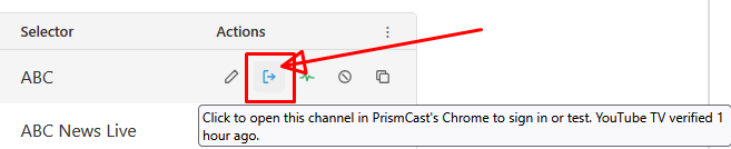

The tuner is working for all other sources, but the Prismcast source no longer receives, I think. When I first managed to get Prismcast working, most of the channels that came in were in the 9000-number range, and it sometimes took more than one button call to get a feed to load but it was kind of working ok. Then, fewer and fewer channels worked,and now trying to activate a specific individual channel by forcing a Prism-agent browser connection brings up that Chrome window, but it seems to be going to the guide listing, not extablishing a browser session for that channel/program. Does that make sense?
If you mean the Login button, that's only needed to authenticate to the channel with your provider.

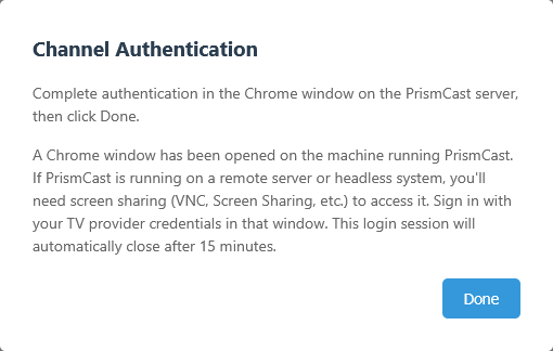

Once you authenticate and click Done you should be able to play the channel in Channels DVR.
That's what I am clicking to try to restart the feed. If I look at the browser window that initiates it is going to Xfinity and then closing before I see what's happening. It might be trying to access some Xfinity guide view, which it didn't do before.
When you click that Login button it's supposed to keep the Chrome browser tab open for up to 15 minutes, or until you click Done (so you can interactively login using your provider)
