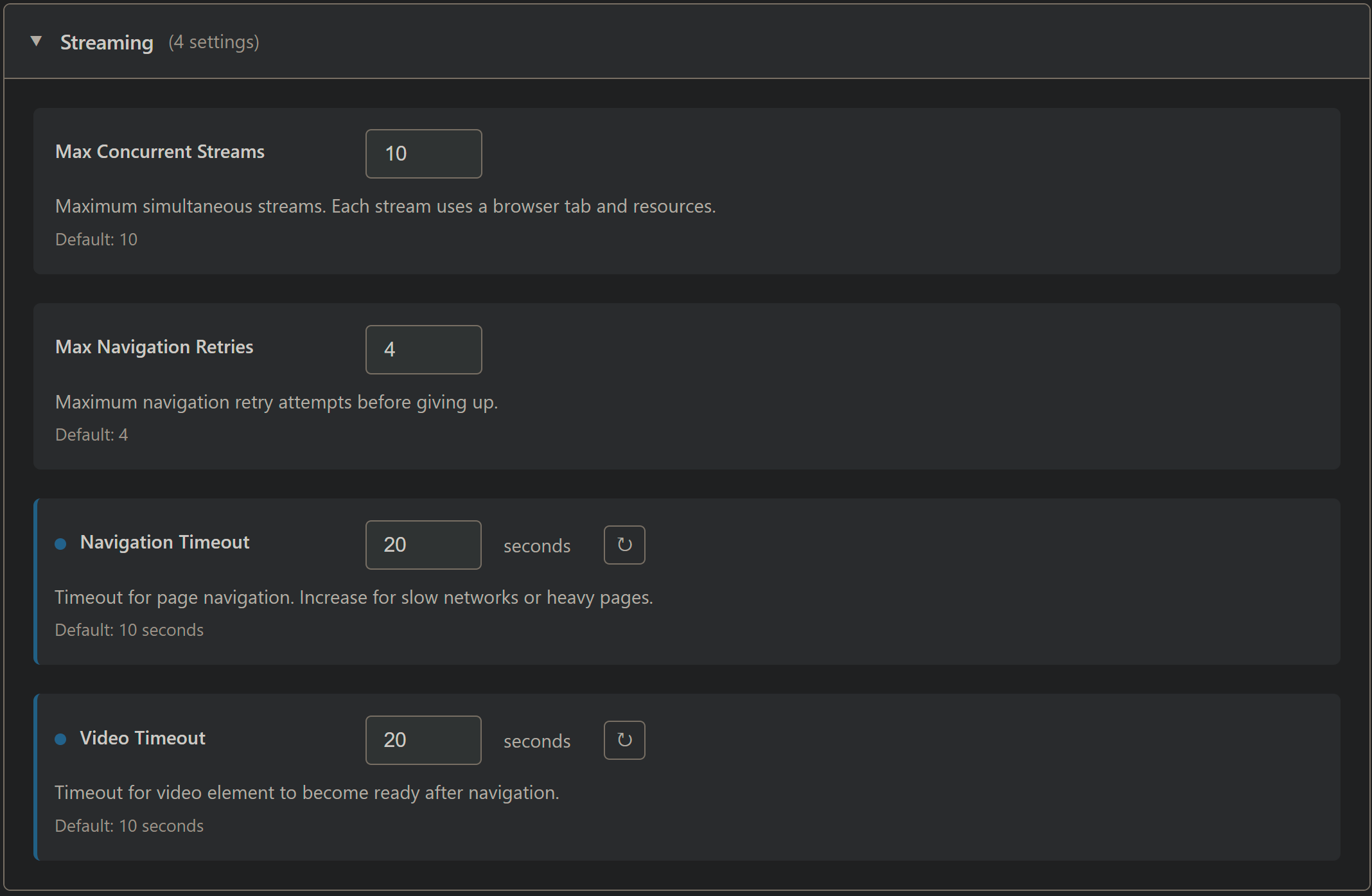

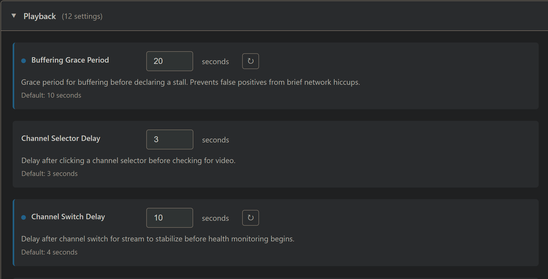

Pushed an update this morning to bnhf/prismcast:latest (aka bnhf/prismcast:2026.01.26) that brings the docker version to v1.0.8.
This is exactly the type of low end system I was warning against running this project on. It's not just that you will have issues with this container, but performance problems could spillover to anything else you're running on this PC. Channels DVR, other Docker projects, etc.
Understood. Was testing more out of curiosity (I like to tinker). I've been slowly moving everything off my Synology NAS (except storage) so trying to see what ultimately I want to have setup. I have an Intel NUC (i7-1165G7) as my desktop PC but considering ordering a Ryzen 7 7840HS Mini PC so I can do AV1 hardware encoding. If I do pull the trigger, then I would move the i7 to be a Linux box with Channels and all my dockers to it.

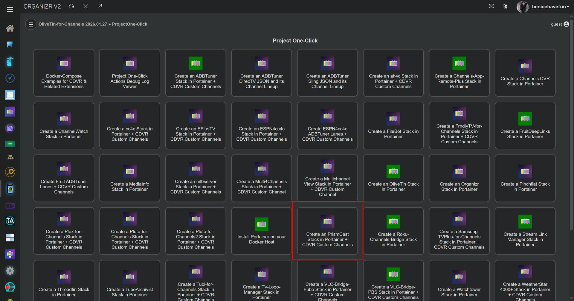

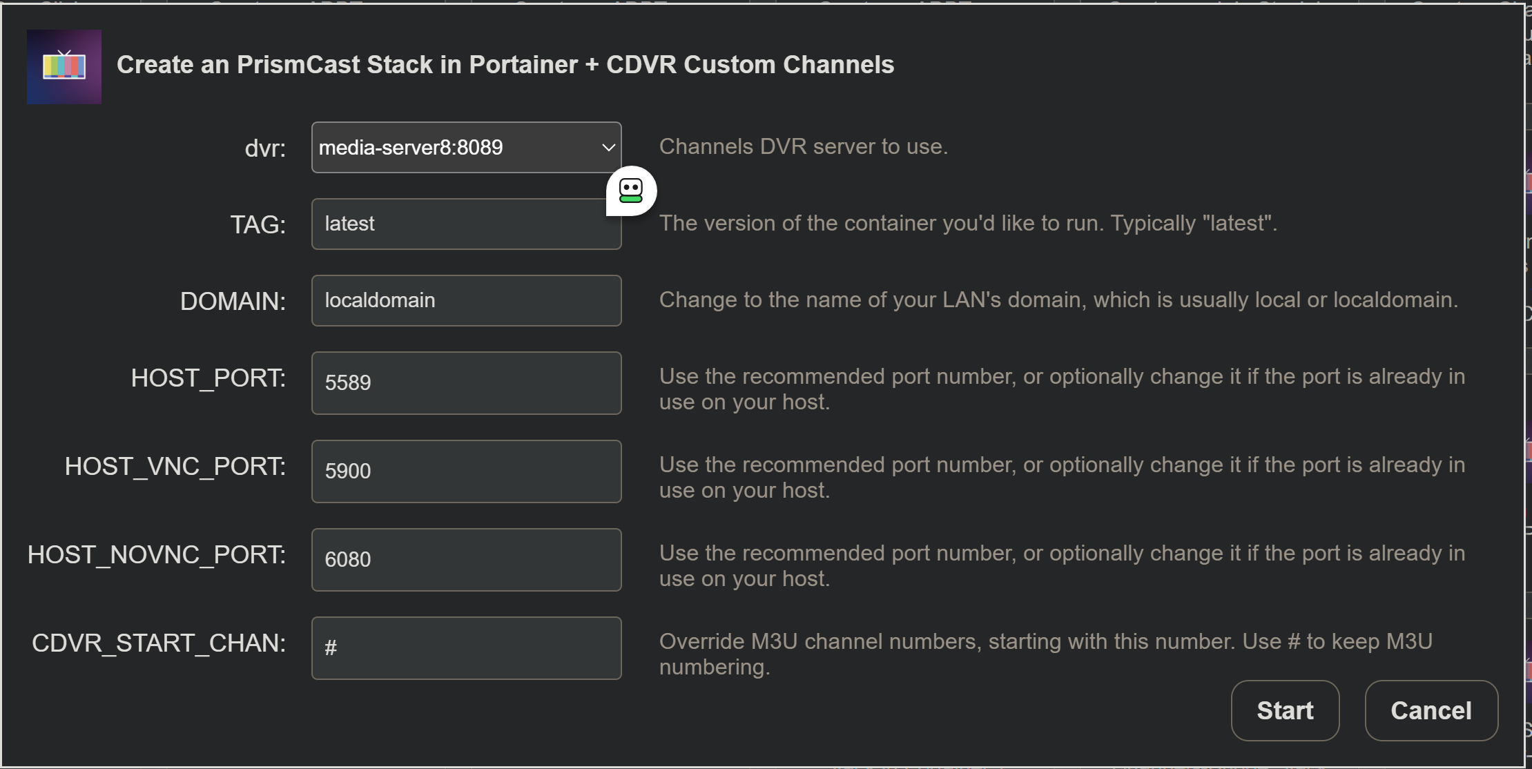

PrismCast joins the Project One-Click family of Actions. Installs in seconds, ready to use in minutes!:
Use the defaults, or set your own host system ports and CDVR starting channel number:
Or from the new Project WebUI+ dropdowns:

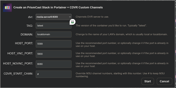

@bnhf
Tried using Project On-Click to install this, but dvr box does not allow typing. When I click on it, it only shows a second dropdown choice. I did do the clear cached images and files tip you posted in the other topic.
So are you saying that neither of the dropdown choices are correct for your servers? Is this using the "classic" dashboard or WebUI+? Not having the correct DVRs defined in your env vars is something you should definitely fix.
Either way, that's defined by your OliveTin env vars. If you have a single DVR defined then you'll have a field that allows data entry, with that server as the default. If you've defined multiple DVRs then it's a dropdown.
Feel free to post your current env vars if you have questions (might require a redaction or two)...
It's on the "classic" dashboard. If I use any of the other buttons, that I don't already have installed, they prepopulate correctly with my dvr.
Right on -- I see the issue now. I'm building a new container as I write this, which should be available to pull in about 15 minutes. Thanks for reporting this!
EDIT: Re-pull and redeploy

This works well, although there are some things to know, and settings changes needed for Sling that could be relevant to similar setups others might be trying.
First, as far as login goes, using VNC or noVNC (before even attempting to tune) and navigating to the provider's website independently is the way to go.
Also, for a provider like Sling several settings are too aggressive. Here are the adjustmens that worked for me (non-default shown in blue -- as you know):
Playback settings:
Streaming settings:
The stack needs to be stopped and restarted to apply those changes. With the above setup, the experience is similar to cc4c/ch4c, while benefitting from the reduced CPU requirements of this project.
