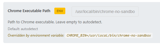

I've been setting this up on Windows using the OliveTin/One-Click version from @bnhf. My issue is that PrismCast doesn't seem to be launching an instance of Chrome for login to a channel or when attempting to tune to a PrismCast channel. Should I have chrome installed on the Debian WSL on my Windows host machine or do I need to make an alias of the installed Windows version of Chrome or something else?
Screenshot of PrismCast's setting for Chrome's executable path.
It gets set in the OliveTin Dockerfile (relevant lines)
# Create Chrome wrapper script with --no-sandbox for container environments
RUN echo '#!/bin/bash\nexec /usr/bin/google-chrome-stable --no-sandbox --disable-setuid-sandbox "$@"' > /usr/local/bin/chrome-no-sandbox \
    && chmod +x /usr/local/bin/chrome-no-sandbox
# Environment variables
ENV CHROME_BIN=/usr/local/bin/chrome-no-sandbox
Thanks for this update! Using the keyboardMultiVideo profile with the ESPN channels and the newer link format got them to work for me too!
I was wondering if anyone has had any luck getting Disney Channel and Disney Jr. Channel to work? I already notified the DEV and he said he'd be working on this with a future update but just wanted to see if anyone else out there had some luck. Again, I don't have a Disney+ account, but I'm able to use my TV provider to login and watch live feeds through the following link format: https://disneynow.com/watch-live?brand=004
It is running in a docker container. To get to chrome you have to VNC into the container using the port under HOST_VNC_PORT which defaults to 5900.

Thank you! I totally missed that part.
http://yourserverip:6080/vnc.html
