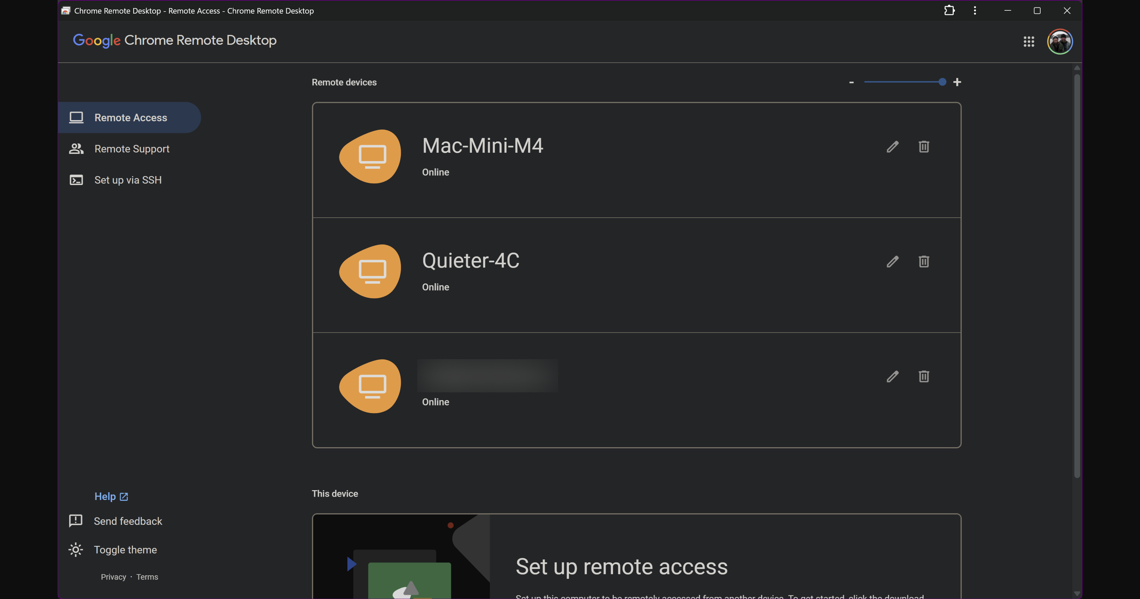

I use Chrome Remote Desktop to access my Mac Mini M4, both locally and remotely. At least for me, this has produced better looking results than a VNC Client.
Screen Sharing in high performance mode on macOS connecting to my Mac. High Performance Mode is the key...you can tweak it in the settings for the connection. High quality audio/video. It's quite nice in my experience.
I'd describe Chrome Remote Desktop as something independent of the Chrome Browser -- but I've always used Chrome to set it up, so I'm not sure if there are any gotchas there. But, in any event, it has its icon and does its own thing as far as I know.
Do you need to login to a google account on either the host or client to set this up or use it?
Looks like the Chrome Remote Desktop extension is available for my Brave browser.
I would imagine so, but don't know for sure. It'll look like this on a Windows PC, once installed:
Works great for remote support too -- I've used this for aging parents, siblings and even the occasional trusted Channels user.
In my experience, for accessing a Mac system from a Windows computer, Chrome Remote Desktop gives a high quality desktop -- with good ease-of-use, locally or remotely. I use Tailscale with it for remote use, but that's not required.
EDIT: You have a number of options for getting the best resolution from the slide-out side panel. I use the AV1 codec plus various other options that give the highest quality -- as I typically have plenty of bandwidth (even remotely) to max everything out.
