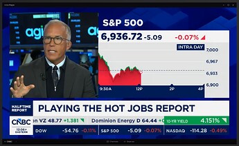

On Monday, I let CNBC run for a solid 5-hour stretch (11 am – 4 pm) while I worked. The stream was rock-solid and didn’t skip a beat all day.
Yesterday, I went full "channel hopper," switching things up every hour. The app handled the tuning like a champ!
Some networks like Bravo, sometimes causes a reload during the switch to a commercial.
The biggest win for me? The news tickers. They scroll with zero jitters, just smooth motion.
Watching CNBC again today since 8:30. Still going strong.

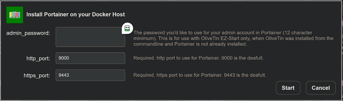

I installed Prismcast, Portainer and OliveTin. Couple quick questions off the bat.

  1. I went to the Portainer page in my browser (xxx.xxx.xxx.xxx:9000) and the UI comes up. It's asking for my login/password. Am I supposed to know what this is??!?!?
Can't wait to get this fully up and running. Thanks
The Portainer username is admin, and the password is the one you used when installed Portainer during the EZ-Start process here:
Yep that was it @bnhf thanks!

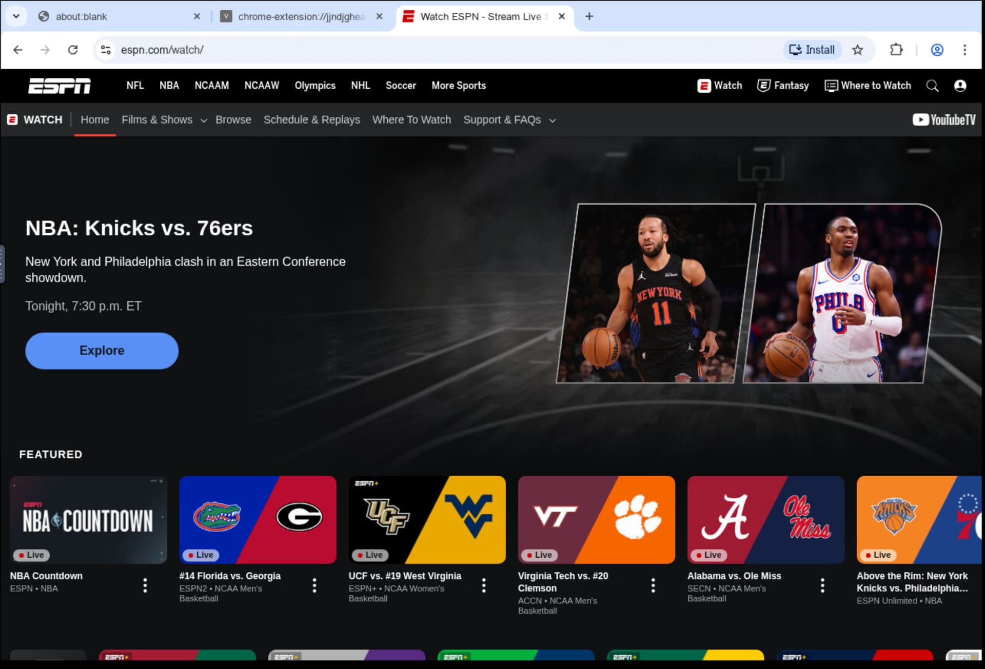

EDIT: Also, could you post a screenshot from noVNC, that looks like this -- so we can confirm some basics:

Not sure what noVNC is? I've used VNC client/servers in the past to remote into machines??
This is in chrome...
