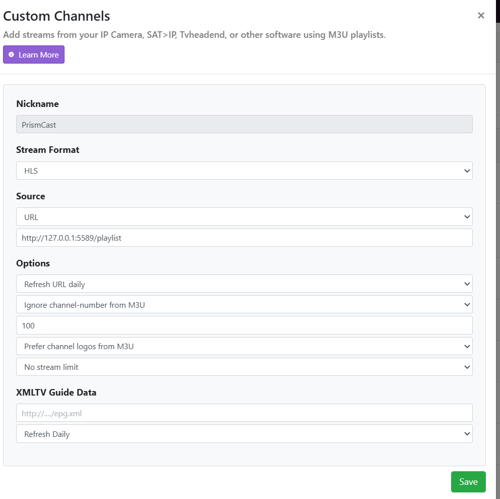

Thanks @hjd. I confirmed that PrismCast is setup per instructions (see below). I did do a couple of scenarios and if I feed PrismCast directly to Emby, or if I send PrismCast from my Backend Channels DVR server but bypass Threadfin to Emby, it then works. So the handoff between Threadfin and Emby/TiviMate seems to be the problem even though my frontend Channels DVR works fine with the Threadfin feed.
EDIT - Was able to use the Frontend Channels DVR (which derives it's sources from Backend CDVR through Threadfin) as the source to feed into Emby and it appears to work. Reaffirms that this is an issue between Threadfin and Emby (even though other sources such as ADBTuner pass through just fine).
