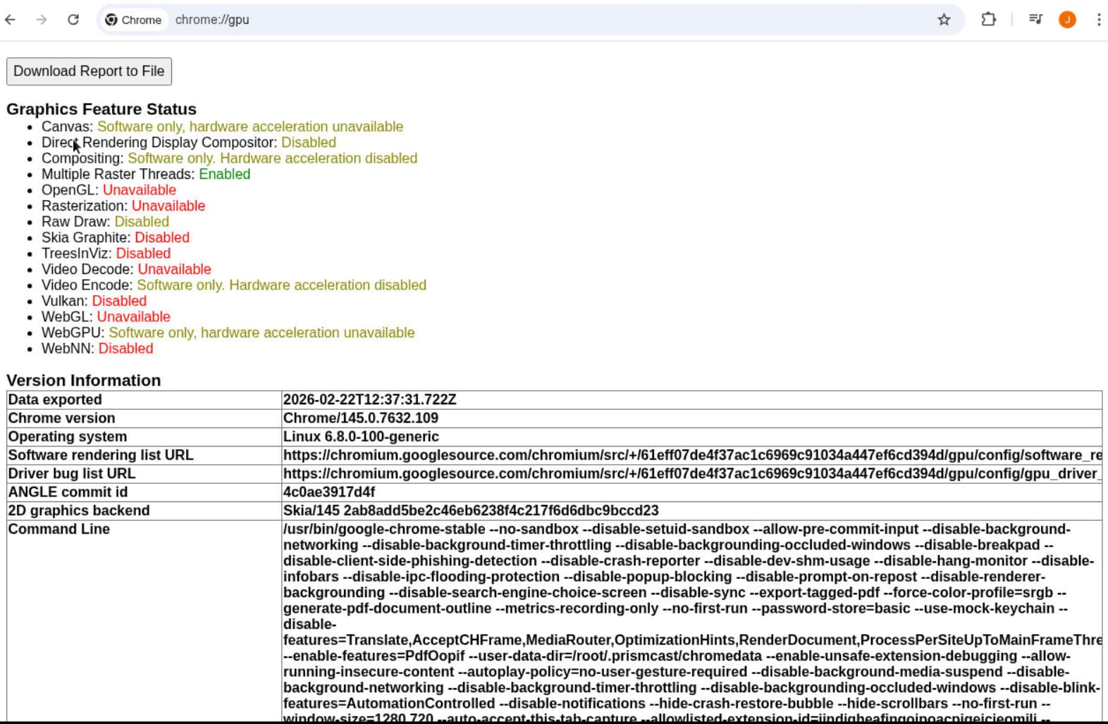

One thing I would do is, once PrismCast loads in your environment - pull up the Chrome instance it spawns and go to: chrome://gpu/ - it will tell you if the GPU is in fact enabled and in use for PrismCast.
Can you post that output/screenshot?

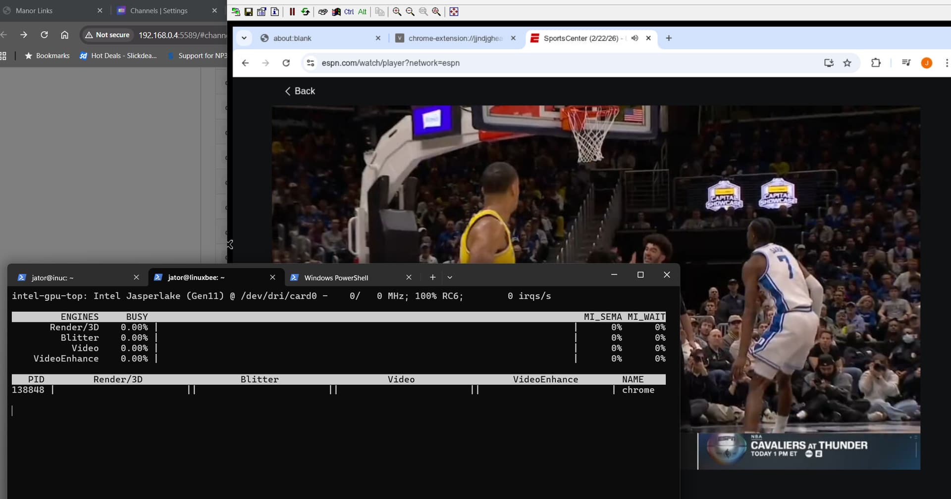

Good suggestion, though it tells me (I think) that it's not using the GPU:
I will say that I see the CPU cyles in the 50s-60s now vs. when I previously tested and saw the CPUs close to 100. This box isn't being actively used now so I wouldn't think the box was "multitasking" when last I tested it. But this is why we should test, eliminate the variables and determine the actual impact. I'll keep playing with it.

I believe there's a long-running set of threads/issues with the Chrome/Chromium team about allowing Chrome to work with GPUs in containerized environments...and for whatever reason, they have declined to do so to this point. If you want GPU acceleration and a headless environment, you're going to be Mac-only or doing something exotic like HDMI plug emulators, as I recall.
And apologies, I didn't mean to imply it was a Mac only, MacOS first is a better way to say it.
No worries!
I'm sorry to say, I believe this is wishful thinking. But, being ever hopeful the Linux Chrome implementation will start utilizing the GPU, I'd suggest you install intel-gpu-tools on your Docker host. With that installed, you can run intel_gpu_top, and then you'll know for sure.
If you think you're seeing anything promising at that point, please post a screenshot here...
Just for sh!ts and giggles, I installed in my Synology NAS (DS1520+) and started up ESPN through the login feature and then went over to VNC and the single screen appears to be fairly smooth (as smooth as you can tell from VNC). I also noted that the Synology Nas was bouncing between 60-80 on htop. I wasn't doing any comskip or streaming externally which would pull from the CPUs. I did the chrome://gpu/ on it and got the same results as the N5105 machine.
The above is my impression that the CPUs aren't being as taxed when using the above methodology, but the output of the GPU stats would indicate otherwise. Like I said, I'll keep playing with this to see if I still see a material difference in performance and welcome others to see if they are having the same experience or something different.

I think we can put this to bed, not seeing the GPU register any support of the stream:
But apparently, a single stream may be possible from these lower end Cleron-ish CPUs. Granted I've not connected to my client devices to visually inspect the output, but clearly the GPUs are still out of reach for us Linux/Docker folks.
