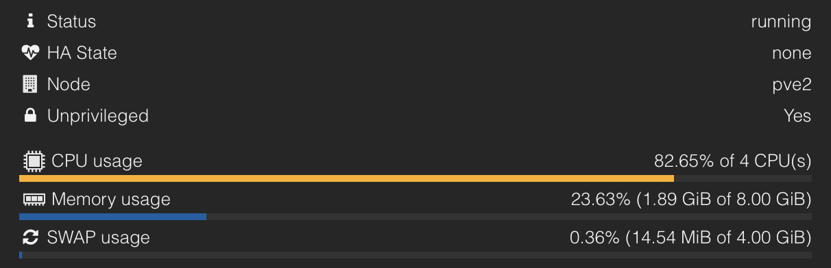

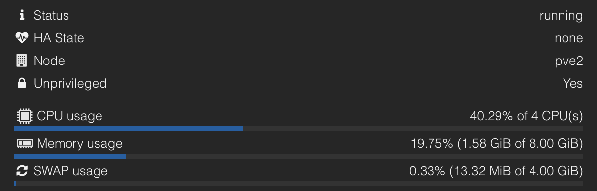

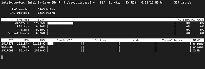

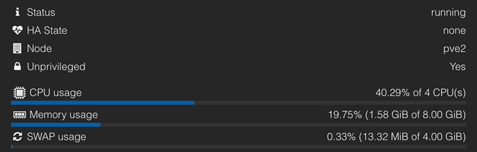

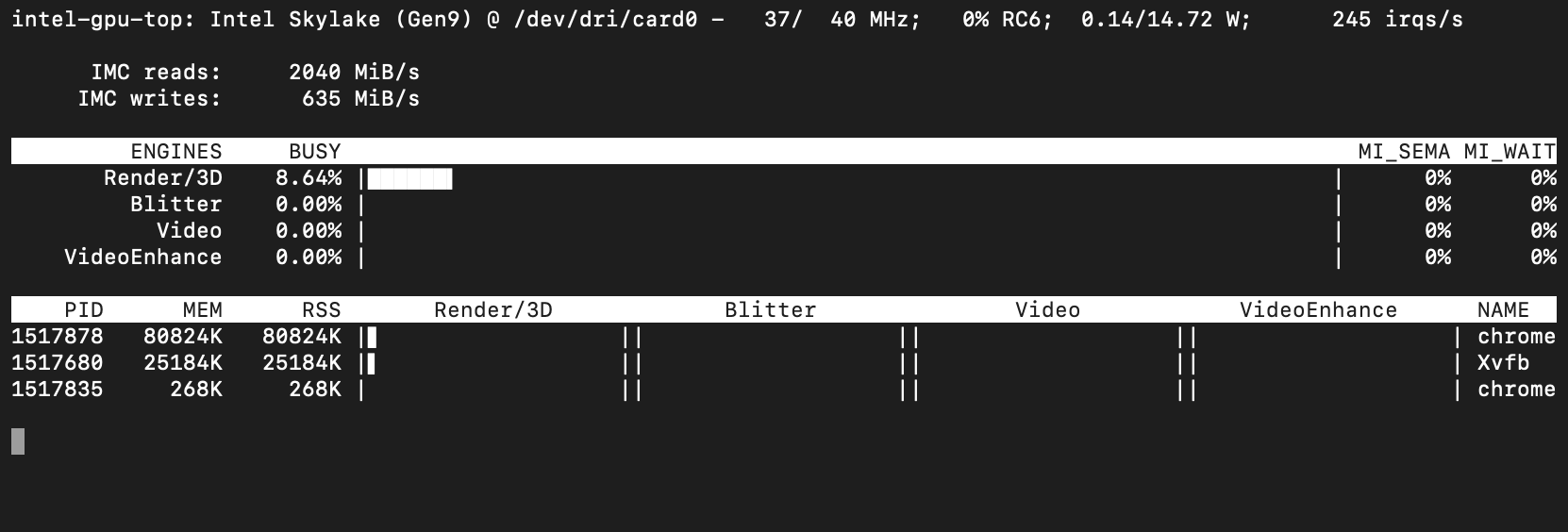

@bnhf Sure, I took a few screenshots, all without connecting to the desktop session via browser/noVNC.
Without streaming anything:
While streaming:
I'm running Docker in an LXC container on a Proxmox host. CPU usage while streaming in my container:
With my container down and the official PrismCast container running one stream:
Usage is twice as much as mine, looking promising to me :slight_smile:
