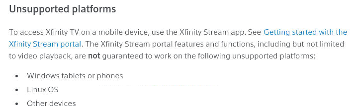

I always forget it's Linux OS in portainer.
