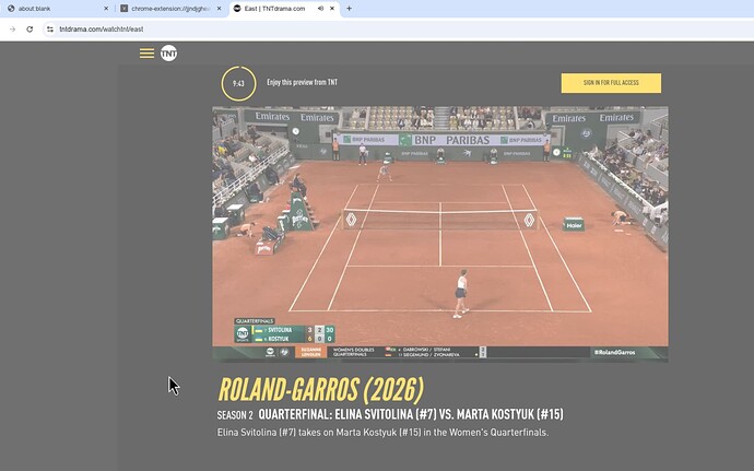

After Chrome came up and minimized a few times, I brought up the Chrome that was minimized.
I then went to Manage Extensions, saw Video Capture 0.1.0, and on the upper right is the Developer mode toggle.
Turned on Developer Mode, closed the Manage Extensions tab and ran prismcast service restart
Developer mode is still enabled. Make sure the extension is there and enabled.

Make sure the extension is there and enabled. It won't enable unless Developer mode is on.
Extension
After you turn Developer mode on, you need to enable the extension.

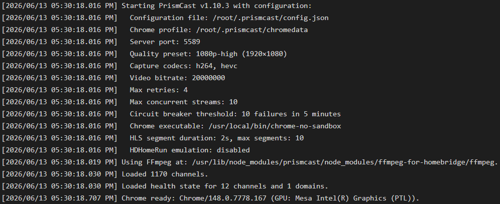

[2026/06/18 06:44:56.242 PM] Starting PrismCast v1.10.3 with configuration:
[2026/06/18 06:44:56.242 PM]   Configuration file: /Users/chDVRuser/.prismcast/config.json
[2026/06/18 06:44:56.242 PM]   Chrome profile: /Users/chDVRuser/.prismcast/chromedata
[2026/06/18 06:44:56.242 PM]   Server port: 5589
[2026/06/18 06:44:56.242 PM]   Quality preset: 1080p-high (1920ร—1080)
[2026/06/18 06:44:56.242 PM]   Capture codecs: h264
[2026/06/18 06:44:56.242 PM]   Video bitrate: 4000000
[2026/06/18 06:44:56.242 PM]   Max retries: 4
[2026/06/18 06:44:56.242 PM]   Max concurrent streams: 10
[2026/06/18 06:44:56.242 PM]   Circuit breaker threshold: 10 failures in 5 minutes
[2026/06/18 06:44:56.242 PM]   Chrome executable: autodetect
[2026/06/18 06:44:56.242 PM]   HLS segment duration: 1s, max segments: 20
[2026/06/18 06:44:56.242 PM]   HDHomeRun emulation: disabled
[2026/06/18 06:44:56.259 PM] Using FFmpeg at: ffmpeg.
[2026/06/18 06:44:56.266 PM] Loaded 1203 channels (33 user, 1170 predefined).
[2026/06/18 06:44:56.266 PM] Loaded health state for 12 channels and 2 domains.
[2026/06/18 06:44:57.377 PM] Chrome ready: Chrome/149.0.7827.156 (GPU: Apple M4 [AV1, H264, HEVC]).
[2026/06/18 06:44:57.377 PM] e[33m[WARN] Bundled FFmpeg is not available. Preroll generation skipped - startup playlists will have no segments.e[39m
[2026/06/18 06:44:58.081 PM] Capture system verified successfully.
[2026/06/18 06:44:58.495 PM] CDP proxy listening at /cdp.
[2026/06/18 06:44:58.495 PM] PrismCast is now listening on 0.0.0.0:5589.
