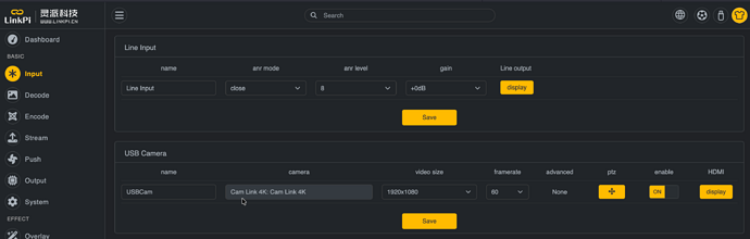

For those using the Elgato Cam Link 4k on an Enc1v3, did it take anything special to get it working? Whenever I plug mine in, i see only gray screens for the previews on the dashboard and the streams for both HDMI and USB don't work. I have another usb capture dongle that works fine at 720p60 but once I swap it the Elgato, it appears to break both HDMI and USB. I've tried all of the USB ports and rebooted several times. I'm on the latest linkpi firmware and the Elgato stick appears to work fine when hooked up to a computer.
Try a factory reset from the LinkPi WebUI.
I just plugged mine in and it worked right off... I bet the factory reset will help.
I have this exact same problem when I plug in any USB 3.0 capture device. The Elgato is a bit too rich for my wallet, but I have tried a couple different Amazon no-name USB 3.0 1080P 60fps capture devices and as soon as I plug them in, everything craps out on the Linkpi. My cheapo USB 2.0 1080P 60fps device works just fine.
Has anyone tried a factory reset, as suggested? Did it work? I'm hesitant to try as I don't like fooling with things which are working. I'd hate to knock something else out in the process...
I did try the factory reset of the link pi to no avail. I do have another cheapo USB capture dongle that claims to be usb 3.0 and it works albeit at a max of 50fps at 1080p. Here are the things that I've tried that haven't worked on the elgato:
  • Factory reset of linkpi via web UI
  • 3-4 firmware updates leading up to the very latest from Linkpi
  • Updating the firmware of the Elgato Cam Link 4k
  • Attaching the elgato via a powered usb 2.0 hub
Regarding the elgato firmware, mine was originally on something that appeared to be from 2018 and through their apps, I got it to update to something from 2020. I found references to a beta firmware from 2023 that someone posted a link to on a forum somewhere but the link appeared to be broken. It'd be interesting to know what firmwares others on.
One other thing that may be relevant is that there appear to be multiple revisions of the cam link 4k. Mine is 20GAM9901 but I've seen 10GAM9901 and 20GAM9902 on ebay listings.
