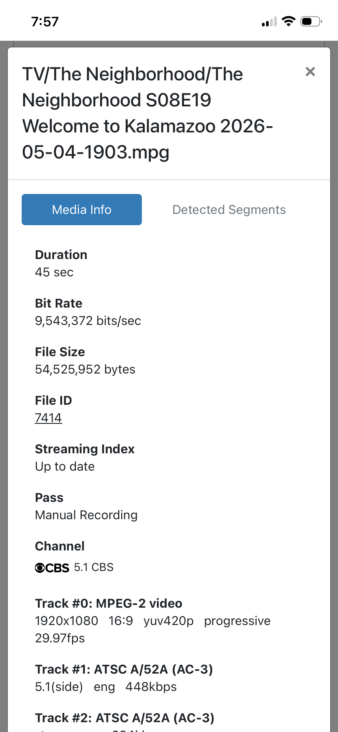

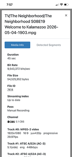

Could channels thinking that an atsc 1.0 hdhr feed is progressive when it is actually an interlaced broadcast feed cause these kind of slow mo issues?
