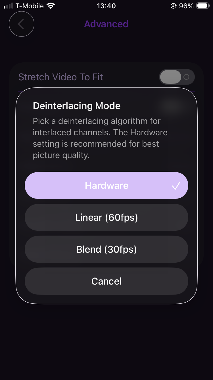

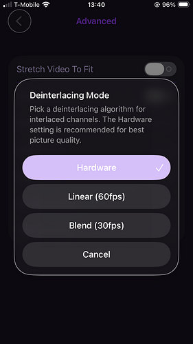

I tested the latest beta today with hardware de-interlacing turned back on and I had no issues after about 10 hours. I would love to see this fix make its way out into a release :slight_smile:

Thinking back yes I do believe this has only happened on interlaced programs, typically from CBS in my case, such as the Grammy Awards and the Matlock season finale. I regularly watch American Idol which is 2 hours and it never has this problem. American Idol is on ABC which is 720p.

I just submitted diagnostics. I was playing a 1080i channel and it started at almost exactly 30 min. Into the program. Hopefully this can help out. The linear 60fps eliminates this, but the picture quality is not the best.
