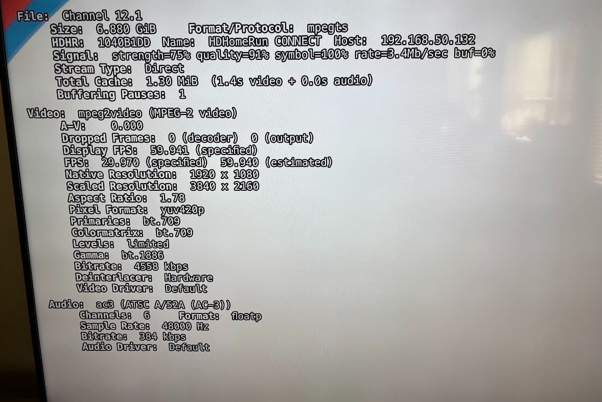

If someone could update to the latest TestFlight and turn Hardware Deinterlacing back on and reproduce the issue again and submit diagnostics that could be helpful to track down the source of the issue.
Once you’re submitted it you can switch Deinterlacing back again.

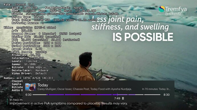

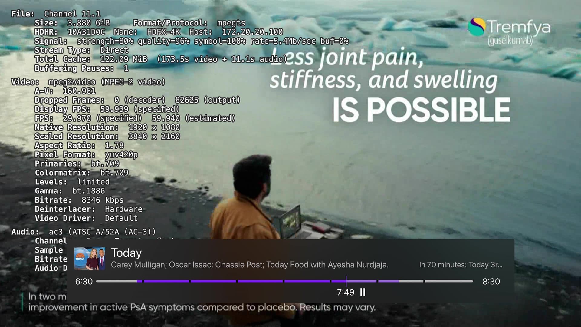

Well, it's back. Though I noticed it's fine during live broadcast, but if I'm behind the timeline a bit (when someone pauses, then plays after a few minutes), then the issue pops up quickly.
