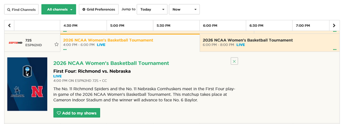

Any idea for the women - as I'm getting a whole lot of duplicate Event Titles, "First Four: Teams TBA".

And you would have to keep refreshing guide data to get updates from Gracenote since CDVR only updates once every morning. So you'll probably get lots of recordings with Teams TBA
I wonder why Gracenote hasn't updated their data for today, then. It still says "First Four: Teams TBA" for the event title. This will result in dublicate events having to be recorded.

I just check the Gracenote schedule at TV Listings- Find Local TV Listings and Watch Full Episodes
Then reloaded the guide info in Channels
Screenshot 2026-03-18 at 16-36-17 Channels Passes
So Gracenote is slow to update and Channels is slow to update from Gracenote.

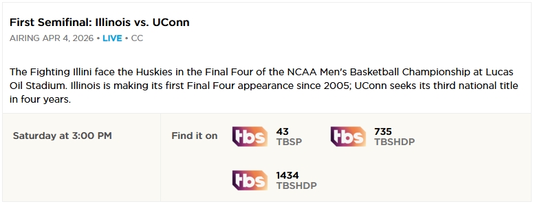

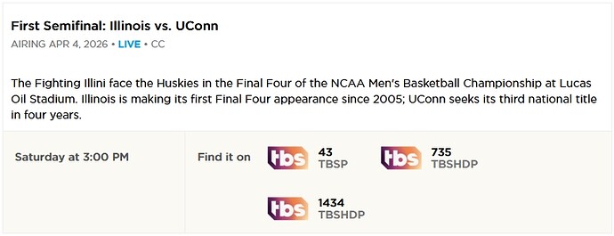

Same issue being seen now. Easy for me to notice with a team pass of a team still alive.
seeing same here.
Still happening. Check the semi-finals this Saturday on TBS.
