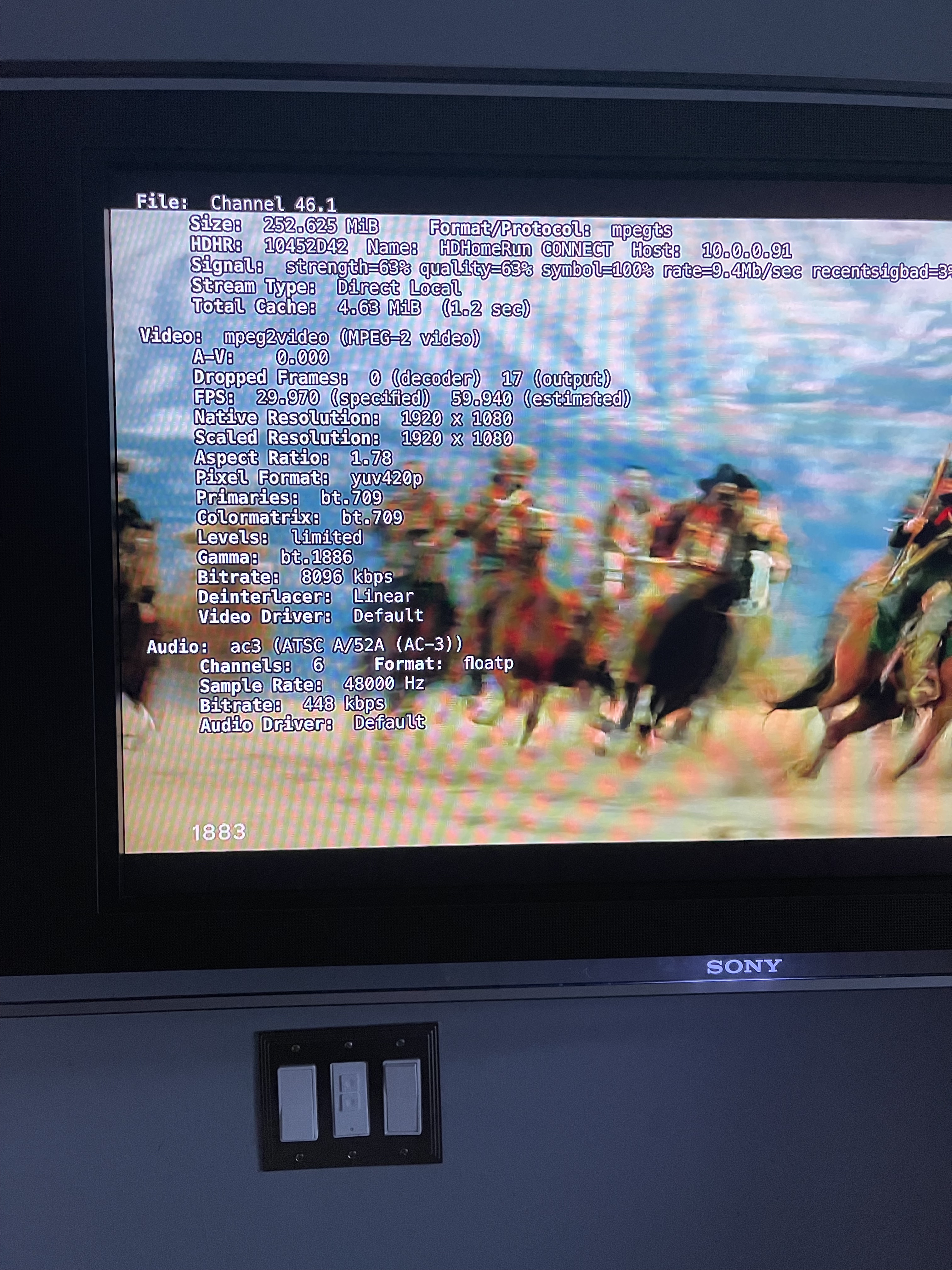

I'm sitting here watching the football game (well attempting too) and its just skipping and acting up. When I look at the NAS resource monitor I am only using 13% of my CPU and 7% of RAM! This is literally driving me CRAZY!!
Enable statistics. Are you dropping frames or is your buffer running out?
where can I enable statistics? its definitly buffering a lot.
I switched back to hardware transcoding and it seems like its working a little bit better.
Huh. Does the dvr activity say it's transcoding? There should be no transcoding while watching in home. Is the Apple TV set to Home Streaming Quality: Original?
It’s in the pull down menu - same area you find the caption toggle and sleep timer.
i didnt look...im just trying different things
is this on the TV on in the server settings?
On the Apple TV. When watching, pull down, swipe right to options.
Yeah that is on the low side. You should be aiming for mid 80s
