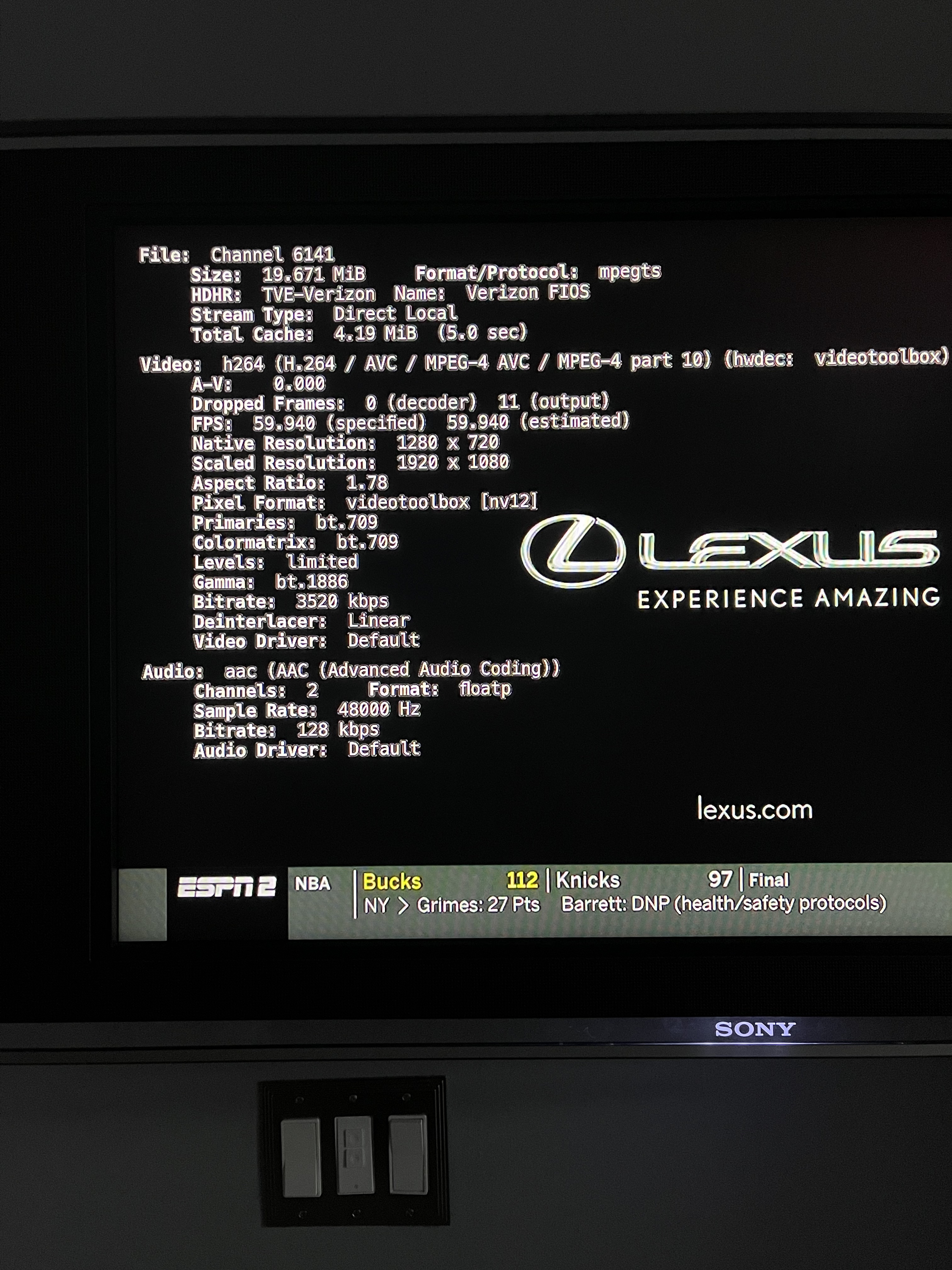

my original issues were with TVE...how do these stats look?
Watch the “total cache” while watching. Is it pretty consistent or does it get down to zero at any point?
its fairly consistent. The lowest I have seen is 1.15 and the highest I have seen is 5.10
goes lower during commercials bit hiher during programs...jumped up to 6-7
Are you experiencing the issue while it’s consistent?

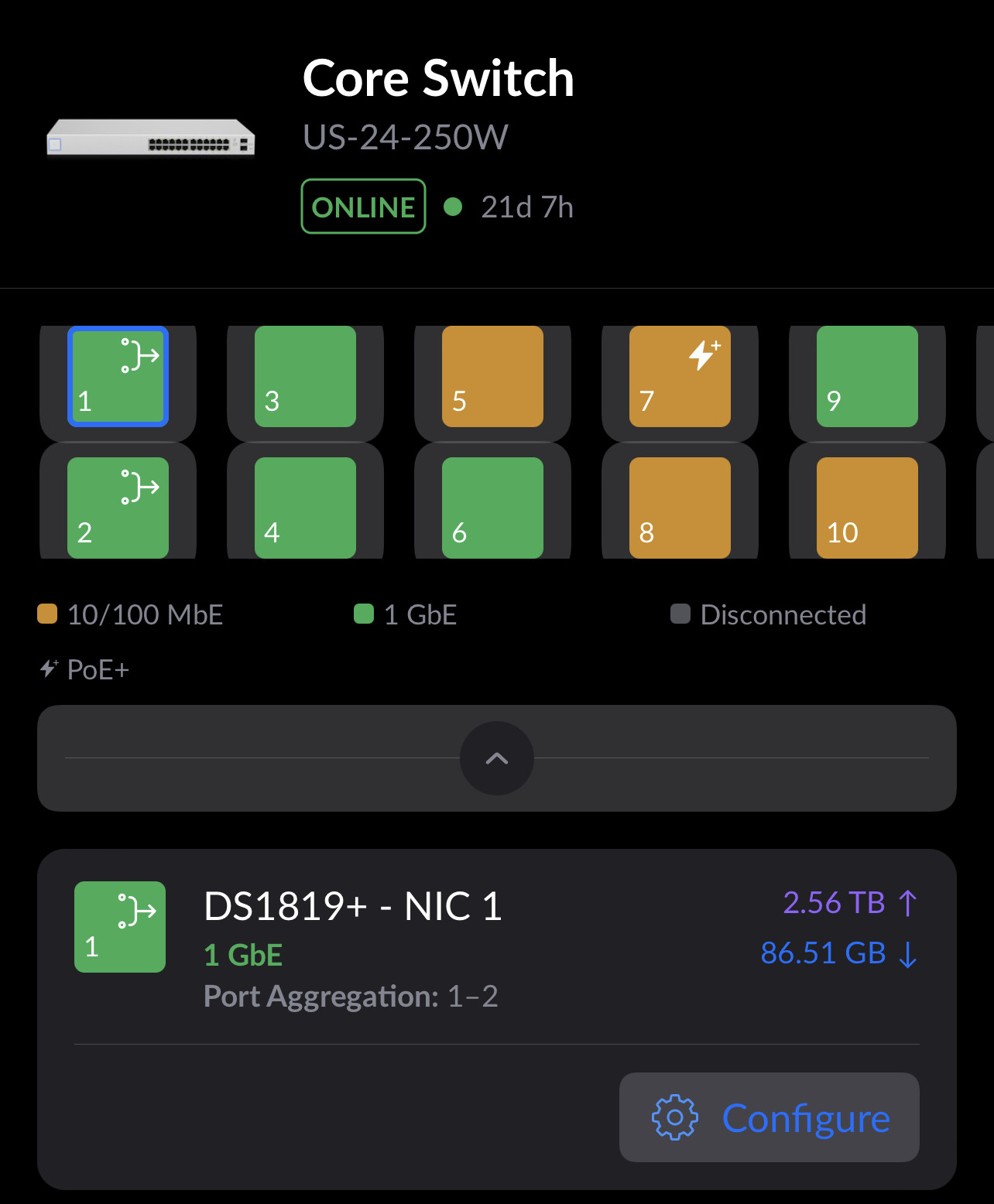

so far today things have been decent. I don't know if its cause I removed the aggregation bond or if its cause I changed the decoder to hardware but i haven't been having issues so far.
Quite possible you were having issues with the aggregation and signal issues for OTA. Having two issues makes it very hard to troubleshoot, would explain why it’s been so hard to figure out.
I only recently added the OTA antenna...its very possible that the aggregation was the source of the issues. I would have never thought that having aggregation would create an issue.

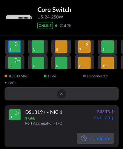

Well yea, if you didn’t tell the switch you connected the nas to that the ports are aggregate, it’s not going to work.
Thanks that's good to know...I will look up some information on that and see how to program the switch also
