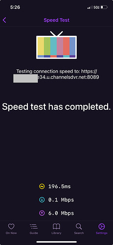

How do you view the results?
After running it displays this.
Hmm, it looks like the view is getting truncated.
Can you tell me what device that is?
If you could submit diagnostics that could be helpful
iPhone SE (3rd gen)
Just submitted diagnostics
Here's what it looks like while it's running.
Fix going out now.
Fixed.

I don’t think this is working properly when not on home lan/wifi. Cellular has a few hundred mb download and has no issues playing original quality. Speed test to server shows point one mb download.
Still broke. Unknown error occurred
submitted under ab9f5d9d-5f58-426b-815b-db4aac7a2c9a

This latest build should fix the remote access.
Does this fix the issue where it shows essentially zero download speed? I'm still seeing that one.
Yes it fixed it for me. Make sure you are on v2024.03.29.0505 or later on the app.
I did have a later version of the app installed but looks like I had to update my DVR too — now I'm good.
Good call. This does require an up-to-date pre-release build of the DVR to work correctly.
