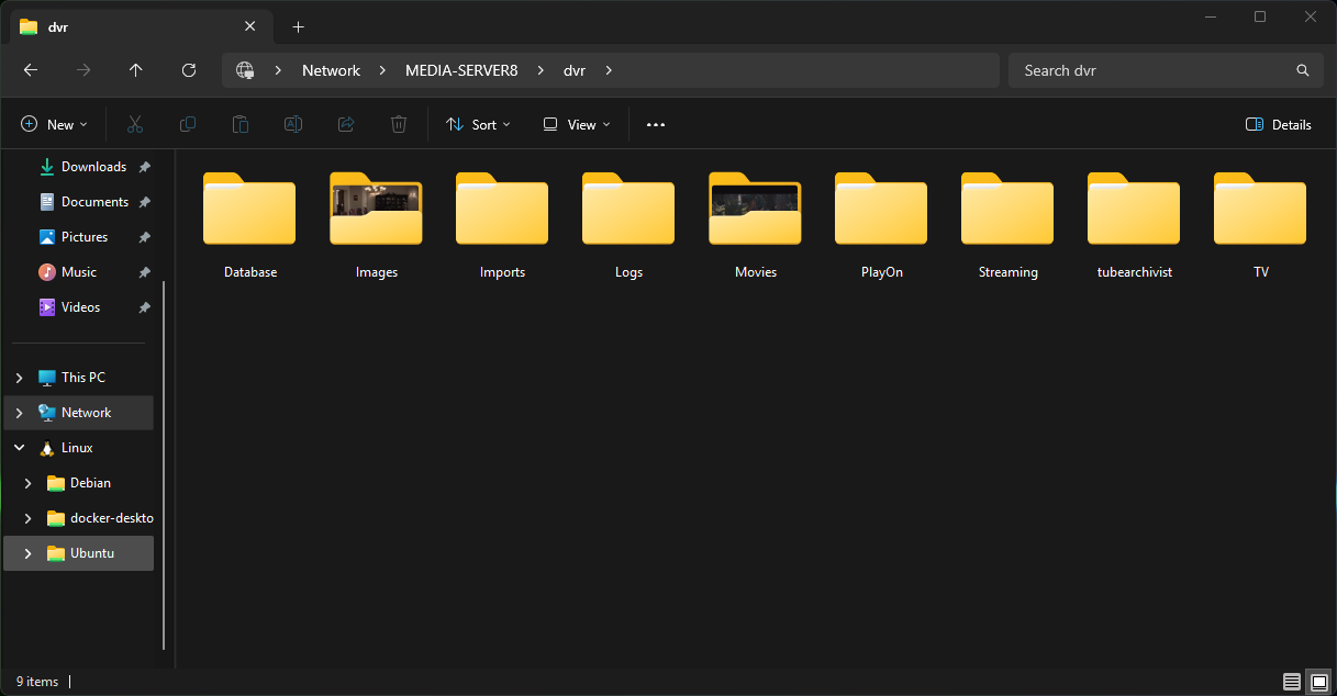

  • Share your CDVR recordings folder (if it's not already) via Samba. It should look something like this when you're done:

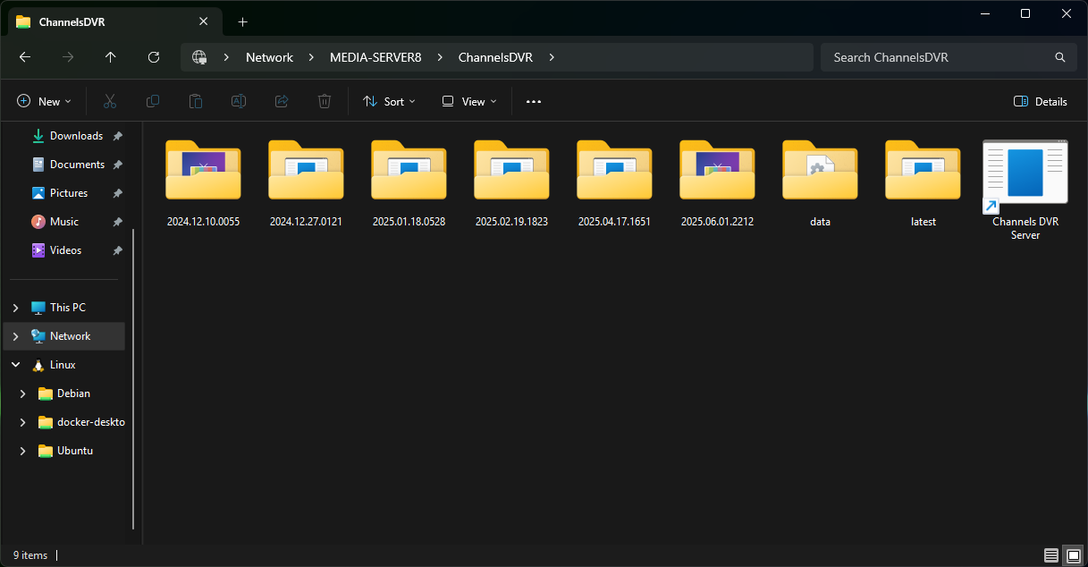

  • Share your CDVR executables/logs folder via Samba. It should look something like this when you're done:

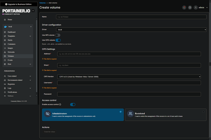

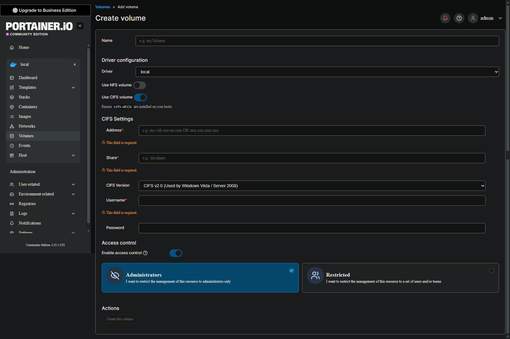

  • Using Portainer-Volumes, add 2 new volumes named channels-dvr (for your recordings) and channels-dvr-logs (for your logs/executables):
Using these two Docker Volumes, and the information you supplied earlier, I can then help you with the env vars you'll need to spin-up an OliveTin stack. Let me know when you get to that point, and then I'll finish in another post.

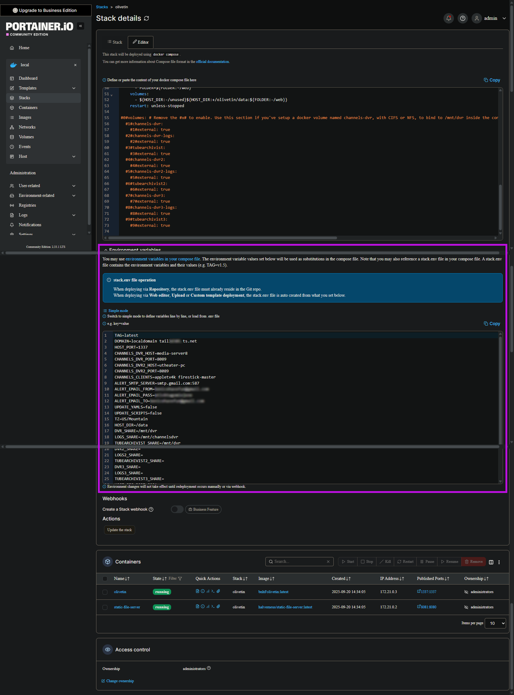

Then in the special Environment variables section of the Portainer-Stack Editor (Advanced mode), paste in this set of env vars. Adjust/add values if you have them, read -- then remove the comments I added:
TAG=latest
DOMAIN=localdomain tailxxxxx.ts.net # Use your LAN's local domain name if you know it, as well as actual Tailnet.

Later, if you want e-mail alerts where available, you can add something Google calls an "app password".
OK. Olivetin is up. I am sure I missed something. Haven’t needed token yet. I am guessing I need to run a health check. Game is closer than I expected.
Token goes here in with your env vars, as described in the comment I added. You'll need to stop your stack, make this change and then click the Update the stack button. No Project One-Click deployments will work without the token in place.
After adding the token, run the healthcheck and confirm each test reads as successful.

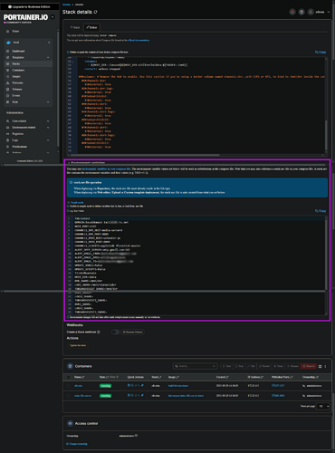

Nothing positive to report from that healthcheck -- failures across the board. I'd venture that the problem lies in the way you entered the compose and env vars into Portainer-Stacks. So, let's review that process:
First, the Docker Compose I posted for you above was ready to go, and required NO editing. Did you make changes to the compose?
Second, the environment variables are designed to be pasted in to the Environment variables section of the Portainer-Stacks editor in Advanced mode. Did you do it this way? The area outlined in purple is where to copy-and-paste in the env vars.
In the list of env vars I provided you there were a few that you needed to complete, including your Tailnet domain and the Portainer token. Also, pay careful attention to the value for HOST_DIR, as I'm not sure how the QNAP OS handles directories being created at container spin-ups. This value must be valid.
It's best to remove the temporary comments I added to these env vars, those were added just to bring you attention to values that needed to be completed:

TUBEARCHIVIST_SHARE=
DVR2_SHARE=
LOGS2_SHARE=
TUBEARCHIVIST2_SHARE=
DVR3_SHARE=
LOGS3_SHARE=
TUBEARCHIVIST3_SHARE=
HOST_SFS_PORT=8080 # Make sure 8080 is available on your NAS.
FOLDER=/web
PORTAINER_TOKEN=xxxxxxxxxxxxxxxxxxxxxxxxxxxxxxxxxxxxxxxx # Replace with the token you created.
PORTAINER_HOST=192.168.1.42
PORTAINER_PORT=9443
PORTAINER_ENV=2
PERSISTENT_LOGS=false
You might want to stop and then delete your current olivetin stack, then paste in the Docker Compose I posted above into its part of the Editor, and then paste in the env vars into their part of the Editor, followed by the adjustments described above to only what's in the Environment variables area.
I copied the wrong notepad last night. I am running out but will delete and redeploy this afternoon. Thanks for putting up with my foolishness. Was watching football and doing this at the same time.
I think I have this cleaned up. Let me know if you see anything

Better, but multiple issues still exist:
Since the indicted folders are not present among the listed folders, we know the shares you set up through Portainer-Volumes are not quite right. Did you follow the steps I outlined of creating the shares on your Windows Computer, and then connecting to those shares using Portainer-Volumes?
https://community.getchannels.com/t/project-one-click-all-in-one-installations-of-docker-extensions-and-cdvr-custom-channels/39669/569?u=bnhf
We can see from this section that Portainer is not responding either on port 9000 or on port 9443. Normally the version shows even if your PORTAINER_TOKEN value is wrong, but the ID does not. Here we're not seeing either.
Can you post a couple of screenshots, similar to the ones I posted in the link above, showing the two shares you created in Windows File Explorer. One for your DVR recordings, and the other for your CDVR logs/executables?
Also, assuming you can get to the command line on the QNAP, can you enter the following command:

Found an issue with shares. It looks like a known issue where Win 11 wants SMB 1. Reading now.
This all looks good, so it may just be an issue with your PORTAINER_TOKEN. If you think it might not be correct for any reason, you can always delete it, and create a new one. Then you'd need to stop your olivetin stack, and replace the old token with the new.
A patch MS pushed 9/10 broke SMB and network shares. I am working to roll them back. Right now all I can see on any of my WIN 11 PC’s is my NAS. Hope to resolve this today. Of course I made some changes on my CDVR PC trying to resolve this…which means more exploration.
