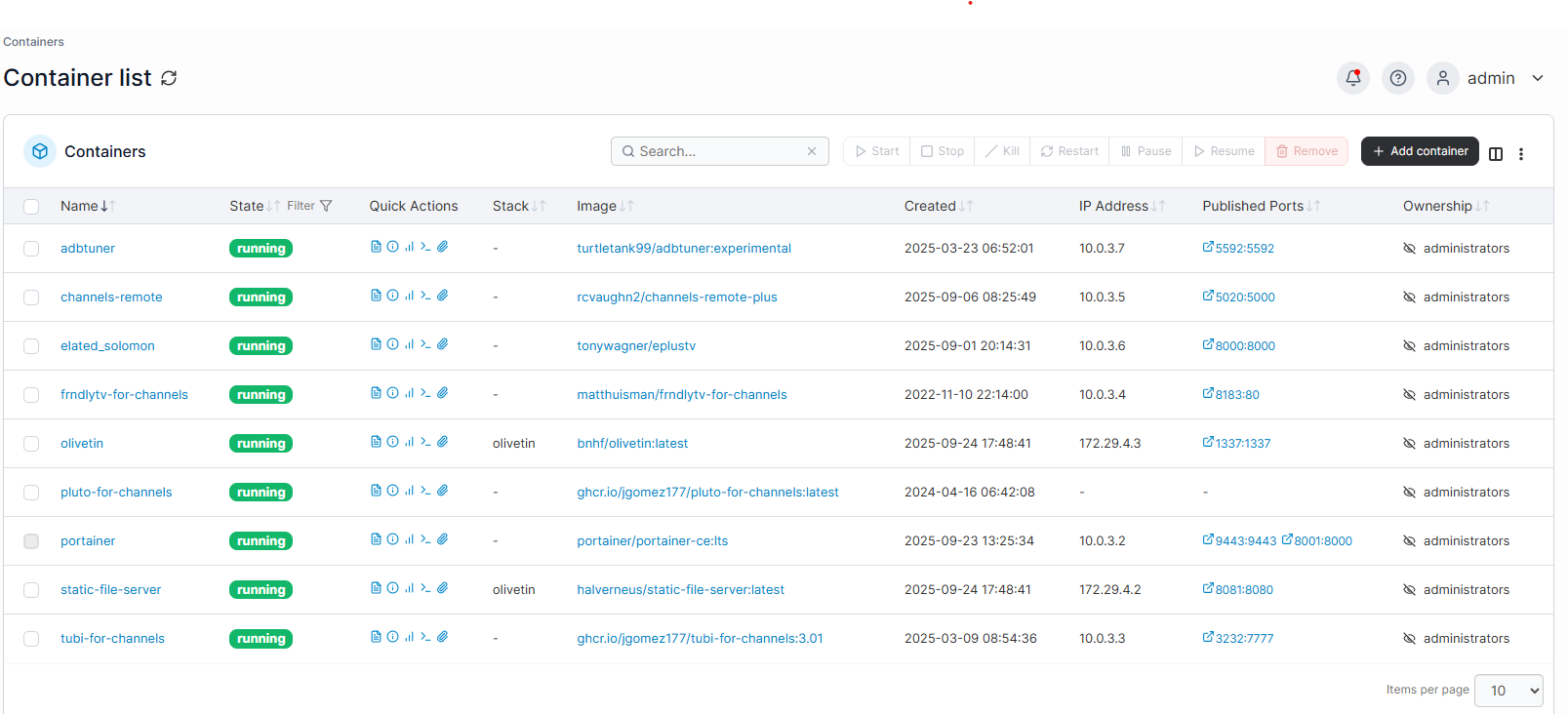

Here are the containers and IP addresses being used.

Before you click Update the stack, change the value of PORTAINER_HOST to PORTAINER_HOST=portainer
Let me know how it goes, and post a screenshot of Portainer-Networks if there are any issues.
