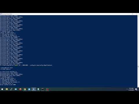

I ran docker in power shell. Did I do something wrong? Was really hoping for channels integration for tomorrow morning
You are clearly doing something wrong
Hard to tell from your obfuscated pic but i do see 404 so you did something wrong. Best advice is to redo it and follow the directions as written. There are a lot of us that got this to work by following the guide so the process does work...
So what should be set?
Can someone help?
Once you install the docker, do you go to the Docker logs and finish the login?
You ran a docker command with no environmental true/falses.
You ran the default command which doesn’t include sec+.
You didn’t bother updating the m3u in channels web ui.
Delete espn+ source out of channels dvr and then delete and recreate guide database.
Delete all your espn+ containers and data for them and start new with this command:
docker run --restart unless-stopped --name EPlusTV -p 8000:8000 -v config_dir:/app/config -e ESPN=TRUE -e ESPN2=TRUE -e ESPN3=TRUE -e ESPNU=TRUE -e SEC=TRUE -e SECPLUS=TRUE -e FOXSPORTS=TRUE -e  m0ngr31/eplustv:latest
If you deleted everything correctly you should be asked in the logs to authenticate again on the sites. Do this.
Remake your source within channels with a new name. In options choose hls and ignore channel numbers from m3u and choose a starting number that doesn’t overlap other channels. Check a channel. Done
If you run the command you did in the video it will override the previous run command and replace the container. So don’t do that if you expect to use the channels that are set to not work using the basic default command (sec+ is one).
