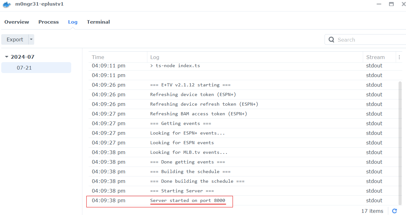

Hello, I think I have succesfully configured teh Docker container on a Synology NAS. The problem I am having is getting the Custom Channel to work it is always returning this error
"invalid source url: Get "http://192.168.73.38:9000/channels.m3u": dial tcp 192.168.73.38:9000: connect: connection refused"

Thank you. This is not specific to MLB. I cannot get the custom channel to map to PORT 9000 for the XMLT or M3U files for the guide. PORT 9000 is what is created in the container and the same free port I am using for the custom channel URL's. I am using container manager. I have also SSH'd and recreated the container. Thank you and I appreciate the reply.

What I did not notice until I went through this again setting up the container on Port 9000 does no good when the serve defaults to 8000 See the last logs attached. I totally missed it!! Thank you all for your help.

Here is how I setup the container in docker. Not sure why it asks you to specify ports then chooses one for you anyway. (8000)
Here are the logs from restarting the container.
In Docker, you have the option to map a port the container uses to a different port on your host computer. In other words, if you want to use 9000 you'd specify that as the local port, but you still need to specify the port the container is using which is 8000. Some projects give you the option to change the port the container uses, but many don't.
