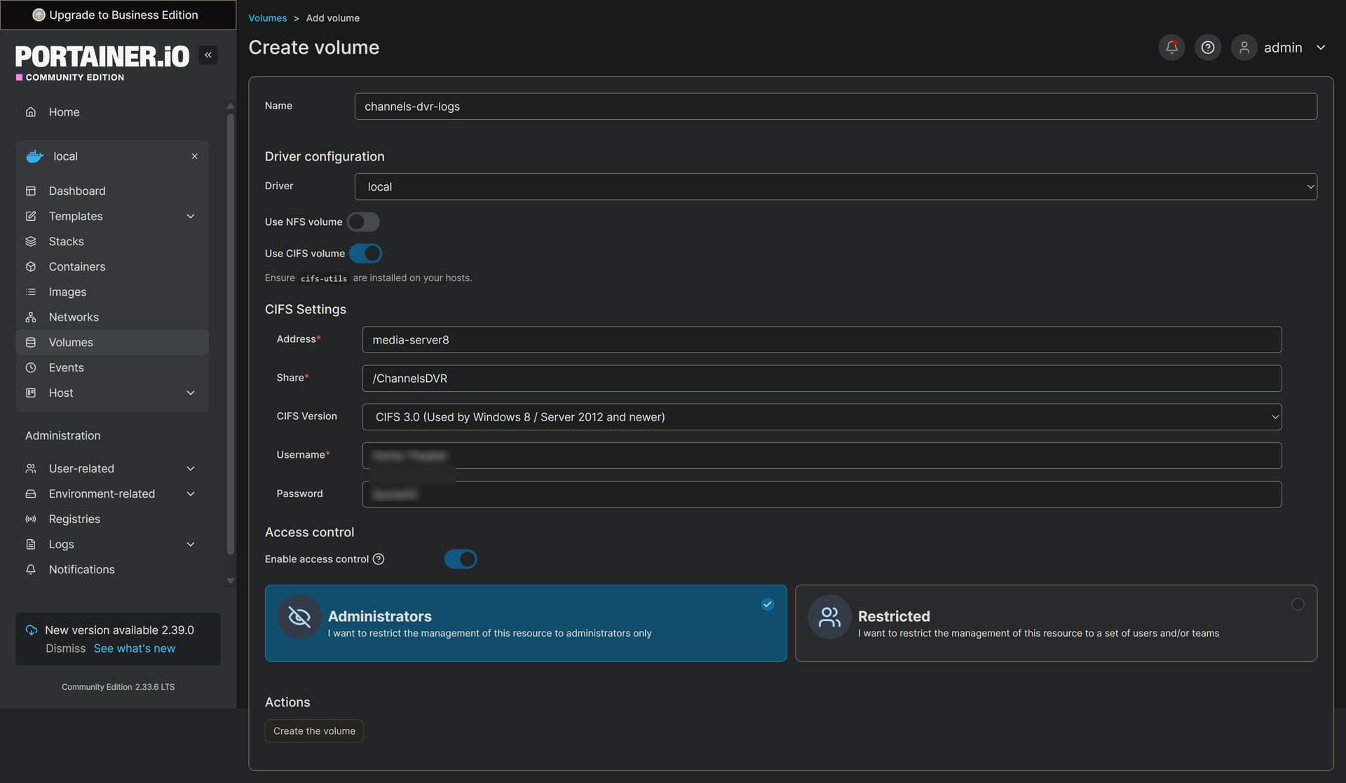

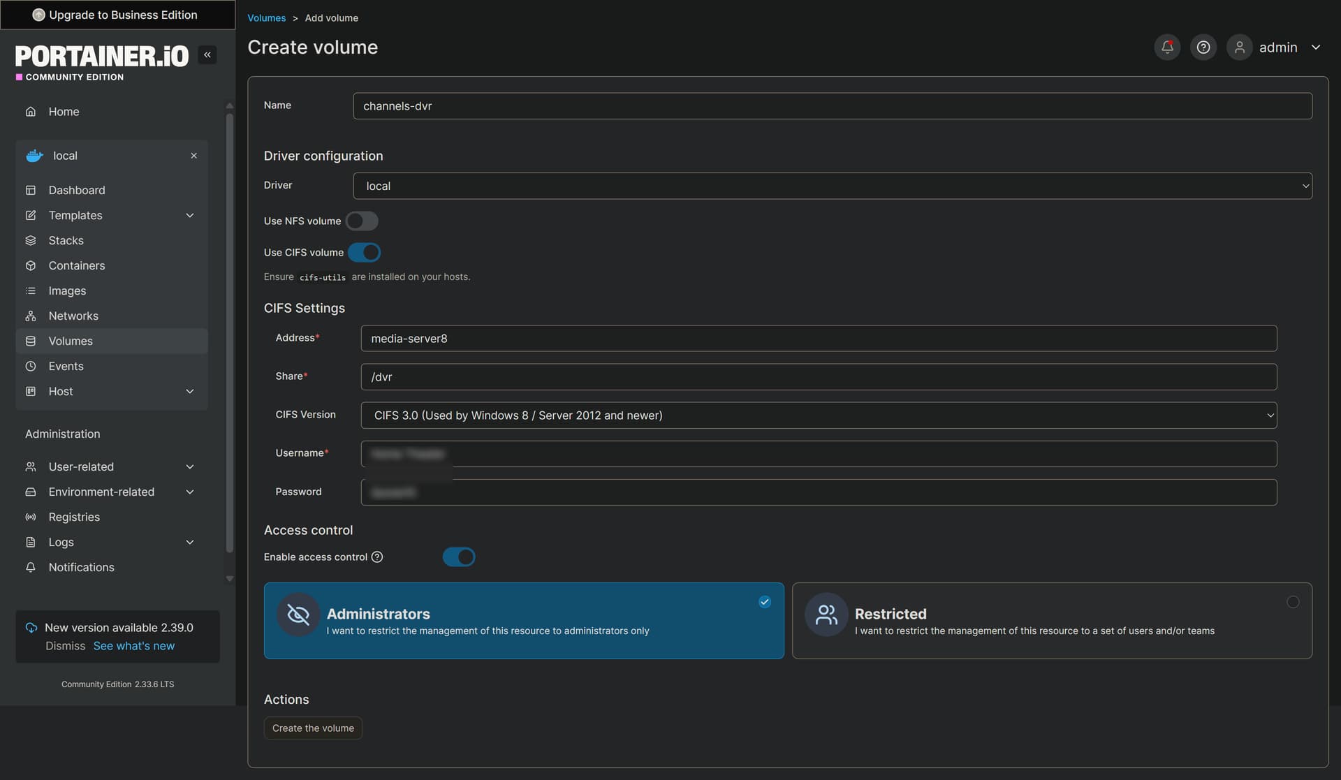

And your Docker-Volumes similar to these:
In creating the Docker Volumes, under CIFS Settings, do I create a new username and password for each volume, the same for both? Or, is this simply the username and password I use for Portainer?
Neither.
These Portainer-Volumes are referencing real, reachable SMB shares. The username and password are the ones required to access those shares (typically these would be your credentials for the PC where you made these shares available). They must already exist.
?? So, these should exist on the original device where I set up my original installations of CDVR, Portainer, and olivetin? This would be on the Synology NAS which currently hosts everything? I have no idea how to check that.
