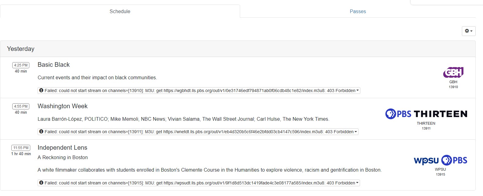

I added the PBS paths you listed, and even though 9 is not as bountiful as 200, I was pleased to immediately have the guide and channels for PBS stations in 9 other cities (screenshot). I began adding shows to my schedule, but ran into trouble. The shows appeared to be scheduled (see screenshot), but all failed to record, and shows a peculiar error message which is on another screenshot. I wonder what I may have done incorrectly. Any ideas are appreciated.
