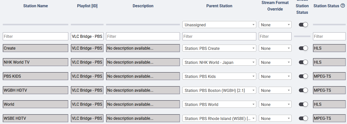

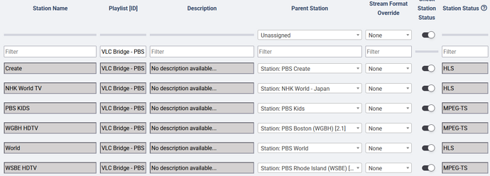

What is the screen you added to the issue ticket? Looks useful!
I meant in the base m3u. It went from...
      REMOVED: WSBE on VLC Bridge - PBS [WSBE]
      REMOVED: WGBH on VLC Bridge - PBS [WGBH]
... to ...
      ADDED: WSBE HDTV on VLC Bridge - PBS [WSBEDT]
      ADDED: WGBH HDTV on VLC Bridge - PBS [WGBHDT]
Notice the "DT" added to the end of the channel-id, which would make it new as far as Channels and PLM are concerned. So in PLM that means assigning back to a parent, and in Channels that means re-assigning to any Channel Collection.
PLM's function for getting all PBS stations uses it's own naming structure, so nothing changed there and wouldn't be a concern:
In other worlds, no work is required for that one.
That was showing the Assigned Stations screen after running Check Station Status in Playlist Manager for Channels [PLM] (a Streaming Library Manager extension).

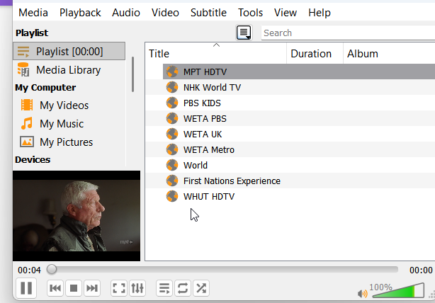

Thanks the update is great - i'm getting pbs kids now too
Though it is advertising 9 channels and i'm actually only getting 4
All the extra channels (like weta uk and nhk) are not working
Sounds like there's a new image
Yep, new image works on all channels in playlist.

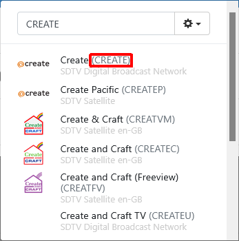

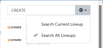

Nice Touch! Use the channel-id from the playlist m3u to override your guide data
Thanks @miibeez
#EXTINF:-1 channel-id="CREATE" tvg-logo="https://image.pbs.org/contentchannels/Create_Logo_Color.png",Create
Guide Mapping-1
Guide Mapping-2

Can you see if they are now? I have an idea to get all of these from every market, too, now that I see what's going on behind the scenes a bit.
They are now! Awesome work and the quality is great - will be higher priority than my ota ones
Yay, working here too! Did not have to change any station IDs. Thanks @miibeez!
