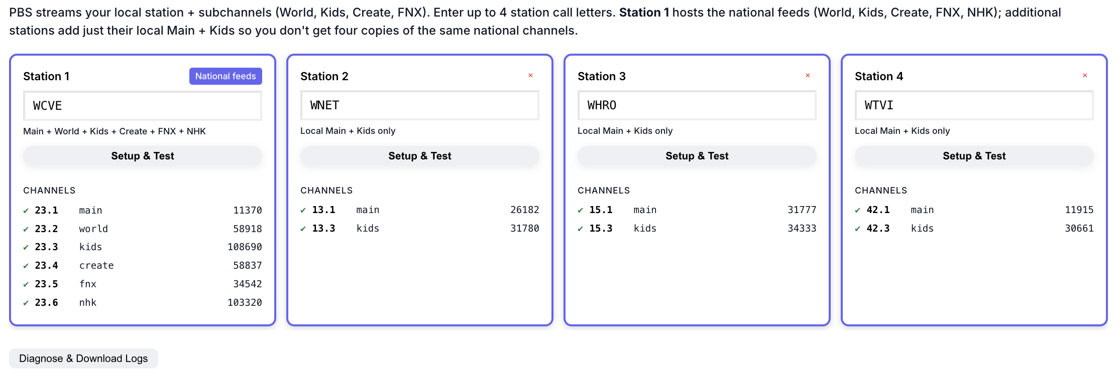

I'm working on a seperate project that also includes PBS access. The problem is PBS just changed the way they do encryption and made things more complicated by adding 6 sec bumpers to each tune that did not have encryption. So it kind of broke everything. I just finished coding a fix and seems stable now. I also added the ability to configure mutiple PBS stations if you happen to be in the middle of multiple DMA's or just like the programming from multiple stations. If you are interested PM me and I will be glad ot invite you to the project, I am definitely more responsive than the dev on the original PBS project and I've been on this forum for years so hopefully a little more trustworthy as well :slight_smile:
Also all of the channels in my m3u have gracenote id's embedded so Channels picks up the guide info easily :slight_smile:

Thanks, Seth! You have been a help to me in the past, and I'd be happy to work with you on your PBS project. I'll shoot you a PM.
Definitely interested in this. While I can get some of my local/regional PBS stations by antenna, there are others I can't. What sorts of pre-requisite knowledge / capabilities are you looking for in invitees to the project?
