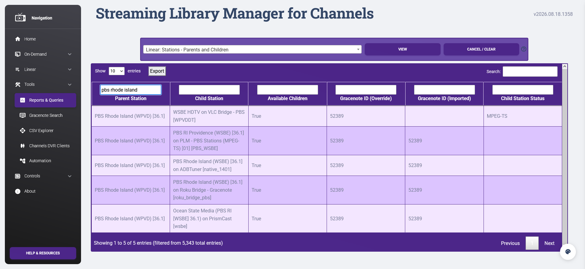

I believe in this case @Jean0987654321 is focusing on the Playlist Manager side of Streaming Library Manager, not the Stream Link/File Manager component. The linked Wiki has all the details, videos, etc... to answer your questions and then some. Like with what happened here with PBS, I didn't have to care because PLM manages several layers of backup station versions:
VLC Bridge goes down? No problem, ADBTuner kicks in. ABDTuner is busy? No problem, Roku Bridge takes over. That's not available either? Again, not an issue, PrismCast is there as the last line of defense. And actually, I'm going to be putting some FastChannel bridge stuff in that chain in the near future when that's a little more mature, so I'll have even more layers of protection against disruptions. And at this point, thanks to the fallback feed feature, I literally have a single station in Channels that represents all of these options. No more babysitting for me!
Yep if any TVE Channels gets sacrificed to the DRM Gods, then the next option takes over. The fallback feature has been a godsend for me

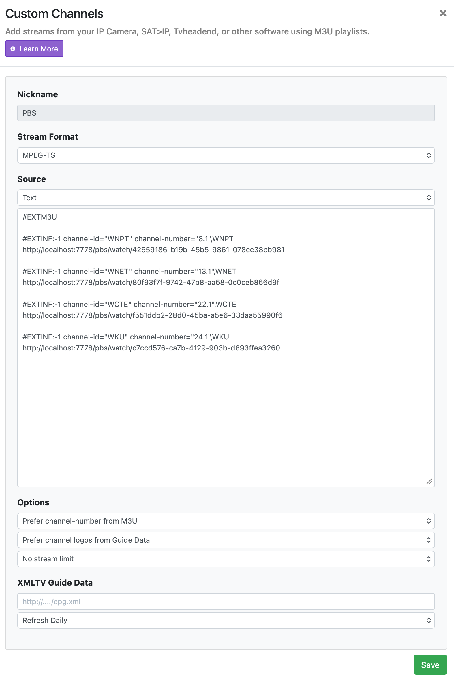

  1. Create a new "custom channel" using stream format mpeg-ts, the playlist URL you copied as the URL for the source, and your choice for the remaining options.
  2. (This is what tripped me up initially!!)
    In the setup screen for the new custom channel, click "set provider" and pick something that makes sense for your location. You will probably want something like "USA...."

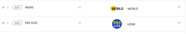

  3. In Channels, Sources, edit the lineup and match each station shown to an actual station, which you can find by searching under "all lineups." This is what will get you EPG listings for each channel. An excerpt of what you should set:

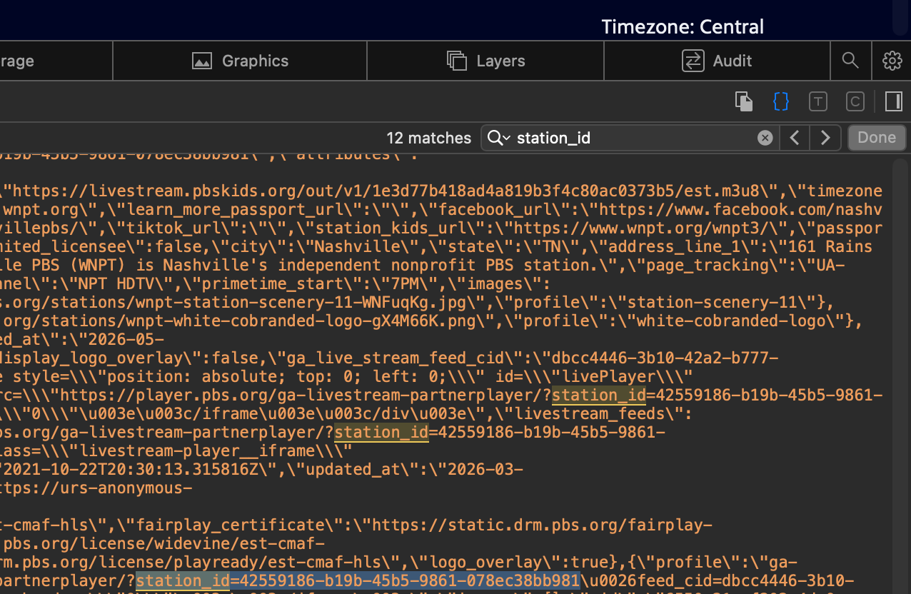

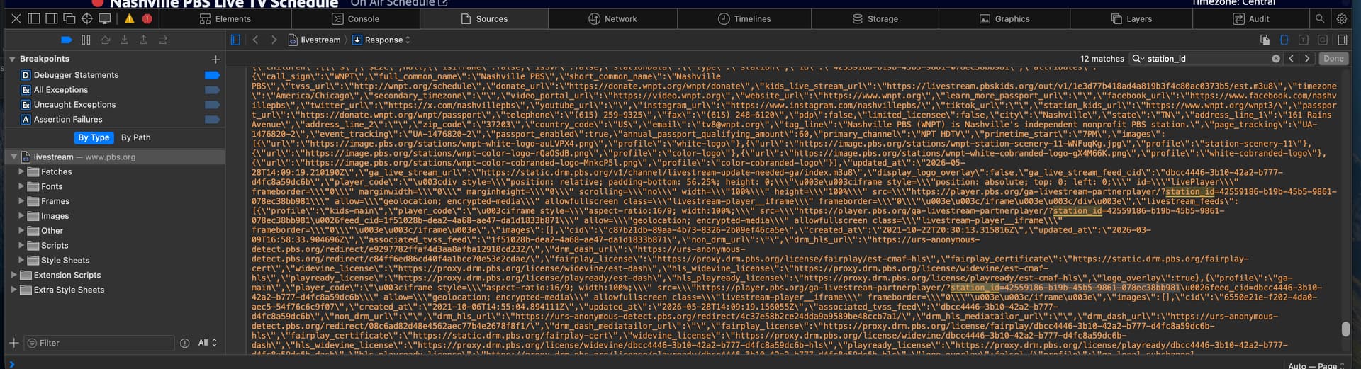

The big step to do this is to get the individual ID codes for each PBS station you want to watch.To do this you have to go to PBS.org and open a live view of a station and then you have to go into View Page Source in your browser to search for the station_ID. You have to copy that string into your settings in Channels. Its a bunch of steps but once you figure out how to find the string its pretty easy.

Or, just use the channel-id from the containers playlist.
It contains the callsign that you can use to override the epg mapping with.

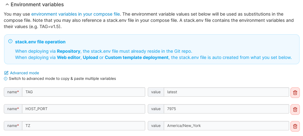

    • Should you not being using OliveTin, then there are directions on the repository for deploying the Container. Even if the directions are just terminal / command line based, that is sufficient, but not recommended. Instead, as noted above, it is suggested to use Portainer for this and all other Docker-based solutions. Here is a Stack you can use for this one in particular:
      services:
        vlc-bridge-pbs:
          image: registry.gitlab.com/miibeez/vlc-bridge-pbs:${TAG}
          container_name: vlc-bridge-pbs
          ports:
            - ${HOST_PORT}:7777
          environment:
            - TZ=${TZ}
          restart: unless-stopped
      It is up to you decide what is appropriate for your variables, most notably the port you want to access the web front-end on and what timezone you are in.
