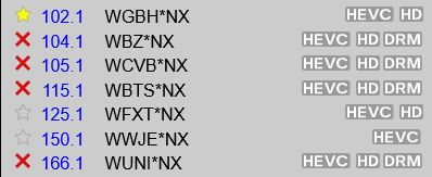

However, I can receive the SD versions of the WGBH stations that use the same tower location no problem down in Providence. More so, WGBH's ATSC 3.0 signal is certainly not DRM'd (at least not yet). I just did a rescan to confirm because you made me paranoid, but it's fine:
But anyway, I'm not defending WGBH or WSBE or all these terrible things they've done to make it more difficult to receive them, and fully agree that the Docker method was far superior and better overall. I'm going to investigate some of the suggestions above and see if I can put something together that would work for all of us here.

So I guess that PBS only uses DRM on ATSC 2.0 at the moment. I do not think this bodes well for the future of PBS on ATSC 3.0.
How is your signal quality on WGBH*NX? Does it have Closed Captions?
