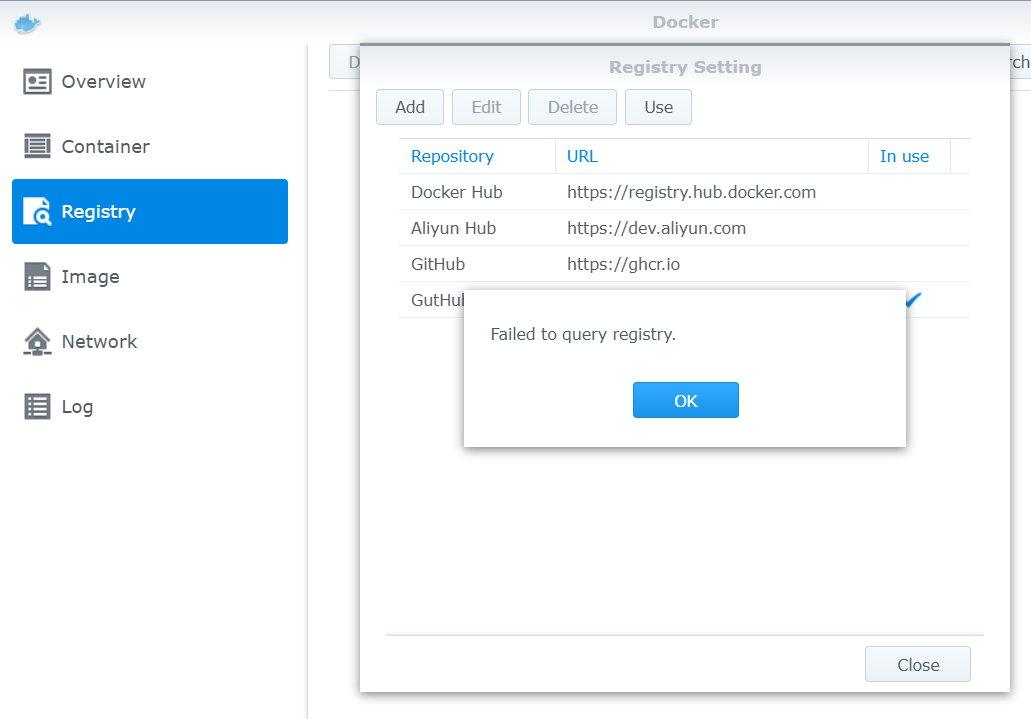

That is the problem. The Synology Docker can not connect to GitHub. I am looking for how to install it.

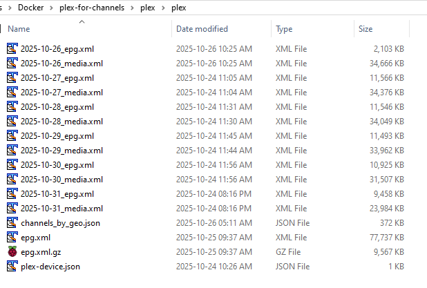

Don't you still have several days worth from the earlier calls? I've got guide data through the 31st:

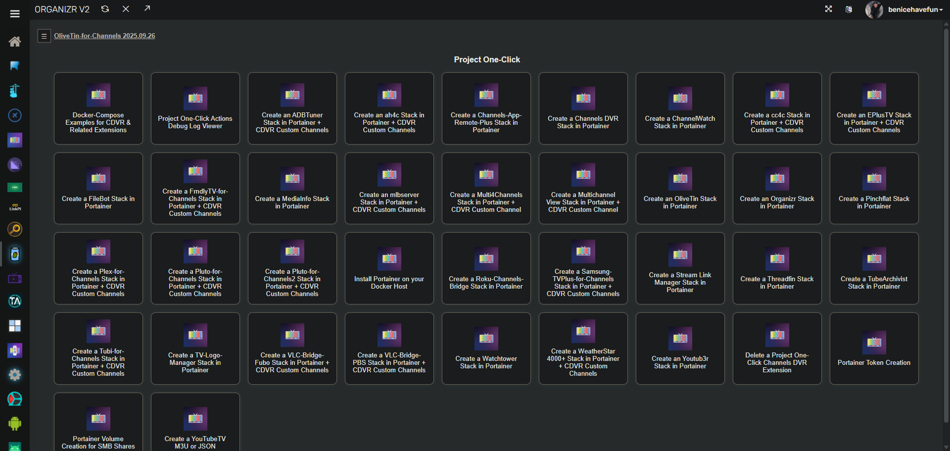

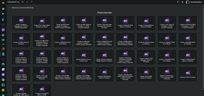

Install Portainer and OliveTin-for-Channels, and you'll have every Channels-related project a click away using Project One-Click:

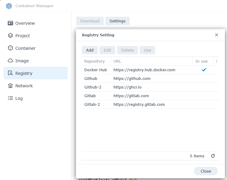

If you're using Synology Container Manager, read the built in help for
Container Manager > Registry (That would be the question mark at the upper right)
You can Add registries in Container Manager > Registry > Settings

That is what I tried to do. It gets an error searching GitHub.
I have those daily files, but Channels DVR pulls from the merged epg.xml, which isn't getting updated in my case.

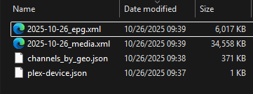

I stopped the container, deleted every file in /app/data and restarted the container.

Screenshot 2025-10-26 094433

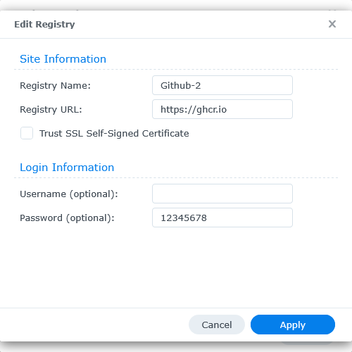

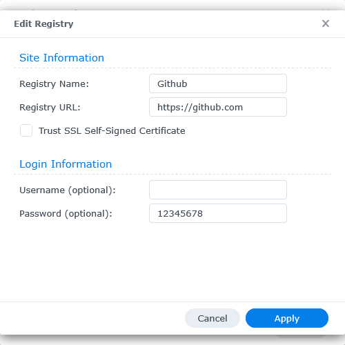

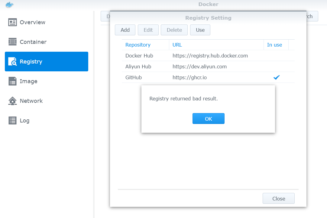

Did you add https://ghcr.io
Screenshot 2025-10-26 at 09-35-20 DS1019PLUS - Synology DiskStation
Screenshot 2025-10-26 at 09-34-23 DS1019PLUS - Synology DiskStation
I used https://github.com and also added my username and pswd to both entries. This is what I get with https://github.com

I had Perplexity give me step by step directions on how to pull plex-for-channels from GitHub using TELNET. It worked. Now to get it operational. :slightly_smiling_face:
