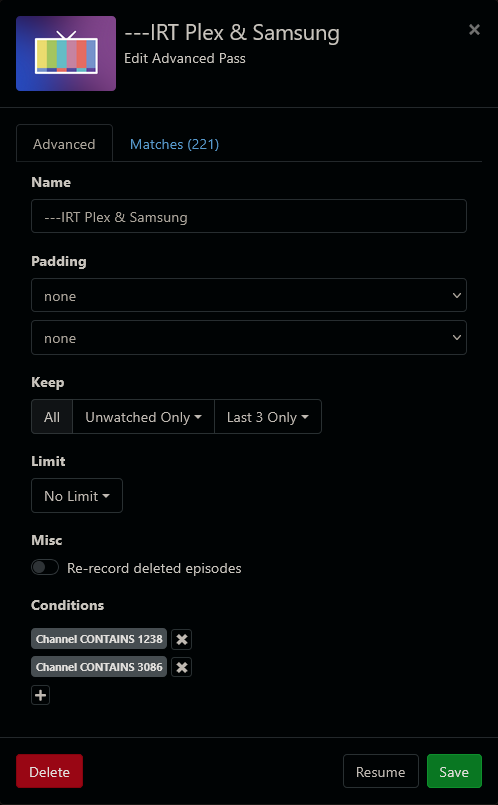

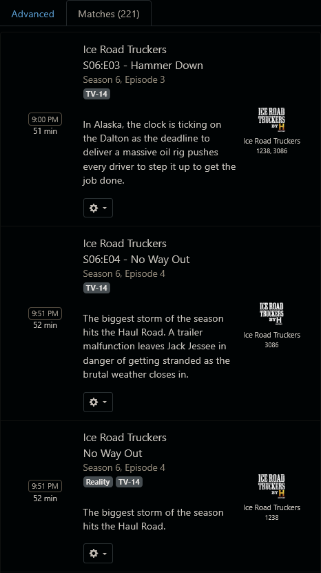

Seems some Plex Channels not have proper Guide data for a bit now.
Ice Road Truckers channel, i have noticed several times lately just says "Ice Road Truckers()"
At the moment, the guide data is mirroring the same channel I have on Samsung TV, with a tiny offeset.
However, even though both channels have the same name, and are presented by "History Channel" they do air different episodes. So not sure why the guide data is in fact wrong for the Plex source.
I do look at the actual Plex Live TV website via web browser, and , at times, it has no guide data for that channel, just had the show title, no episode name, one time it has just the current date/time in each slot, right now, is has full data, but it is the same as Samsung Tv guide data, but it is not the correct episode, i think. One of the channels is wrong, cause they for sure are 2 very different episodes.
I'm using only the Plex EPG and although that channels loads 7 days of guide data, only the next 24 hrs have Episode Titles and Season, Episode numbers.
The rest are generically Titled Ice Road Truckers () with the Episode Title equal to the airing date.
On my setup, I've noticed I only get a complete guide refresh (7 days EPG) each evening around 6pm, even though CDVR is refreshing it hourly.
ch1238 PLEX, ch3086 SAMSUNG
