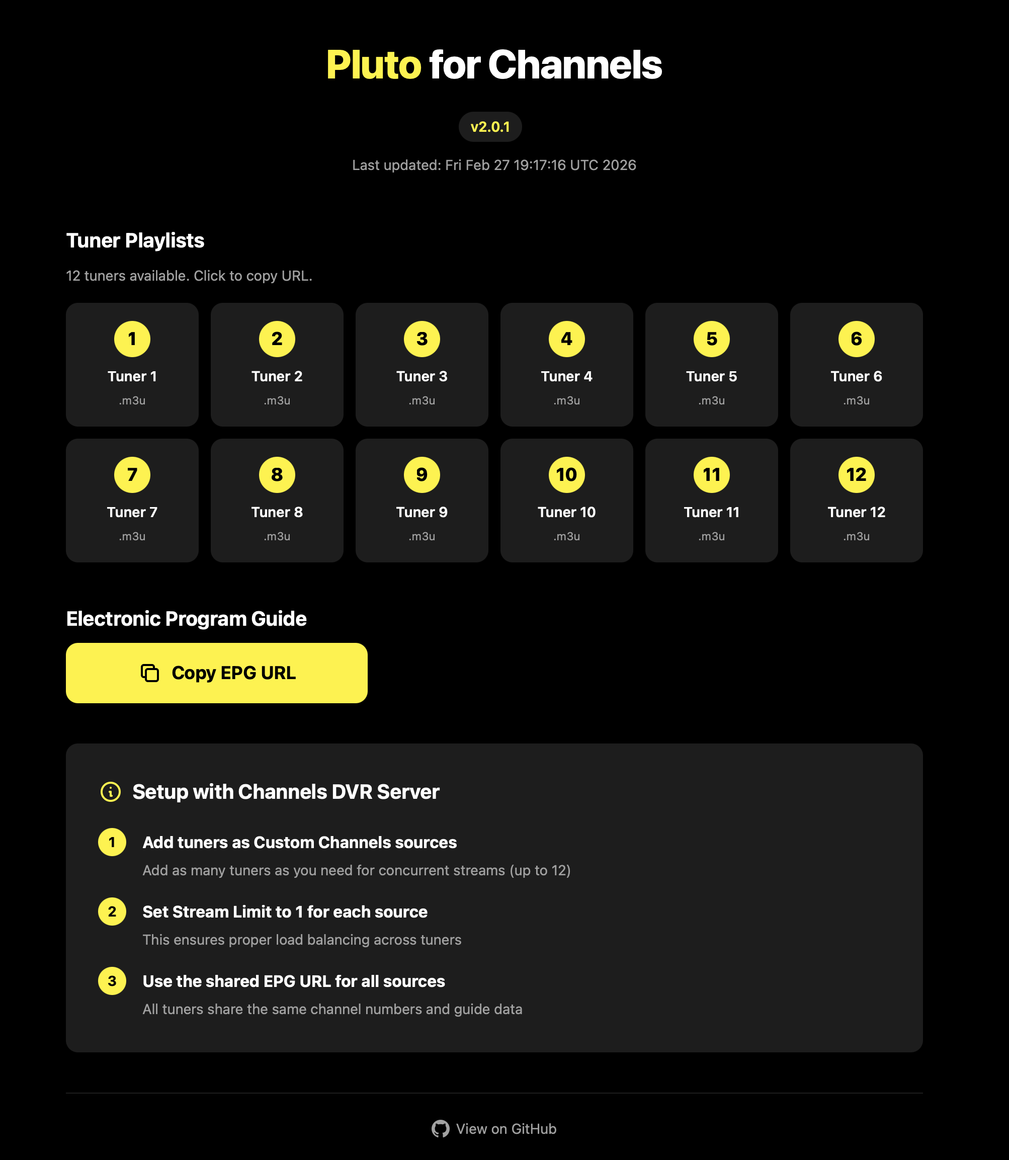

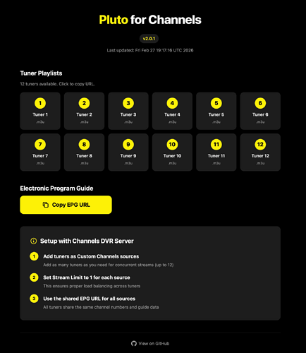

Pluto for Channels 2.0 is available, just pull for the new docker image. It now supports up to 12 tuners. Visit the web page to pull the tuner URLs.
Copying the link with a click is broken as it only works with https. Iโ€™ll get it fixed soon.
