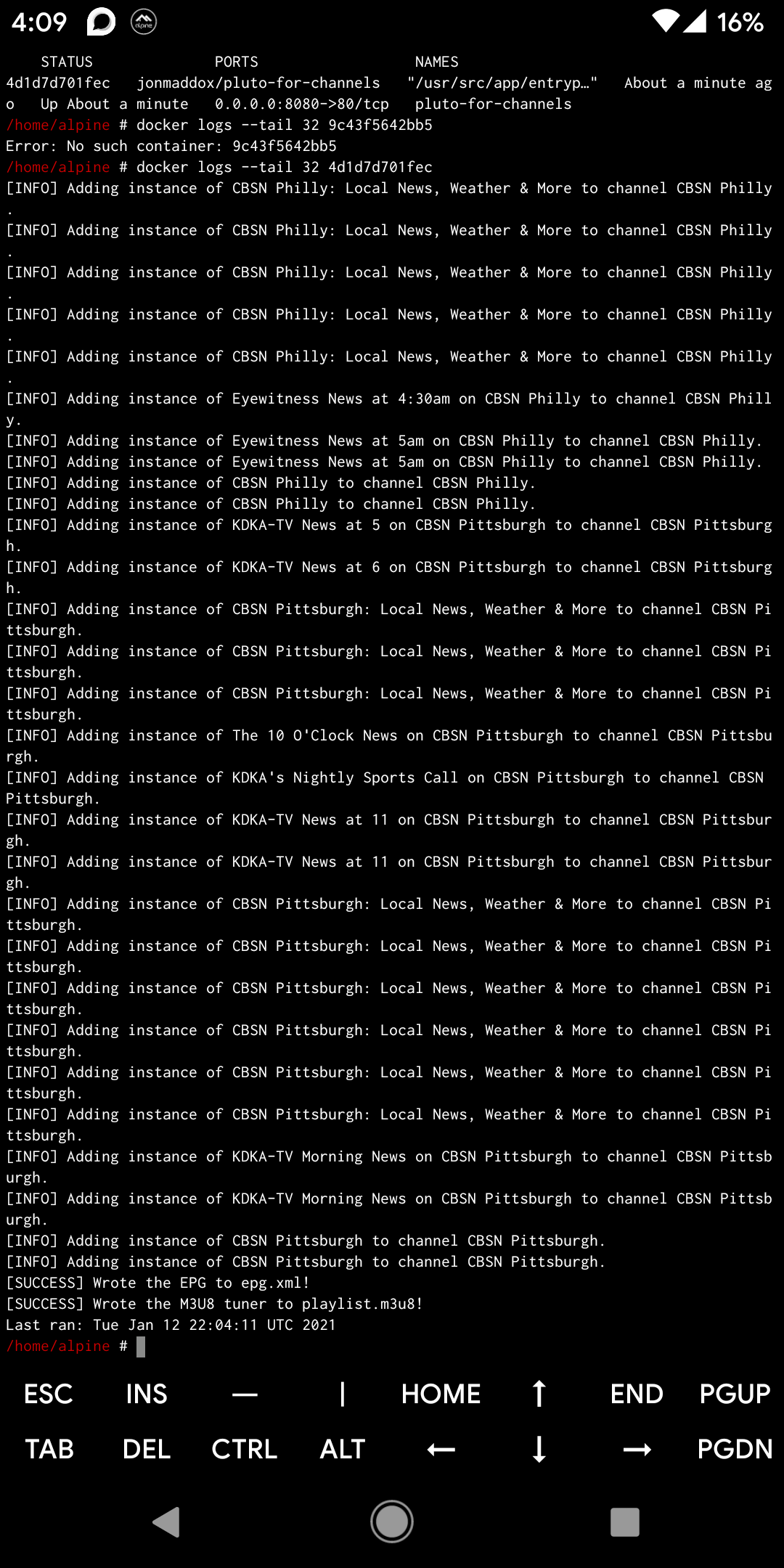

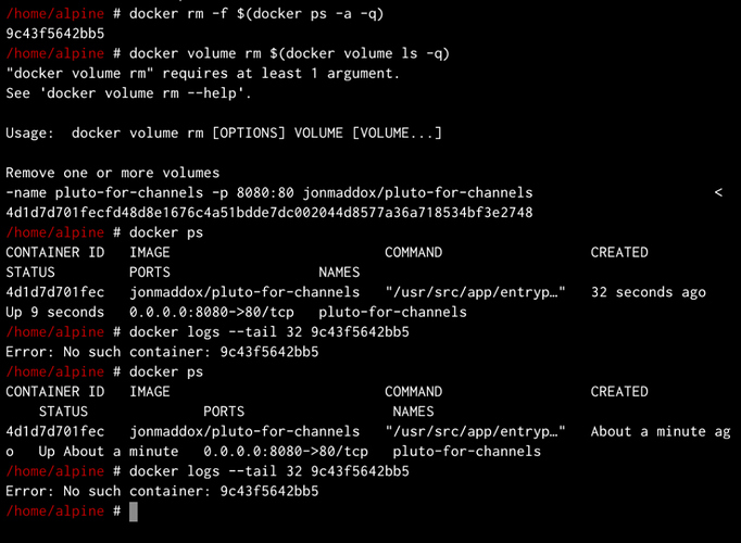

Right, but I've switched to my phone to work on it, so, yea, that's not a terminal into my Shield, I'm running it on my phone now.
What does
docker logs --tail 32 9c43f5642bb5
show?
Considering you're running Docker in a limited chroot on a modified Linux kernel without a proper full userland and an opaque network configuration, I doubt you're going to have much success.
If this is your only purpose, then you're better of with a Pi Zero-W or similar host your container. (Or, since it'd be a single purpose device, just run it natively via Node.js and ditch the massive overhead that Docker adds to the situation.)
It shows no such container
I also had to remove the container for it to run again after restarting.
True on all that, I just like to tinker with stuff, or no reason why it couldn't ask be done on the shield, and here it is running, just not working. I don't even watch the PlutoTV channels, I'm just playing with my toys right now.
Your Container ID changed. Try
docker logs --tail 32 pluto-for-channels
I saw that and changed it to the correct one:
Looks like it works. Just can't get anything to come up. I'll keep playing with it I guess.
Networking with docker is always a hassle, so not surprising Android OS is not setup correctly for it.
Guess it was worth a shot.
