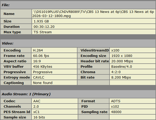

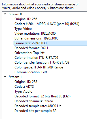

There's something unusual with the PTS and video framerate.
Here is that recording in VLC showing as 29.97 fps
VLC
and in my video editor showing average 60.06 fps
(it thinks it's VFR Variable Frame Rate instead of CFR Constant Frame Rate)
VRD

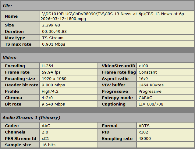

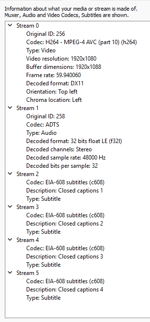

For comparison, here's the TVE recording
VRD TVE
