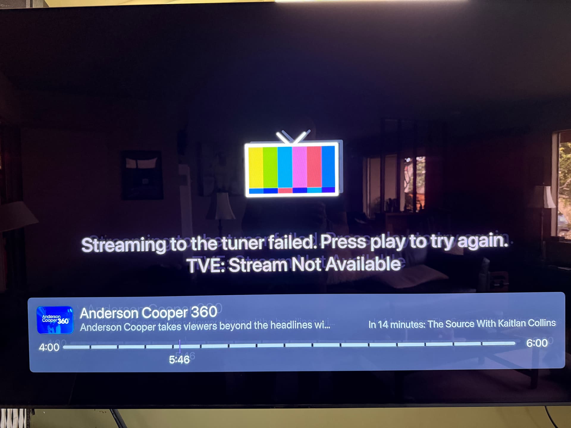

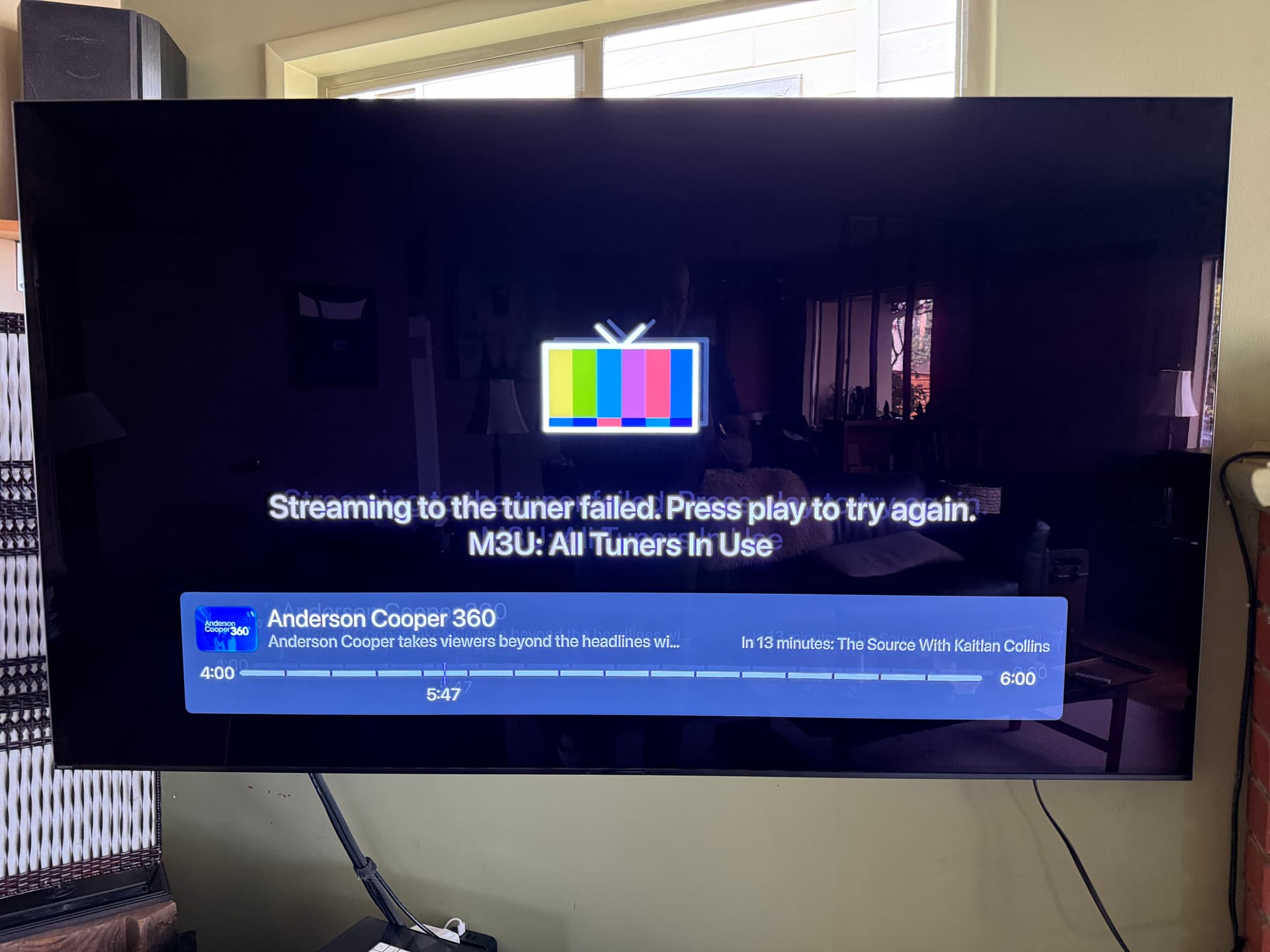

It's very inconsistent. When I try to access channels in the 9000 range (I think these are the "new" channels being listed in the "new" guide, I get either of these two screens>>
Why I still see the TVE message is beyond me. Also, I have the spiffy Silicon Dust tuner with 4 tuners, and nothing is recording currently.

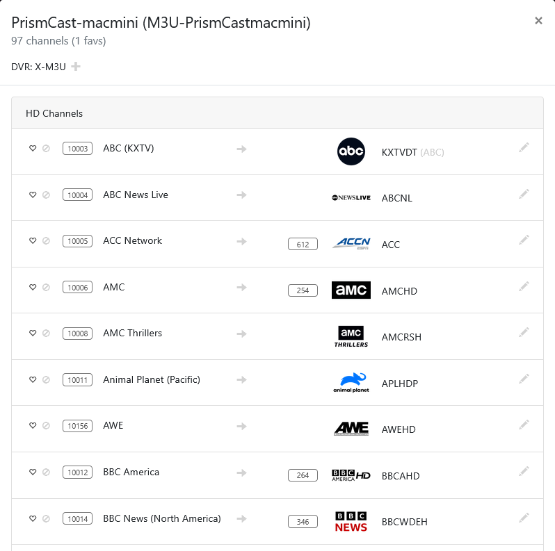

Look at your sources in the DVR web UI and click on the source you added PrismCast to, to see the channel numbers.
Screenshot 2026-07-31 at 17-57-51 Channels Settings
